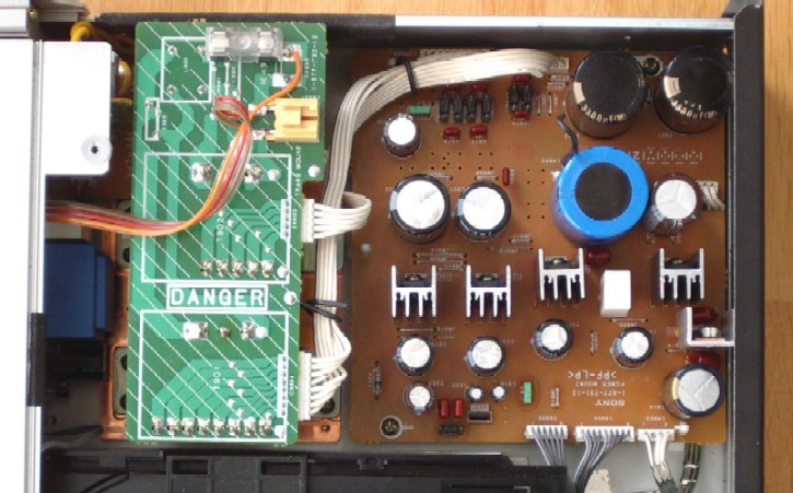

What I felt about the ground layout and the ground distribution among the differents pcboards was right, so as it appears to me impossible to optimize the whole player on this point, It will take so much time to tune the ground distribution, listen, mod, listen, measure etc… taking off each time the pcboard modify it, re_putting it on the player, you see…
So, unless remaking all the pcboards, the solution, which not only solves the problem but moreover constitutes a very clear improvement, is to go to a floating mode at the output of the VC24+.
I tried this today and wow!!! The improvement is in the same order of magnitude than bypassing the current pulse converters. For those who have done it, they know what I mean.
I will post later the modifications to carry out on the output stage and power supply.
To test this mod I used the analog power supply trafo for the clock (like Sony did, but with my "reg" circuit:TL431/Mosfet).
To avoid common ground with the player, the easiest solution to test this mod was to re_use batteries, I don’t think the improvement is due to them, taking into account the tests carried out before, on the power supplies (no difference between them).
If I want to use the Sony analog trafo for the ouput stage, I must use the digital trafo (DAC supply) for the clock too, so ??? Maybe with a good supply circuit, it will be o.k. I’ll test this, tomorrow I hope.
If the results are not good, I will go for another trafo just for the clock.

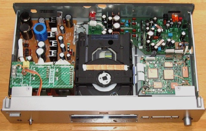

Tested this last days:
- Digital trafo for DAC and Clock. One reg per “function” (no difference with a complete separate supply just for the clock! Even with batteries//capacitor, curious ???
- Analog power supply trafo for output stage (with no common ground with the player).
Always as good as on my last post, and same quality, with my power supply, but now that I have increased the “resolution” by just using common mode, I can hear a very little difference on batteries vs. my reg power supply on the analog output stage, it’s a little better (more involved, more on the stage with the musicians), with batteries. I will try to improve that the next days…

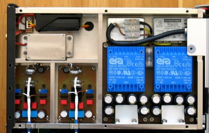

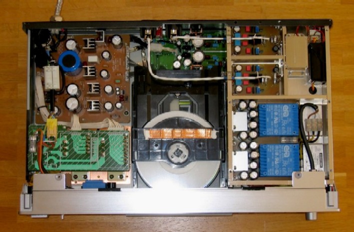

One year on, it is finally finished. Thanks to Richard for his insirations and motivations.
Sounds great to my ears (reference Meridian 508-24). No plans for further changes, at least for some time.
Great value for money at less than 500 Euros, including a second hand player from Ebay.
Patrick
Patrick
The Perez buffer at 9mA bias, with a different filter (3rd order 100kHz passive). Dual mono, separate PSU's (current sourced discrete shunt regulators, +/- 15V). Balanced output.
Clock is Tent (gift from Richard with sincere thanks, otherwise no other reason), 8.4V NiMH battery powered with a separate current sourced shunt regulator in between. House in separate nickel plated aluminium housing (top left hand side).
Signal cables from DAC teflon twinax 75 ohm shielded, from clock 50 ohm telfon coax.

PSU of Perez buffer
Hello Patrick,
In post 37 you write:
Would you mind sharing the schematic of the current sourced discrete shunt regulators, +/- 15V?
Best regards, Arjen
you can mail me off list when you prefer:
vrhff04_at_xs4all.nl
NB. please replace _at_ by @
Hello Patrick,
Best regards, Arjen
Someone posted this a while ago, a link to sony schematics:
" Post #26
I believe someone asked about the service manual in pdf form. Download it from Sony here (7.00 MB PDF). As with all Sony service manuals, it includes block diagrams, schematics, parts lists, disassembly instructions, signal waveforms, etc."
I am trying the link, but it asks for login, etc and won't let me access anything. Really like to get ahold of some sony manuals, anyone help me out?
" Post #26
