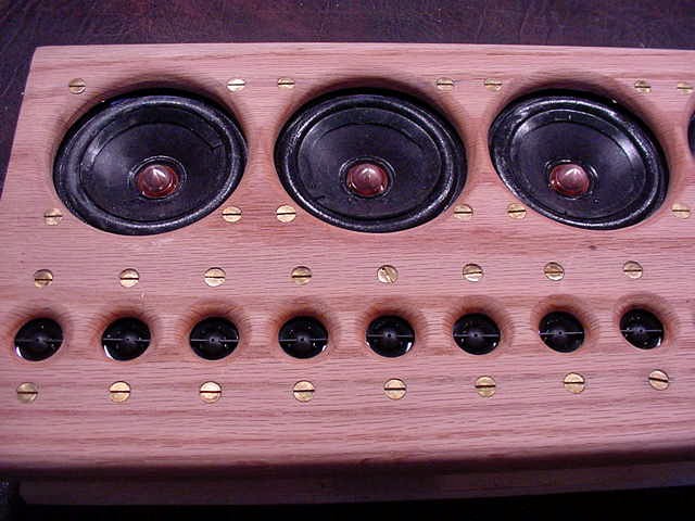

On the mounting of the tweeters, it looks like they are a bit 'inside' as they are on the backside of the oak - will you have some difraction effects, or will the routed hole act as a very very small horn?

jgwinner said:or will the routed hole act as a very very small horn?
On the ones we are using we mount them from behind with a conical waveguide. Helps them go down a bit further and match the dispersion of the midbasses closer at the XO.

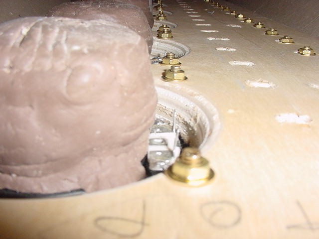

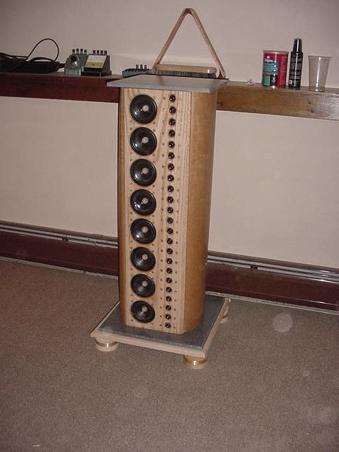

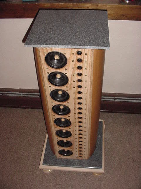

I took Variac's advice and thinned the baffle edges as much as possible without a shaper. Thanks Dave!
The top still needs to be shaped and installed, the phase plugs need to be put in, the base needs to be asembled, and all the adjustments still need to be done.
I took Jim Griffin's advice and rounded over the inner baffle.

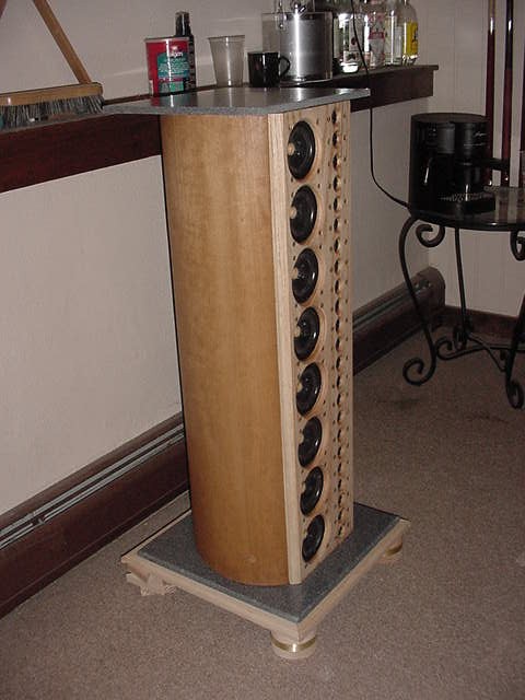

Not yet, my Thor's still look pretty rude. I've been out of town, but I should be able to post something in a couple of weeks.
I'm also putting off attaching the bottom of the speakers; I want a solid seal (glue) but keep thinking I'll need to fiddle with the stuffing (screws and gasket). I can get to it through the speaker cut outs though so I'm just going to glue.

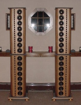

WOW!
