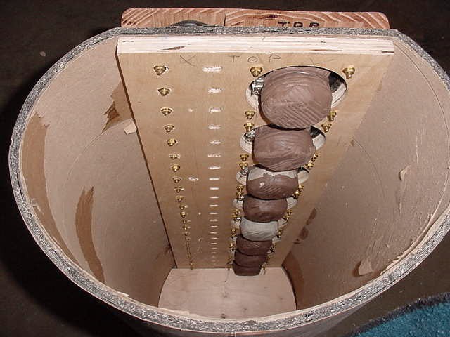

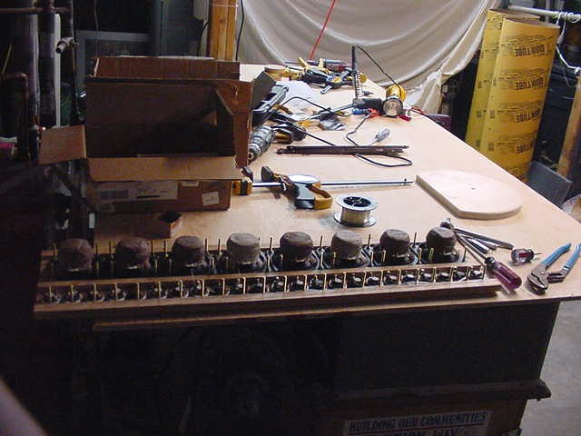

Those are looking good. I just put some of those budget ApexJr into some BD-Pipes, they seem to work decently (i'm XOing at 10k thou).
And i recommend everyone have a close look at the use of mor-tite (looks a lot like Duct-seal) on the baskets and magnets (i usually don't load up the back of the magnet like you did) -- this can be a hugely effective mod -- even on big-buck speakers.

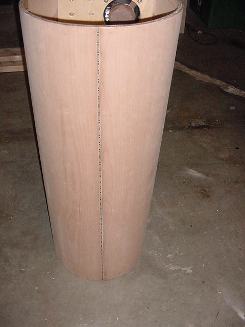

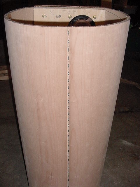

Hey.
guys- look at his "crushed tube" construction.This had crossed my mind, but I was afraid the tube would either be too difficult to crush, or would crease unevenly. This proves the concept I would Say!!!.
Again proving the "Makers" on this site are infinitely more vsaluable to this site the the "airmchair theoretitions"
He now has an enclosure that is flat on the front for easy driver mounting, but close to the egg shape that seems ideal for boxes:
rigid, least standing waves, pretty easy to make, withstands pressuration and resonance well, not necessarily too heavy. smooth baffle step transition and large radius corners for maybe better imaging (I think the front baffle should be tapered to very thin on the edges to make this last true) Of course this would work for conventional 2 or 3 ways also.

Just a couple of questions and a request:
How did you manipulate the sonotube into shape?
Does the “see through view from above” drawing accurately represent it’s actual shape?
And if the drawing does not accurately represent it’s shape, would you post a photo looking straight down into the tube from above?

Tom,
I was pointing at a sonotube i had to a construstioneer friend, and the 1st thing he said was if i cut it lengthwise it would naturally unravel (as they are designed to for removing once the concrete is dry.
Did you have any problems with this or take any special measures?
dave
dave

I never cut the tubes lengthwise so I can't help with that.

tom1356 said:I never cut the tubes lengthwise so I can't help with that.
Went back and looked closer -- i see the sandwich now.
dave

One thing to keep in mind with the Cubicon tubes is that they may have a raw end. I don't know if this is true of all them or just mine, but I suspect it's all. For some odd reason, they decided to put the end on one side of the 'front' panel of my D-tube, instead of the back. It's a pretty ugly edge if you were not planning to wrap the tube in cloth like I did or wrap it in veneer. It's possible that the edge could be smoothed out enough so that a simple painting would do, but sanding on cardboard seems weird. It does work though, I sanded the top and bottoms of mine. If you thought MDF soaked up water though... don't get the Cubicon tubes wet!
Edit: By end I mean like a seam, except this isn't a seam it's just the edge of the 8 or 9 layers of cardboard that are wrapped together to make the shape. It runs the entire length of the tube, as you'd expect.

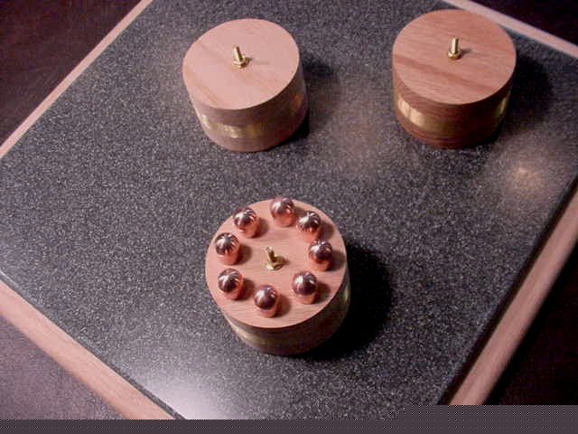

tom1356 said:Phase plugs
Is there any feasibility in making these for resale?
dave
