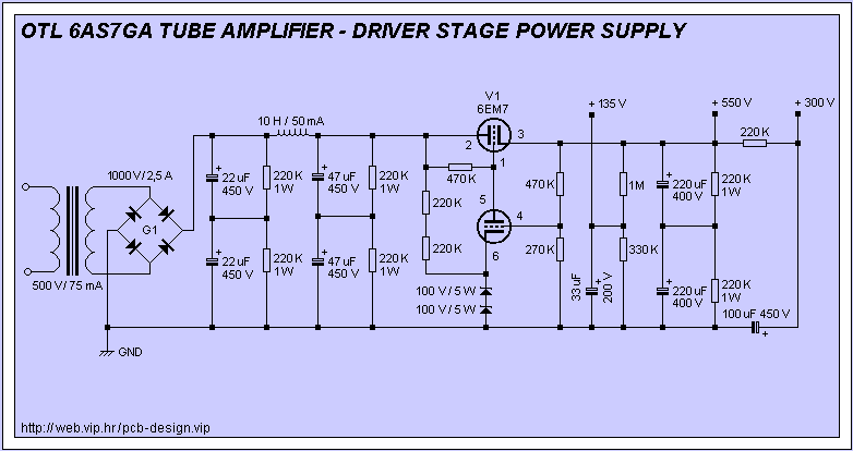

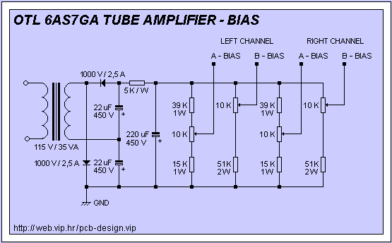

Hello,
... and here is redrawed driver stage power supply, and bias
circuit diagram of the 6AS7GA OTL amplifier that is posted earlier.

David and Scott,
Hey Frank, if you used the 8 or 10 tubes suggested by Scott
At the risk of repeating myself:with OTL amps you always face the dilemma of low Zo and power output.
So,yes you could add a few tubes to that circuit,actually 4 of them in a series // configuration + NFB should bring the Zo down to usable levels.
You should discard the zobel network at the output as well since most modern speakers have one build in the x-over or don't need any.
I am not sure that circuit uses 4 // 6080s or 2.
The circuit does not show that clearly.
Keep in mind that the low mu triodes present a rather high input capacitance which is //ed by adding more tubes.
It will require a decent driver stage.
But using the 6336A is not cheap unless you're already sitting on a huge pile of them.
In the long run the 6AS7G/6080 is a better choice.
Other candidates are the EL509/6KG6 and the monster 6C33C.
Cheers,😉
OTL
I will build it as monoblocks.
Fine.
I actually used 8 output tubes per channel on a friends' amp.
It is easy enough to do as long as you keep in mind that your powerxformers needs to be up to it.
Also I //ed the second 6SN7 on each block.
I set bias for 80 mA but it is not critical for sonic results IME.
The best way to avoid problems is to match the output tubes before you stick them in the amp.
Especially discard any tube with widely varying halves.
Cheers,😉
