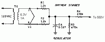

Hello,
I am also interested in building OTL with 6AS7GA Valves.
Does someone have copy of the original article about this OTL
from the Glass Audio 1990, or know where it could be found ?
Here is 6AS7GA OTL amplifier schematic.
I redraw it, so it can fit the screen and on
single piece of A4 paper when printing.
I will also redraw power supplies the same way, and post
them latter here and on the my website.
Best regards,
Kristijan Kljucaric
http://web.vip.hr/pcb-design

YES,YES AND YES.
What is it you want?
I know that circuit like the back of my hand...so?
Cheers,😉
Cheers,😉
OTL
Actually what you do is connecting the B+ of 550VDC to the heaters through a couple of resistors..
By doing so they run at a higher potential with respect to ground.
I replaced the zener diodes in the regulators with a pair of glowdischarge tubes .(OA2 I think)
So,yes pin 3 it is.
I can't seem to find the original article any more,it was explained in there.
All I remember is that the amp had a rotary switch and an ampmeter to verify biasing.
It sholudn't be a problem provided the output tubes are reasonably closely matched.
The current you let flow the more you bias the tubes to class A.

Also the 'To 550' should be connect to the 6EM7 cathode (pin 3) ?
So,yes pin 3 it is.
