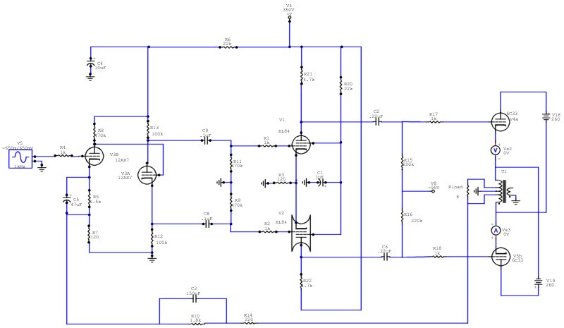

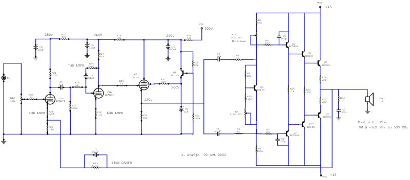

Hi
I'm a tubes entusiastic person.
Built OPTs is not a big problem to me.
However I've never built any OPT with 500KHz bandwith. I think anyone was capable of doing it either!
Because of that I've tried hybrid topology. Forgive me the other tube entusiasts! Anyway this seems to play rather well.
Please let me know your opinion about it.
Regards
Regards
OTL
Are you aware how much your circuit actually resembles that of most OTL PP amps?
Why would you need an OPT with a bandwidth beyond say 100KHz anyway?
And I seriously doubt the hybrid one has such wide bandwidth.
Not that it matters to me anyway.
There are IMO other more important factors than just bandwith to a design,wouldn't you agree?
Nice work BTW.🙂
Nice work BTW.🙂
Re: OTL
Yes, is true taht thi circuit is similar to OTL. But I dont know any valve with 4-5 Amps max current. And BJTs are capable of manage that current. The output stage is almost transparence. And has a current super gain (aprox 500000). Due large intput impedance.
SACDs have a large BW (96 Khz). And this is why I'm looking for a large BW tube amp.
Of course, the large BW of my design is obtaind with 14dB of NFB. In open loop I Have only 46 Khz @ -1 dB.
The problem with my other OPTs on tube amps is the phase shift, that not allows a large amount of OANFB.
This was the main reason to try this topology.
May be. it is possible, make an OTL topology with a OPT.
You may think I'm crazy!
But, my theory is, a OPT auto-transfomer have less leakage indutance end less shunt capacitace, due less phase shift.
I've not tried yet!
Please see the preliminary schem.
Regards🙄
I've not tried yet!
Regards🙄
OTL
Hello,
Seems we now have a high speed designer.😉
Looks good to me.
Apparently you already know what tubes can deliver high amounts of current.
Having low output impendance at the outputstage allows for better bandwidth of the OPT and makes it easier to design so we have a win-win situation.
Although I can not come up with any big brandnames right now I suppose some product like this must already be on the market.
Shouldn't stop you from trying though.
It makes me wonder which of the two designs would be preferred on listening tests.
Interesting.
Hello,
Looks good to me.
Interesting.
