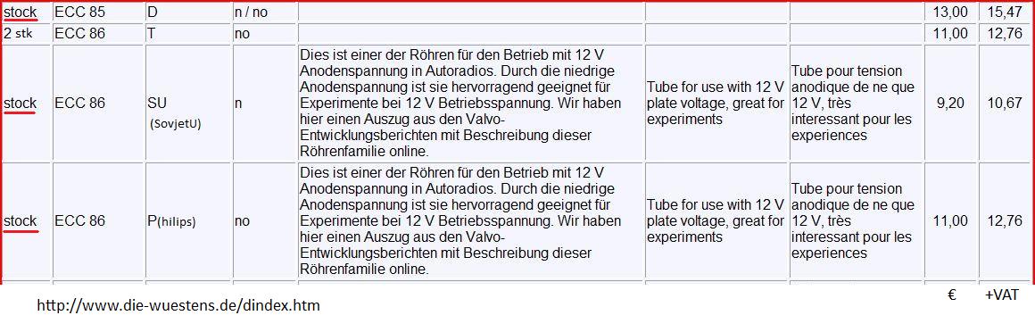

@Ketje: Wouldn't it be nice if you could swap out both ECC85 (even though EH still has it on offer) and the much harder to come by ECC86 with Russian 6N1-Ps?
I know the an ECC88 can run at such low B+ without any trouble at all.

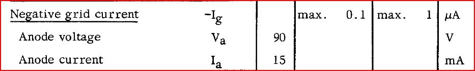

@Ketje: According to my old Philips databooks (you know, the "Gouden Gids sized ones) the ECC88 should not produce any grid current even when approaching Vg0 even at 2mA currents. IME it indeed does not.

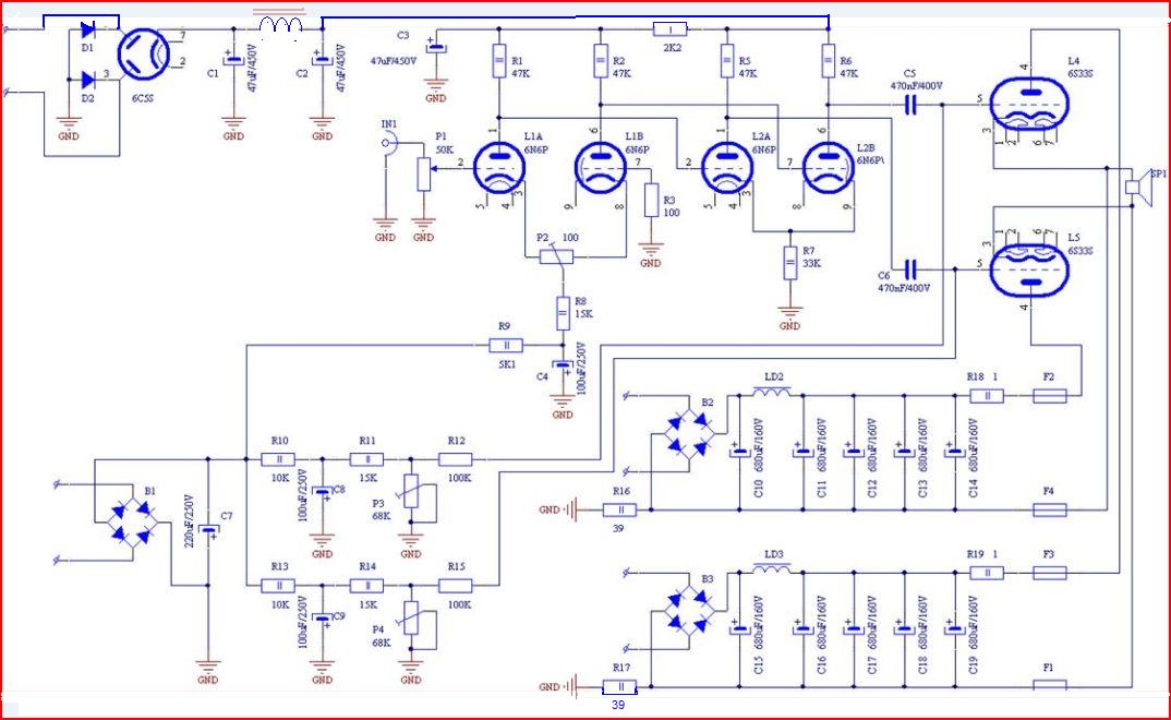

Since I already have 109db horns 12ohm speakers I figured this would be a good opportunity to ask about tube OTL's. Never had the chance to try one. Any suitable, low cost circuit I should consider building so I'm not buying fancy stuff out of curiosity?
I think a good sounding design with 5-10watts would be a good start?

This one from Russia or China, don't remember where I found it, looks promessing.Since I already have 109db horns 12ohm speakers I figured this would be a good opportunity to ask about tube OTL's. Never had the chance to try one. Any suitable, low cost circuit I should consider building so I'm not buying fancy stuff out of curiosity?

In the ECC88 data they messed up somewhat, better use the E88CC data.@Ketje: According to my old Philips databooks (you know, the "Gouden Gids sized ones) the ECC88 should not produce any grid current even when approaching Vg0 even at 2mA currents. IME it indeed does not.
Cheers, 😉
A 90V 15mA the Vg is round -1V an allreay some grid current 😱

Ah- the low power OTL, a holy grail of sorts. One thing you will find is that OTLs make less higher ordered harmonics, so you actually wind up using the power they have as opposed to a SET. Because they don't make as much distortion, they don't sound as loud so you turn the volume up higher. That's a good thing BTW. The M-60 circuit I put up earlier can be executed with 2 or 4 power tubes- you don't have to use all 8 by any means! At home, because I don't like air conditioning, this year I have been running my M-60s with only 4 power tubes per channel; my speakers are 98 db and 16 ohms and I've really not noticed the loss in power. Haven't had to run the air all year too 🙂

We used to make a circuit like that which we discontinued in 1985. The problem with this driver was discussed earlier on this thread, to wit: even with hand-picked tubes, the circuit needs an AC balance means. The best place to put that is in the cathode of the first tube (balance potentiometer). It turns out though that this is poor means of balancing the circuit- it introduces as many problems as it solves. At best, the circuit does not come close to the cascode voltage amplifier we use, which is why we use the latter 😀 Take it from one who has experience with this- avoid that direct-coupled cascade. Looks good on paper but its doesn't work!
