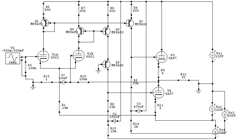

Sure.
Here is a version...I like the possibilities current mirrors give, and to me the pros outweigh the cons. (No capacitor, wideband response, gain and bias (of the output tubes) in one, load resistors placed at any voltage level, etc)
For simplicity only a single 6AS7 is shown, and for simulations the load is 32ohms. 4 tubes in parallel is fine for 8ohms.
Many think the cathode resistance in the output is too high, but I've tested and believe it both sounds better, and provides better harmony between the parallel tubes.
The mirrors can be modded in all kinds of ways, cascoded, wilson style, base drive with another pnp's emitter to the mirror bases, etc etc.
The load/gain resistors can be varied without any change in distortion, just gain. U can experiment with various values for max symmetry, but I cannot hear distortion if it is slightly off, since it's all benighn second order.
The bias is adjusted with a potentiometer in series with the LTP tail resistor.
Btw, do u know why a CCS in the tail of the PI is actually worse in this circuit?:p
Cathode followers driving the output helps increase power, obviously, but I prefer the sound of the lesser powered CF-less version.
I don't use NFB, R13 is not there, but if u like, R13 can be up to 2kohms...actually, u decide, it can be any value...
