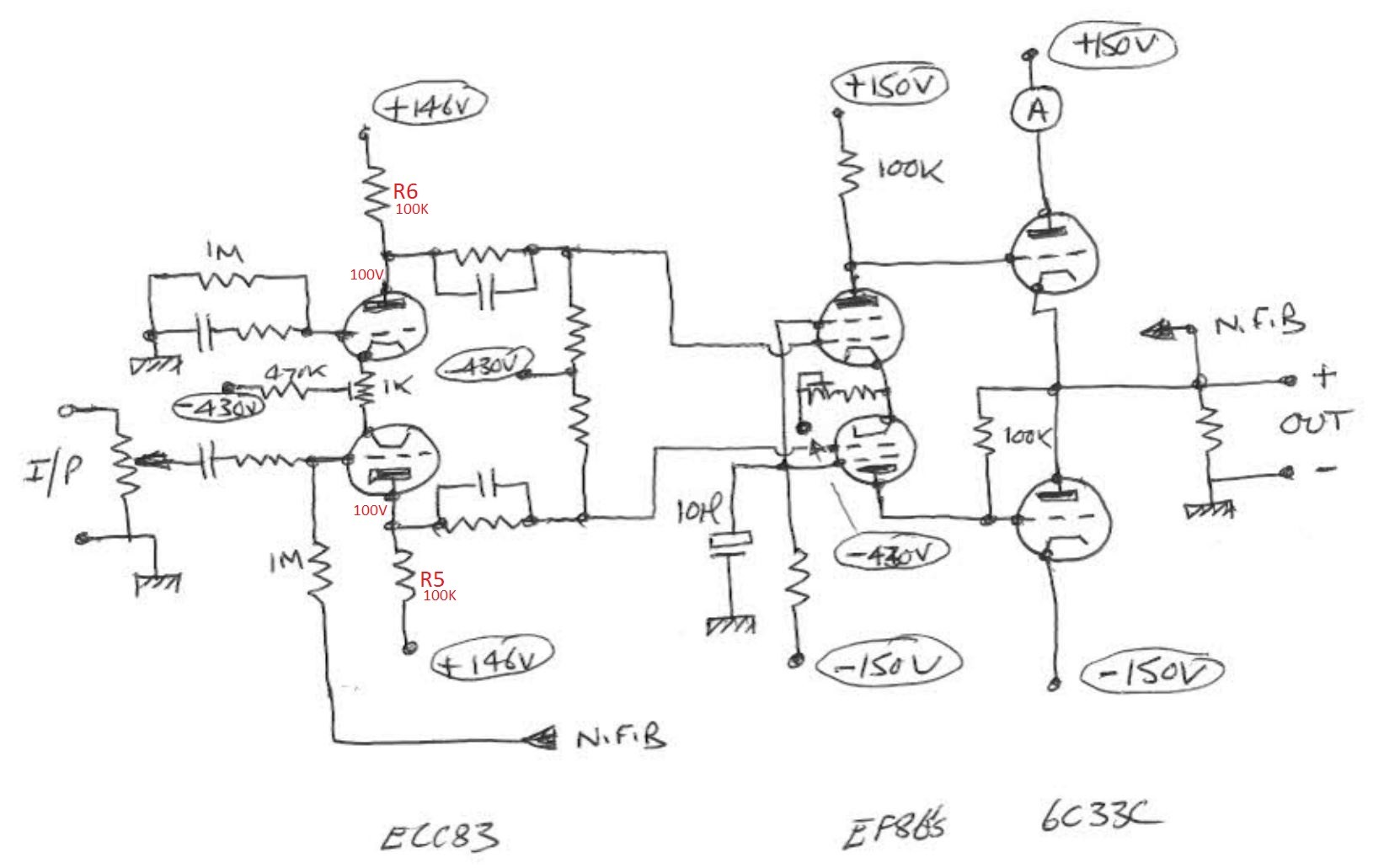

The sub-min schematics aren't well set out though so it takes a bit of concentration. I found this sketch of the Mellow schematic to be useful;

Hi All, I have just completed the mellow OTL amp but on testing without any tubes the v1 tube , viper of RV2 and grnd shows -450volts and the neon bulb doesn’t burn, I can’t understand why the voltage is not being restricted
Just replace the N1 or check it on different (adjustable) HV supply. Don´t forget to put 200-500K resistor in series in that case...
It was a faulty neon bulb, now I am not able to bias the tubes as with 10k pot I am able to go to 45Ma , max.
New problems don’t know why the circuit is exactly like described..
i will not worry too much,-450V could be too much! Pay attention it´s -430 on the original schematic.

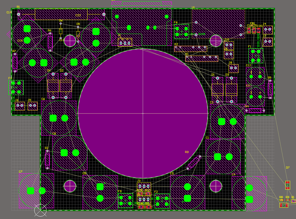

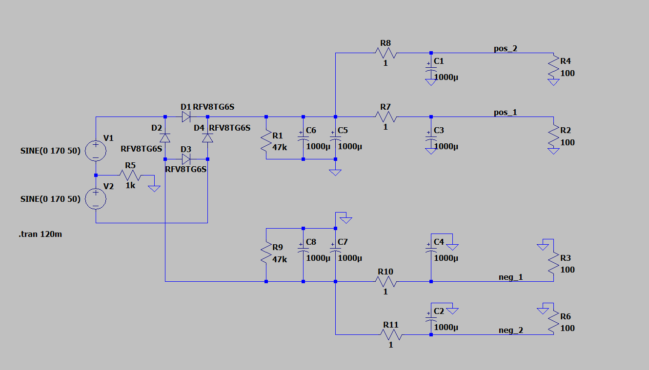

Hi, I'm at the beginning of the design of the hw part of the otl amplifier (pcb, components, chassis). And since I have little space in the chassis, I have to use a common power supply (+-150V) for both channels. My question is, will this connection reduce crosstalk between channels?
The output voltage ripple should be reduced by 1Vp-p compared to four 1mF parallel capacitors - according to the simulation.
Do you see any other advantage except of the ripple ?
Yes, that was my first intention, but unfortunately I no longer have room for the -430V and +146V capacitors. I will be happy to be able to use 4 filter caps on +-150V ...
