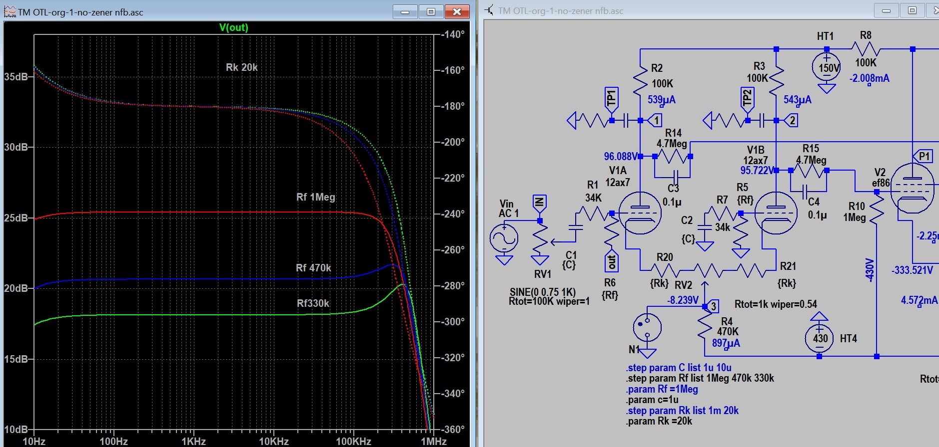

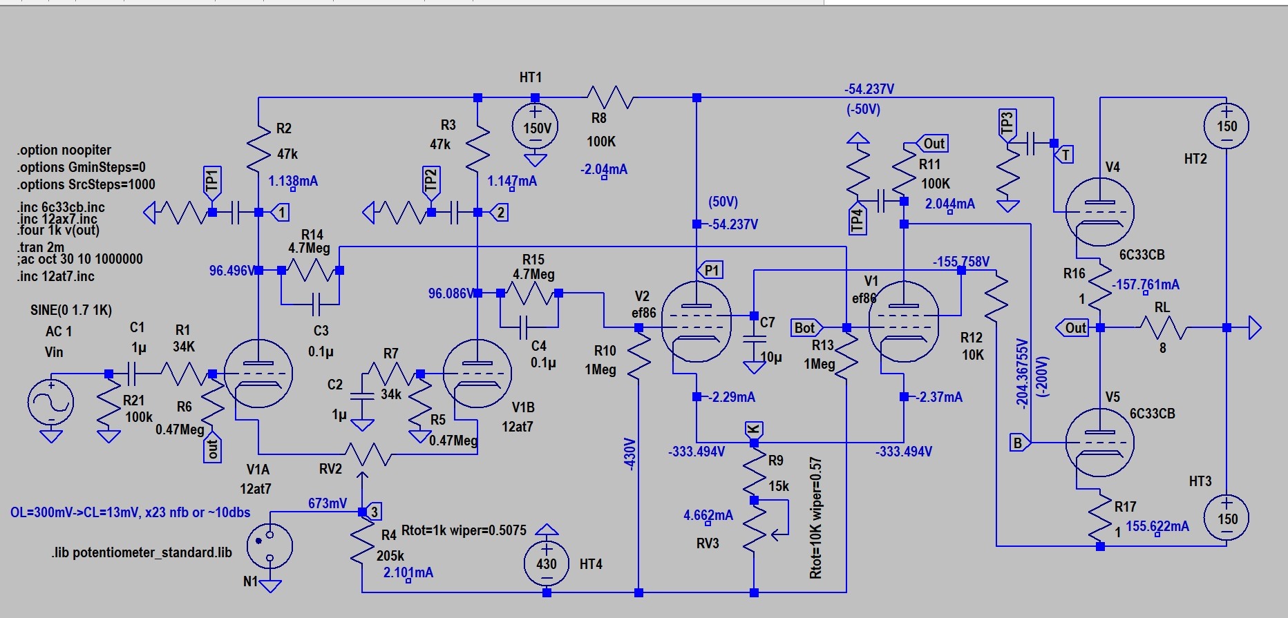

Finally I came to my final conclusion (and need) regarding input sensitivity, using pots or not and re-read all of these comments about reducing gain (of input stage) via cathode resistors + increasing feedback too (to some extent).To reduce gain in front LTP just insert cathode resistor of equal value to each leg with out affect the anode voltage that set the bias of entire stage. When the gain is reduced you need to increase gNFB to maintenance damping factor is also a good way to check which damping factor is best for your speaker.
12ax7 ltp stage has a max. gain of 20, it's possible to reduce it to unity with 20k cathode resistor.

Being on a learning path with circuits, can you help me with the following ? I learned you already go this route too, so:
- I'd use 20k cathode resistors on the input tubes just like you're using (if I'm right)
- what value to use for the RV1-substituting fixed resistor in this case ?
- what value worked for you for R3, the feedback ?
- and finally, what are the input sensitivities you achieved now with these modifications ? (Just for me to know). For both RCA and XLR (although I'm mainly aiming for XLR).

I recalled one asked if 12at7 can be used instead of 12ax7, presumely to reduce sensitively. Yes it reduces sensitively by 3X (0.5v-1.7v)
Change 100k plate resistors of 12ax7 to 47k, IM feedback/grid resistor to 470k. If you use other lower gain tube like 12au7 the sensitivity can be further reduced. DC servo may be not as good due to loss of gain, I don't know maybe offset is still acceptable if bias is adjust properly.
If you use 20k cathode resistor, it reduced the gain by X10 (same if 12at7), so you'll use 470k for nfb/grid resistor. RV1 (vol pot) can be fixed at 100k
Thanks a lot. My bad, but I think your linked picture doesn't help me further at this stage, super confused, I worked and still stick to the schematics drawn and published in the article. That's the only one I can look at right now. 🙄
So to sum up, what would work for sure:
Did I understand you correctly ?
What would be the max. input voltage in this case ? (Approximately).
- Swap R3: 1M -> 470k
- Two NEW resistors between RV2 and the two cathodes: 20k (each)
- Swap R5, R6: 100k -> 47k (each)
Yes, max input voltage is 1.7v for full output. If you stick to 12ax7, the plate res. is still 100k, do not change to 47k, it is for 12at7.

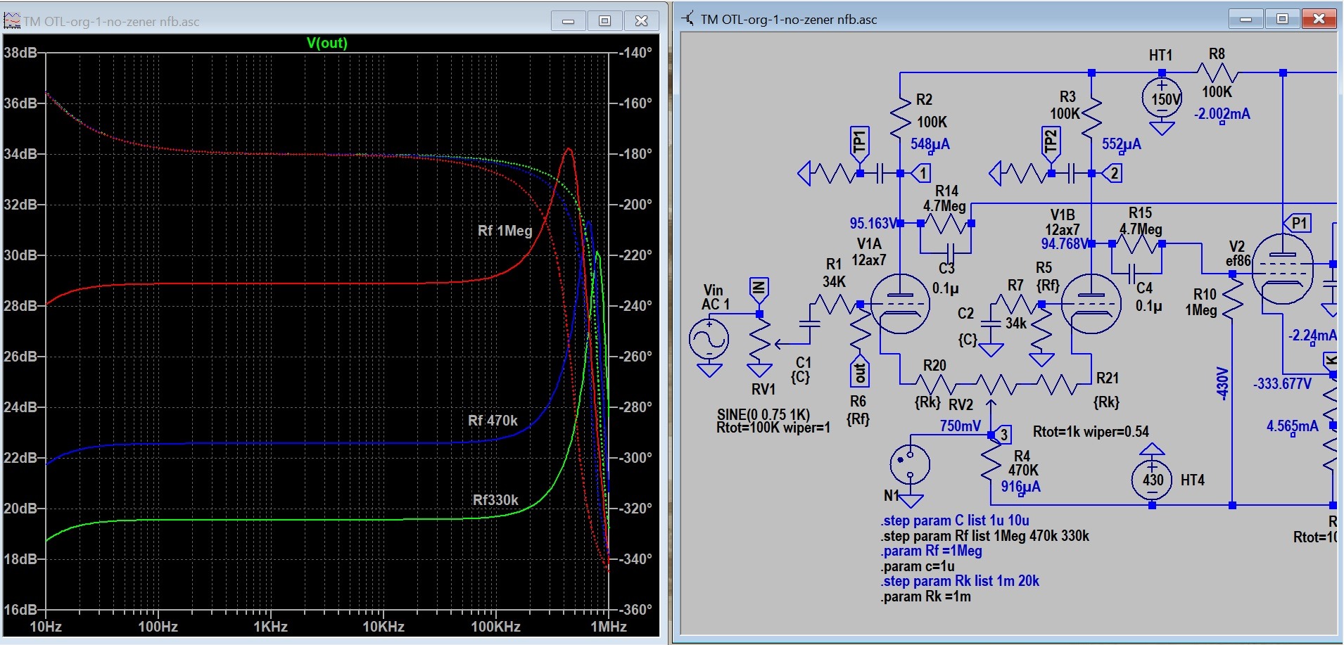

if you have to reduce the gain by cathode degeneration resistors, why not just replace the 12ax7 with a 12au7?
As I understand from OP he probably can do tube rolling in future, now the prioity is get original working. Could add cathode resistor on demand using a switch with no other modifications. even tube rolling required a few changes in the resistor value. It would be wise to do AB test: A-original, B mods, but still need audio balance (voltage divider) to be able to compare. I can't do tube rolling in particular PCB as tube has no equivalence unless I change the driver schematic. My driver is on eyelet PCB hand wired (not printed) so there is not much limit as to what I can do. If you're doing development project like me you should build driver on PCB rather than hardwired into chassis (even point to point), replace one or both PCB is all you need.
normal design uses high open loop gains before application of feedback, why would anyone degrade the open loop gains in the first place?
why not use 330k feedback resistors instead of 1meg?
I feel this amp has a lot of negative feed back applied already add more may cause instability or over damping. There is no one fix NFB would suit all your speakers, it may or may not work. I have a look at frequency responce, the current level of NFB has very high peak at 100k, add more feedback cause it to peak higher. You can compare the response when 20k cathode is used, no peak at all.
open loop gain minus closed loop gains.....open loop gains are important for bandwidth and stability...decrease the open loop gains and you can get into trouble easily...
I hate to say but this is your option, right? Too much feedback can easily cause instability, that is general consensus esp. when it has a transformer in the circuit, the amount of feedback is very much limited. 12AX7 is considered low bandwidth, try to increase feedback is asking for trouble.
