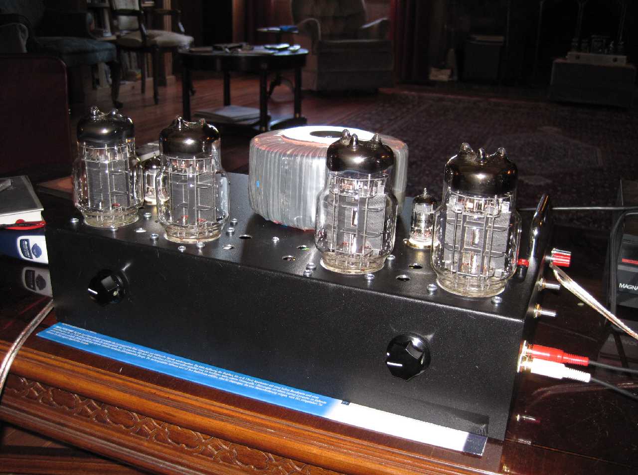

Here's a photo of my amp:
The toroid on top is for the HT supplies for the output tubes; it's a Hammond 182P117, with two 117V, 2.67A secondaries. I put the other transformers underneath in
the chassis; a Hammond 182S12 which has two 12V, 9.38A secondaries, for the 6C33C heaters, and a smaller Hammond 182L6 for the rest of the heaters. All three are concentrically mounted.
Oh yes, one more thing occurs to me; I strongly recommend adding lifting handles, as Tim Mellow did! It makes it much easier to pick up!

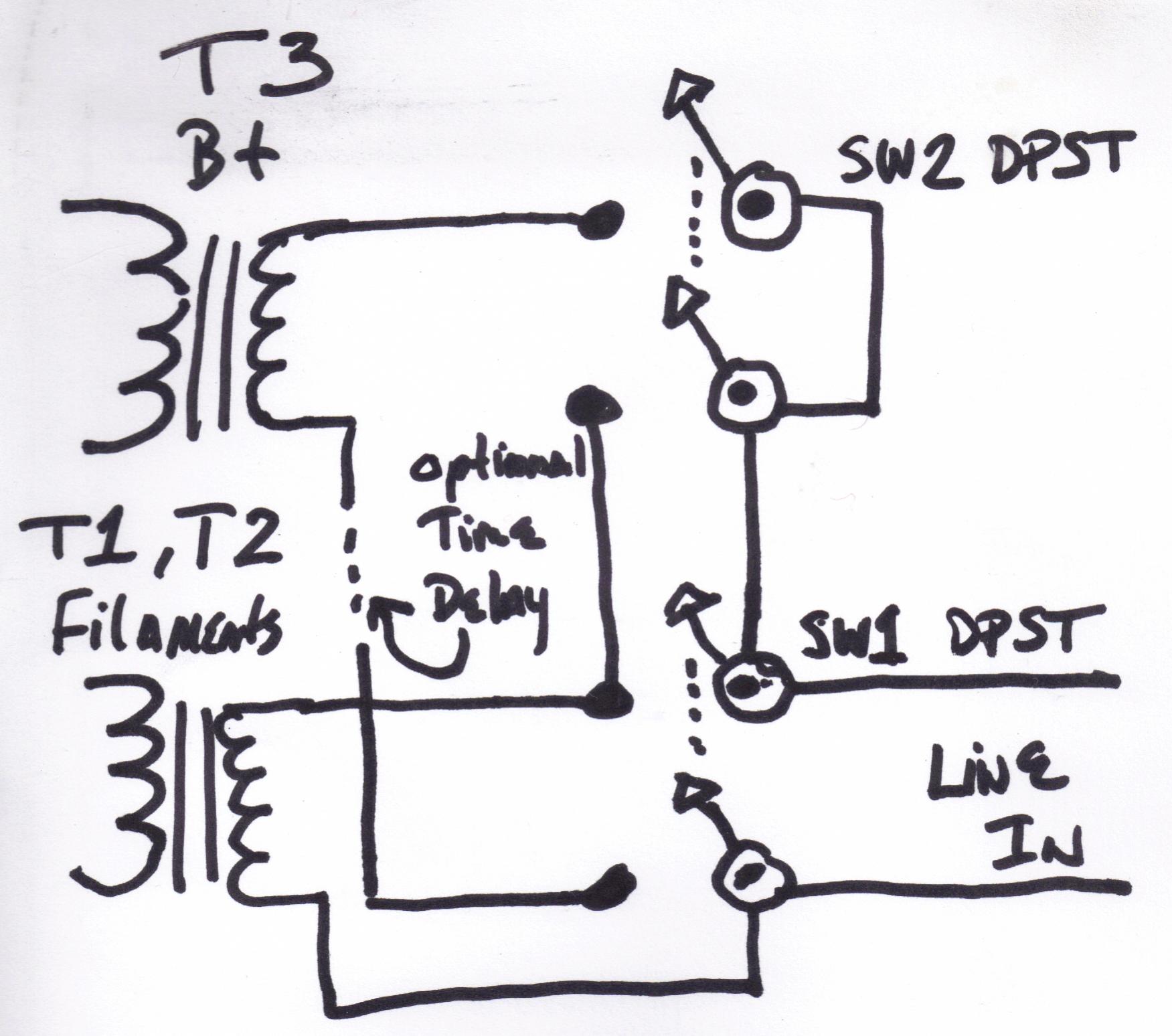

Thinking about wiring up the amp this way....from a file i found on the net long ago....faded now so i penned it.
Looking at this now.... time delay is useless I guess.....oh well

djn: If you're refering to N3, I'm reading that as a neon lamp. I'm not seeing a relay in the schem. Good idea, though - there are time delay relays boards available on EBay that fire up the HT 12-30 sec after the heater trafo powers up. Don't know anything about these units in particular, but it's an idea...

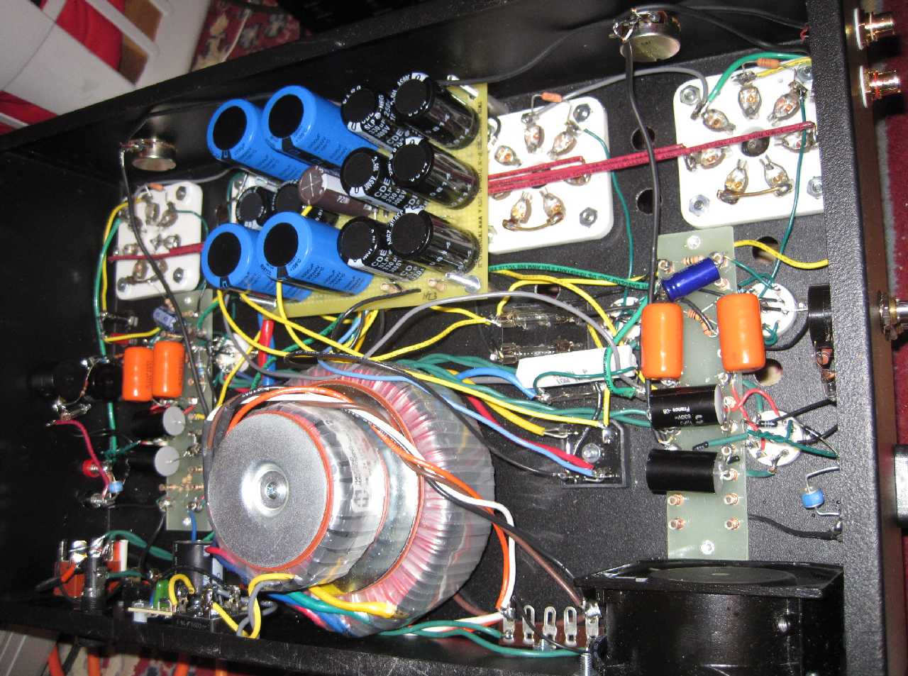

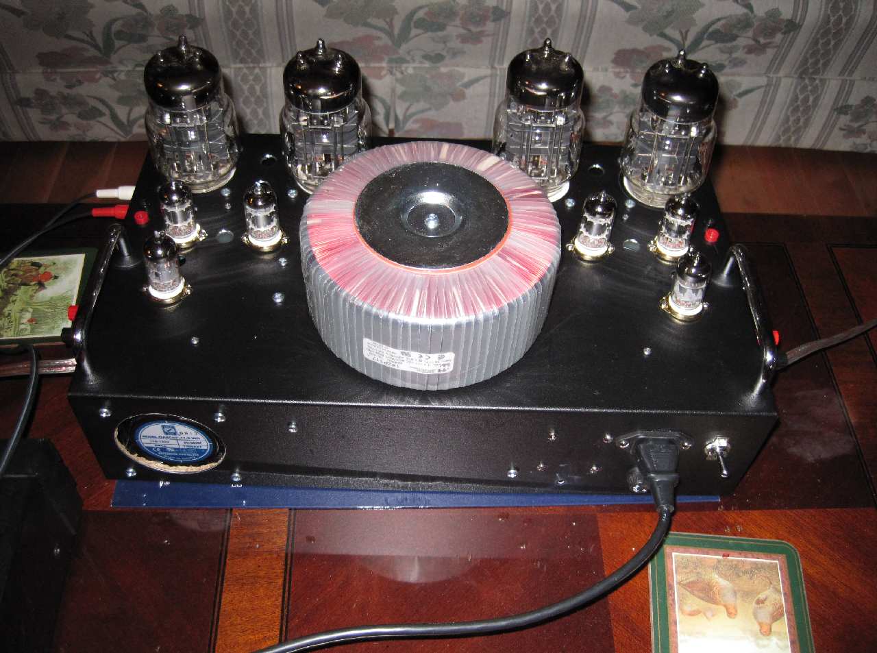

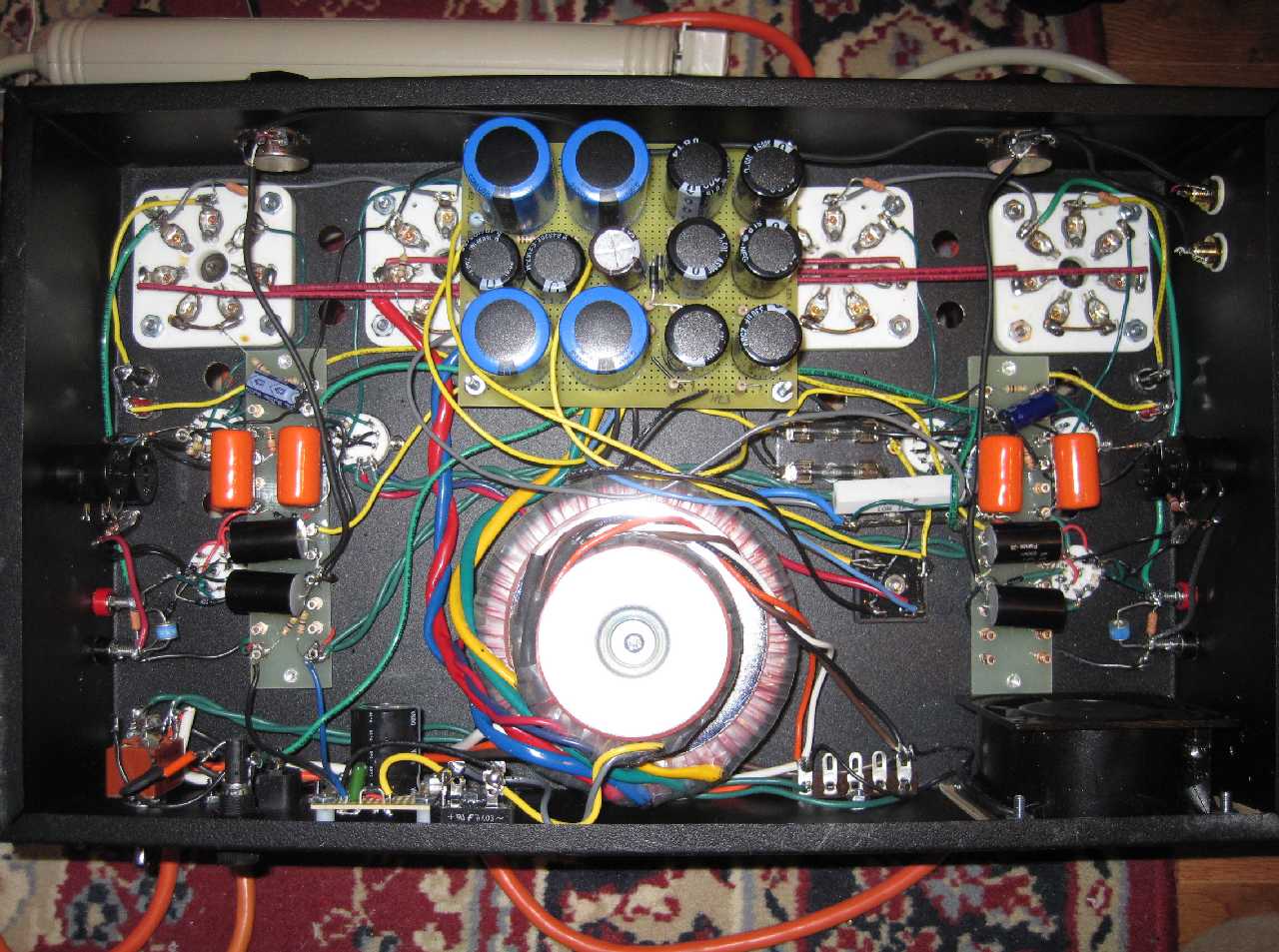

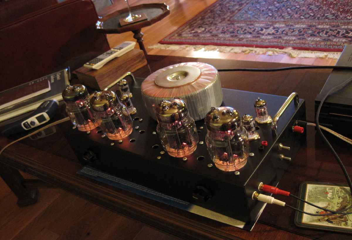

Here are a few pics, two from below and two from above. I'm afraid my wiring is a bit of a bird's nest, although functional.
The two transformers under the chassis are for the heaters; 6C33C's powered by the larger one, and the rest by the smaller one. The monster above the chassis is for the HT supplies.
Chris
