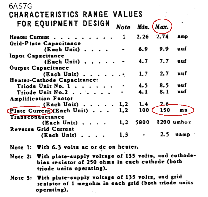

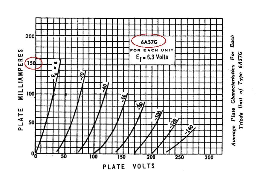

I can't seem to get your numbers to work.You can get 20 watts out of a pair of 6AS7Gs if the load impedance is high enough. You'd need a 64 ohm load or thereabouts.
It looks like 150 mA max current per triode (see attached datasheet grabs.)
Four tubes = 8 triodes, presumably four push-pull pairs, so maximum peak current for either half-cycle is 4x150 mA, or 600 mA (peak).
Maximum RMS current is therefore 600/(square root of 2) = 424 mA = 0.424 A.
Maximum power output into 64 ohms = Irms x Irms x 64 = 0.424 x 0.424 x 64 = 11.5 watts.
It would appear four of these twin-triode 6AS7G tubes, wired as four push-pull pairs, can only deliver 11 or 12 watts RMS into 64 ohms.
So it would seem that you'd need eight 6AS7G tubes to deliver 46 watts RMS, near enough to the 50 watts you mentioned.
Any idea why there's a 400% disagreement between my math and yours? Are you running the triodes to twice their rated maximum current (which will quadruple the output power)?
-Gnobuddy
That's a DC limit.
Peak current can be higher. Especially on speech/music/guitar instead of steady test-tone.

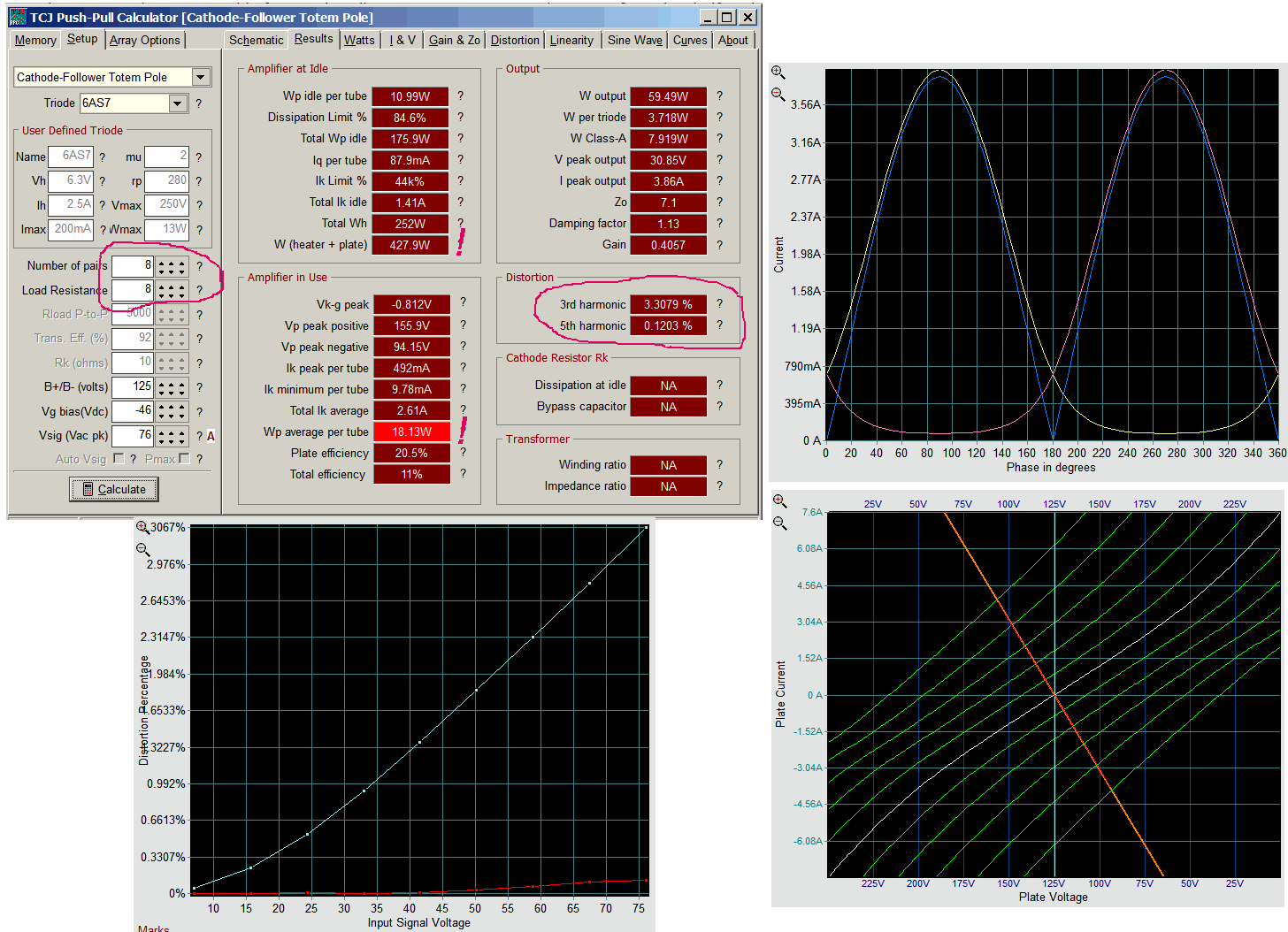

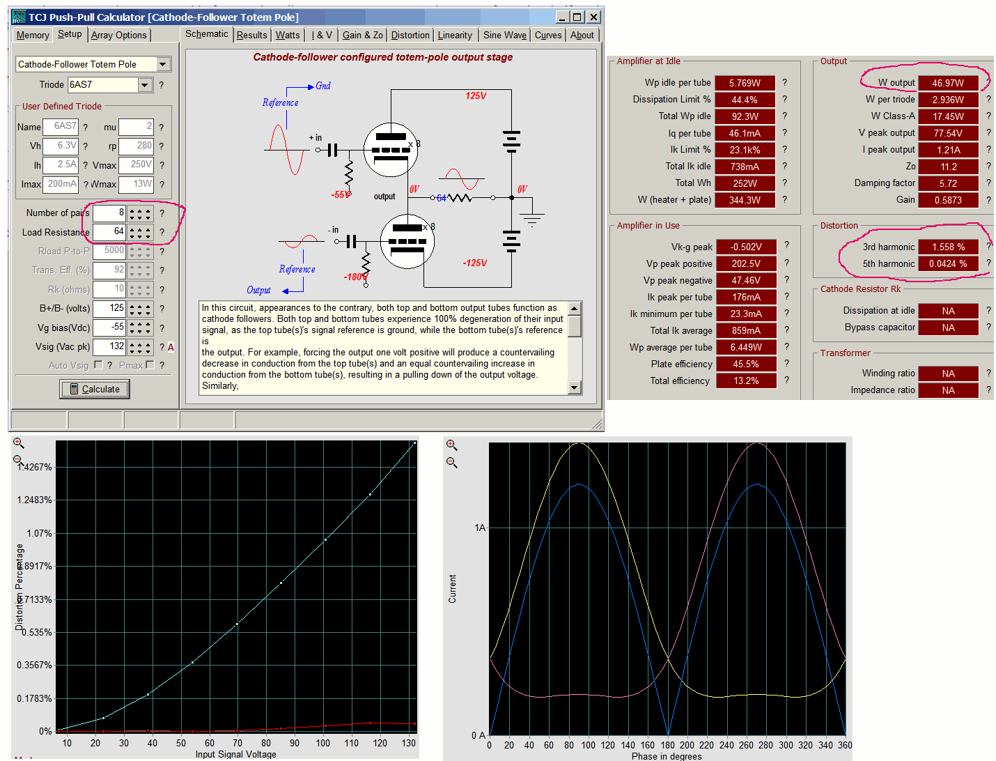

I happened to have a 6080/6AS7 plan set up in TubeCad PPcalc. I don't think I hit the conditions you are discussing. I'm not totally sure I believe these numbers. I might be able to confirm them in hand-check, but too much work, not my amplifier. (Look at the total power consumption!!)
First eight pairs (8 bottles) into 64 Ohms. 47 Watts at low THD without any grid current. Plate current curves look reasonable. 176mA peak per plate is fine.
Second, eight pair into 8 Ohms. 60 Watts! 3%THD is nothing. Plate efficiency and total power sucked are atrocious. Plate dissipation is significantly exceeded; I would overlook this for unclipped speech/music but on overdriven guitar I would expect real poor tube life. I'm sure this can be some better with change of supply voltage. It still seems like an expensive way to avoid a transformer.

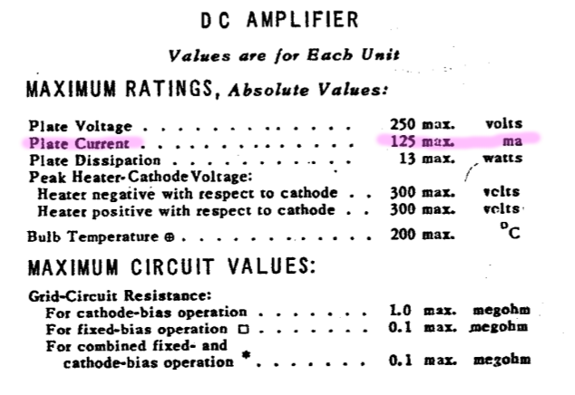

For DC, the datasheet limit is even lower, at only 125 mA (see attached datasheet snippet.)That's a DC limit.

For DC, the datasheet limit is even lower, at only 125 mA....
Ah, that is what was in my mind.
Your "150mA" is taken from expected current spread under certain conditions. Actually says "100mA-150mA", a reasonable spread on an important parameter.
These were designed and marketed as Pass Tubes, voltage regulators.
The 125mA rating is "steady all day". I was just reading an RCA TV-rack power supply, 275V 1,500mA, which would normally be left on and mostly loaded from before Dawn Sermon to after the Late Movie. (Most TV processing pulls a steady current.)
As atmasphere's experience shows, these tubes are sturdy and can *peak* far past their steady rating. It may take positive grid well. That was not normally done in Pass-Tube work; the tubes are designed to reach their steady all-day rating below zero-grid, because that simplifies the error amplifier design. But for the very spiky nature of speech/music it makes sense to beef the driver and drive the big tubes into grid current.
