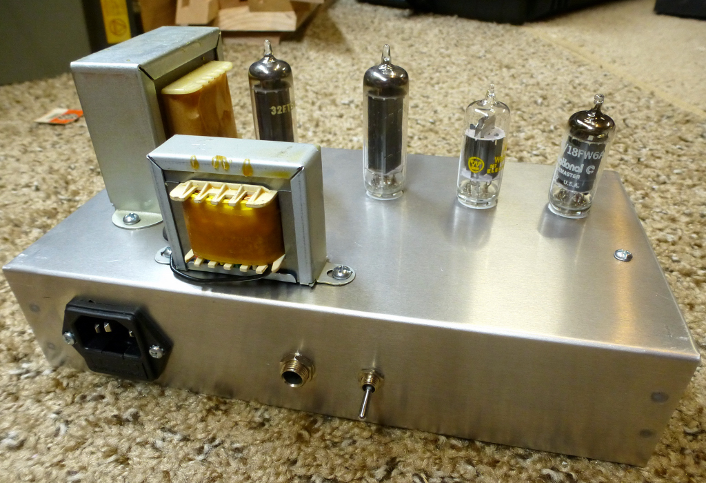

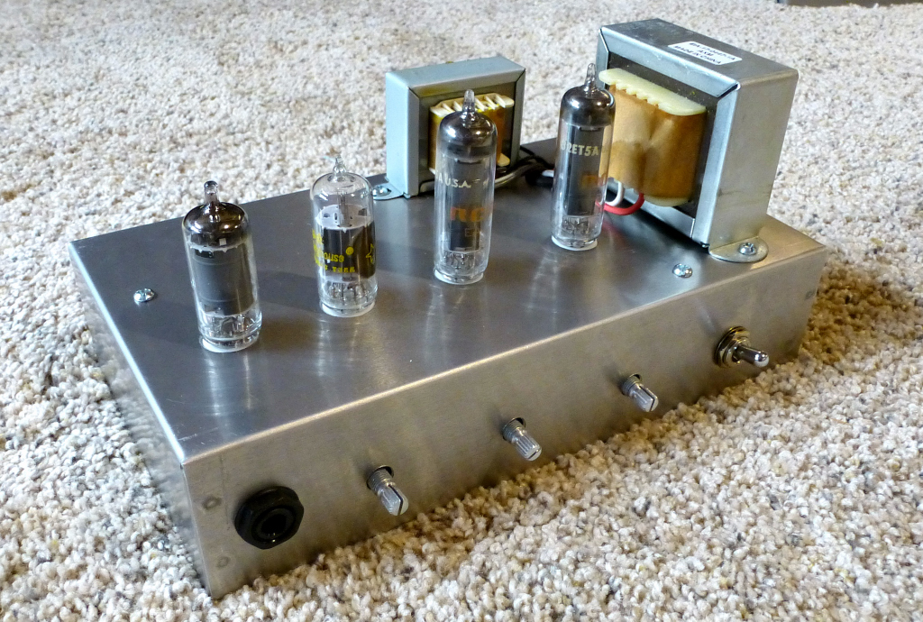

I got a pair of power transformers for the output at a local surplus outlet (Acme Electronics, defunct since losing their lease) for $6.00. I can't tell what brand but they are marked 'A10310B' and have 117V in and 92.5Volts out. Later I added a control transformer to buck the AC another 12 volts for a little more power.
The 6080s were obtained at a ham swap meet (Midwinter Madness although it was in March) for $2.00 each. 6080s usually don't hold up as well as 6AS7Gs but for $2.00 each I wasn't complaining. A 6SN7 was sufficient to drive them. Sockets came from a coffee can full of used sockets in my basement. I might have $5.00 into that can; had to clean up the sockets prior to use. I found a filament transformer (Signal Transformer Co.) that did 10amps for $10.00, this time from Ax-Man Surplus. A Bud chassis served; $15.00. I used one of our driver power supply transformers for the 6SN7 B+ and B- (I ran it as a cathode follower). That transformer was $12.00 when new (its been sitting on the shelf here for about 20 years). Two 12AX7s suited as the voltage amplifier and preamp. I suppose I have another $20.00 in junkbox parts to put it together with a switch and fuses, Alps controls and Switchcraft 1/4" phone jack. Filter caps gobbled a bit of the budget but no worries coming in under $100 total let alone 100 Euros.
The circuit runs zero feedback. I'd need another gain stage to add feedback. That's why a higher impedance load works best. Otherwise it tends to be too bassy. A box with several drivers in a line source array works pretty nice as the sound pressure does not drop off so quickly as you move away from it.
In my regular amps (production prototypes with more finished chassis work) I've made two versions (each using four power tubes). One uses a direct coupled cathode follower as the driver similar to the prototype above. The other uses an Edcor transformer to convert from single-ended to balanced output for the grids of the power tubes.
Since I'm not running a whole lot of bias current, I don't have either a bias or DC Offset control since the DC Offset current is minimal if the tubes are OK. Its not class A, but it has no crossover artifact since there is no magnetic field to collapse.

1 watt into 32 ohms needs 5.7 volts RMS at 175 mA. Peak currents should be in the 250 mA range and peak to peak voltage swing should be around 16 volts, but that's driving a resistor. A 8 ohm guitar speaker near resonance can be 20 ohms or more, and resonance is often within the guitar's frequency range for smaller speakers. I imagine any B+ voltage that gets the tubes to work will provide plenty of available voltage swing.
The (conservative) 10 watt dissipation rating comes into play as B+ goes over 100 volts on the 6W6 / 12L6 if you want to stay in class A. The 7695 can eat 16 watts.
There are several different circuit topologies that can be used for OTL. The totem pole like SemperFi's design, the Circlotron like Atmasphere uses, the Futterman, and the SRPP like circuit shown in the 7695 data sheet.
It has been postulated that an SE OTL would be the worst of both worlds, but it just might work for a guitar amp, and it offers some other circuit choices like the SRPP with some minor tweaks.
