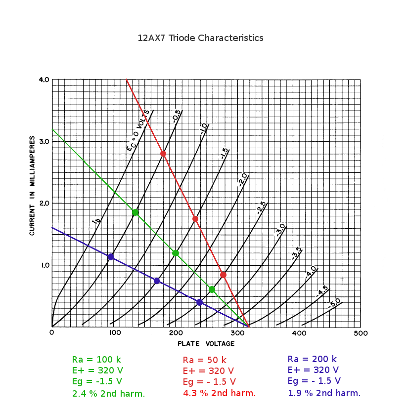

This thread is very interesting to me, partly because my notebooks have contained sketches of triode valves feeding PNP current mirrors for several years now.
I came to that idea because I realized that, with a common-cathode triode gain stage, the lower the load resistance, the more second harmonic distortion you get. (See figure 2, attached.)
In figure 2, the middle dot on each load-line is the operating point (quiescent current and voltage). The two end dots represent positive and negative peaks; grid voltage swings are equal (look at the grid curve numbers), but the resulting current and voltage swings at the anode are not equal. The more the asymmetry between positive and negative half-cycles, the larger the amount of second harmonic distortion.

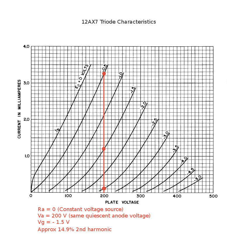

I've estimated this distortion from the graph, and the estimated second harmonic distortion numbers are at the bottom of each image.
Okay, low load resistance is good for lots of second harmonic distortion, which we want for a guitar amp. The lowest load resistance you can have is zero ohms (figure 4, constant voltage source load). But zero ohm loads produce no voltage swing across them, so you also have zero voltage gain.

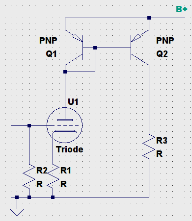

An amplification stage with no (voltage) amplification isn't very useful, so how can we get around that?
The obvious answer was to use a current mirror. It acts like a nearly zero-ohm load to the triode, so it produces lots of that lovely "tubey" second harmonic distortion. But the current in the second arm of the current mirror can be dumped into a normal-value load resistance (R3 in the attached image), producing about the same voltage gain as a "normal" common-cathode gain stage. Best of both worlds! (See attached figure "triode w current mirror".)
That idea is very, very close to parts of SemperFi's schematic in post #54, the only real difference being that SemperFi is using a long-tailed-pair rather than a single common-cathode triode stage. And, of course, SemperFi actually built the thing and showed that it works, while my ideas stayed on the pages of my notebooks.
I'll continue the discussion in a later post. For now, here's the raw current-mirror idea, along with some of the load-line sketches that led me to it.

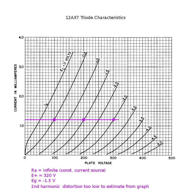

Note that a constant current source load is the highest load impedance you can get, and therefore has the opposite effect, producing very little second harmonic distortion from a triode (fig_3_CCS).
Not surprisingly, a CCS load is frequently used in modern valve Hi-Fi preamp stages, where designers are attempting to produce low levels of distortion.

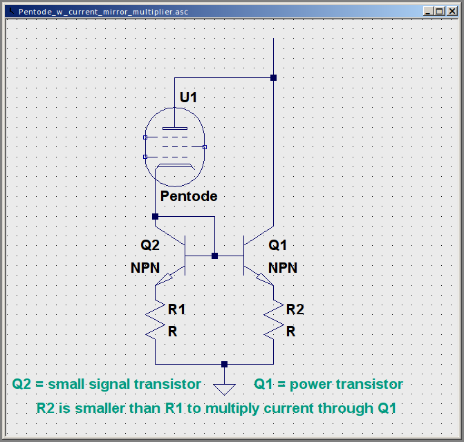

Okay, now we have some reason to think that a current mirror might actually be a way to get a good clean sound (i.e., lots of second-harmonic distortion) out of a triode stage.
But the primary focus of this thread wasn't about current mirrors, it was about eliminating output transformers.
But those two ideas (current mirrors, and OTL) can actually be connected! At this point, we know valve OTL guitar amps can sound good. But valves really struggle to deliver the huge currents that speakers need. Transistors, on the other hand, are wonderful at delivering large currents to speakers, but transistor-based guitar amps don't sound as good as valve ones.
So: what if we use a current mirror, arranged to force an output transistor to exactly duplicate the current in the output valve? Now the transistor should sound exactly like the valve.
And what if we add the transistor current to the valve current? Now we have twice as much current as one valve can deliver. Four times the audio power to the speaker, without doubling the number of output valves.
And what if we can modify the current mirror so that the second branch not only mirrors, but also multiplies, the current from the output valve? Then we could deliver triple, or quadruple, the current to the speaker, and it would still sound exactly like the output valve, because of the current-mirror action that makes the transistor follow exactly what the valve does.
There are a few ways to make a current mirror that also multiplies current. One way is to use transistors with unequal (semiconductor) junction areas. The bigger junction-area transistor will flow more current than the smaller one.
A similar effect occurs if you parallel two or three (or more) identical transistors. If they're identical, you've now doubled or tripled the total collector current, for the same base-emitter voltage.
Unfortunately, identical power transistors are not easy to find, and also cost money.
There is a simpler (and somewhat less exact) way. Add a small emitter resistor to each transistor in the current mirror. Make one resistor smaller than the other. The corresponding transistor will flow a larger current.
This idea is shown in the attached image. I have not built and tried it out. So I don't know how well it works (yet).
This idea is not as elegantly perfect as the PNP current mirror connected to the anode. In this circuit, the voltages across Q2 & R1 do interfere a bit with the voltage at the cathode of the pentode, so they will, to some degree, alter the current through the pentode.
However, the voltage across Q2 is nearly a constant 0.7 volts or so, quite small compared to a typical output valve bias voltage (often twenty volts or so). Similarly, R1 can be chosen pretty small, so that only a few hundred millivolts are dropped across it.
So I think the circuit can be built with component values that pretty much leave the pentode alone, only minimally altering its transfer characteristic. That means it will still sound like a pentode.
One more thing - while I've shown the pentode's anode connected to the transistor collector, there is no need to actually do this; the transistor could be run off a much lower voltage B+ rail than the pentode. This would reduce problems with second-breakdown of the transistor.
Ironically, my idea would involve removing the output transformer from the valve - but adding an output transformer to the transistor, to get the power actually to the speaker!
But the potential benefit would be easy delivery of large amounts of power, courtesy of the transistors, while maintaining the all-important "tube sound" or "valve sound" that we want in our guitar amps.
-Gnobuddy
