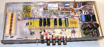

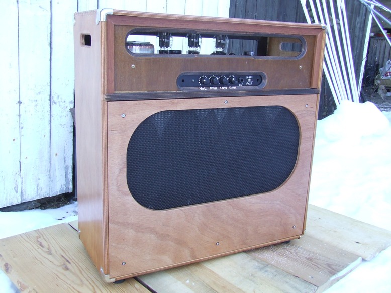

That's a sheer work of art!The amp I built can be seen on the Atma-Sphere facebook page.

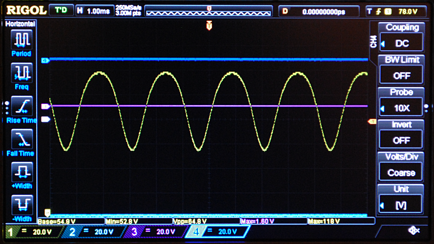

Guitar amps are not subtle things in terms of the way they modify the signal passing through them. I think only fairly heavy-duty alternations to the signal are audible in this context.
An example: a couple of years ago I was struggling to achieve a good clean tone with the little guitar amp I was designing and building. I finally succeeded, working blind, without an oscilloscope, using only my ears and a DMM.
Some months later I was able to save up enough to buy a Rigol 'scope, and the attached photo shows what I saw when I looked at my "clean tone".

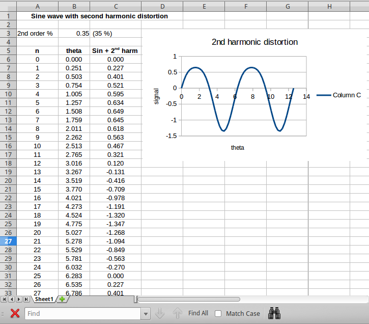

The second picture shows a simple spreadsheet simulation: a sine wave with about 35% second-harmonic distortion added to it. The result isn't quite identical to the scope capture, but has quite a strong similarity to it.
The surprise for me was finding out just how much 2nd harmonic distortion it took to create a good clean tone. Roughly thirty five percent!
(The guitar tone doesn't sound at all distorted under these conditions. It sounds like a nice "tubey" or "valvey" clean tone, there is no audible harshness or "grit" at all.)

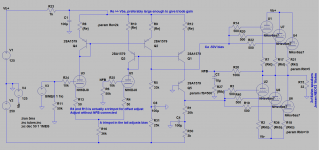

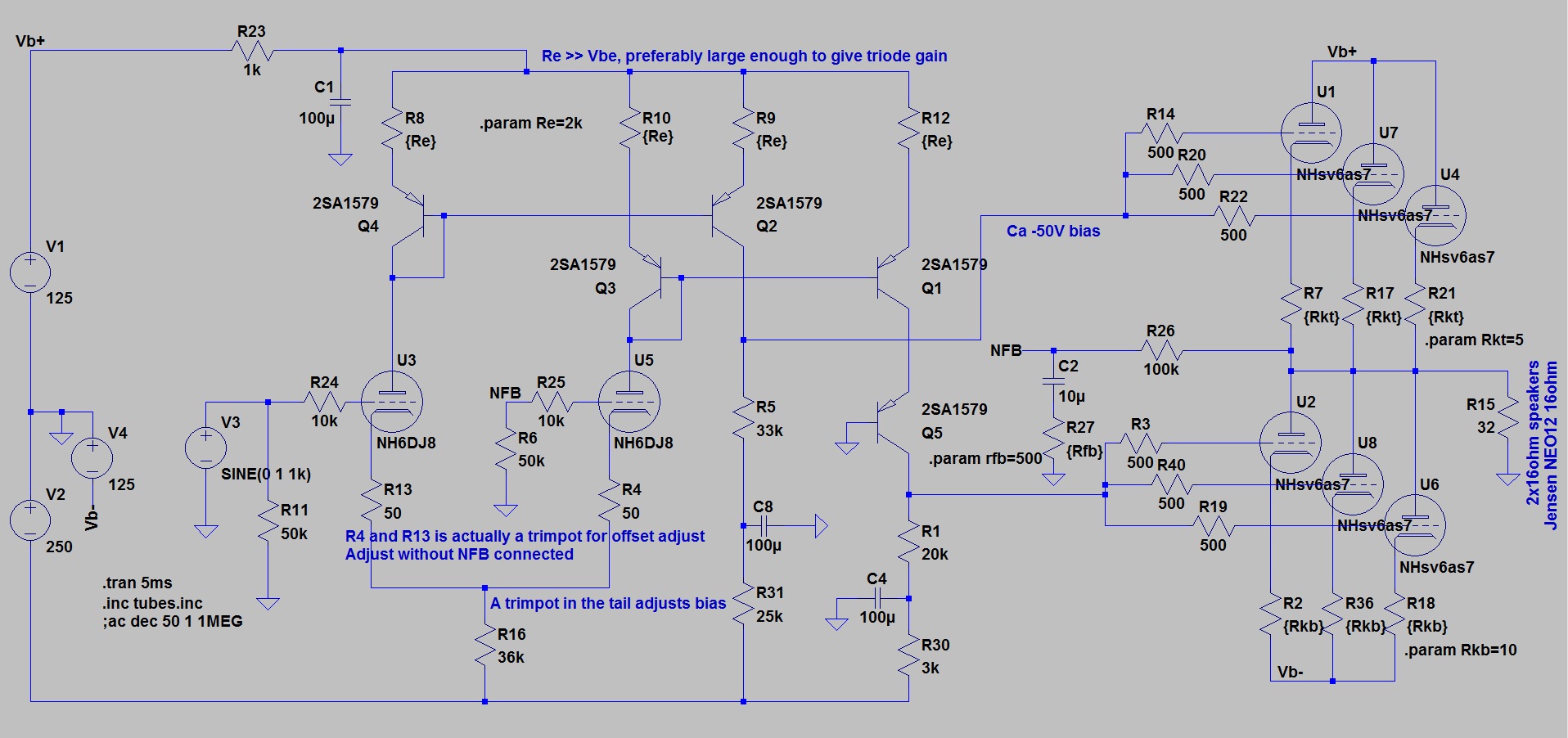

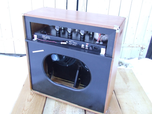

Sorry for long response time on the schematic. I still haven’t got the actual schematic of the amp in the video. (I have my work shop some 3hours drive away and am seldom there these days). Here is a sample that shows the idea.
I'm pretty sure I've posted this idea before.
I leave the preamp out since I think only the OTL output section is relevant here. We all tune our preamps anyways. But as mentioned most of the sound is in the pre.
I had a few criteria for myself when I started this project. The main one being:
-Not yet another clone. So no Fender/Marshall based amp, and no circlotron since Atmasphere covers that topology. No Futterman and no Tim Mellows...
This is actually a very flexible circuit.
The folded cascode criminally introduces transistors, but they only mirror the triode's current and I don't think they do much to the sound. They give the possibility of varying the LTP triode’s characteristics. Small emitter resistors and the triode’s plates see a stiff load and they behave more like pentodes. Large emitter resistors (large enough to give gain) gives voltage swing on the plates for some inherent triode-feedback. It lowers the total gain so there’s a limit. Anyways make sure they at least provide Vbe drop (0.7V) so the transistors don’t need to be matched.
The bias is easily set with a potentiometer in the tail. CCS can be used in the tail, but I haven’t been able to measure or hear much benefit.
The resistors for the 6AS7s drive (R1 and R5) can be varied for very asymmetric or symmetric drive. Just keep the combination of R1+R30 and R5+R31 so the bias voltage stays the same.
Capacitors can be placed across from R1 to R5, with or without resistance, for high-cut function.
I only use feedback for DC offset. The ‘RFB’ resistor is not used. (Actually I have made some with a pot there for ‘presence’ control). The response (gain and distortion) is pretty dependent on the speaker load impedance, but in practice I haven’t heard big difference in terms of distortion.
I’ve tried Wilson mirrors and various cascoded mirrors. The simpler ones are just as good. Probably since I use large emitter resistor values.
I use farely large resistor values 5-20ohms in each 6AS7’s cathodes. Efficiency isn’t anyways...
The 6AS7s grids can be driven by a cathode follower or Source follower or simply directly. Books from yesteryear claim triodes should be driven by a low impedance source for softer clipping. Lots of experimenting just there. A benefit of the folded cascode is the current is increasing with the signal voltage so as the grids start conduct the drive is at it’s max.
So its DC-coupled. I use no protection, no fuse, no servo, etc. I’ve pulled and inserted 6AS7s while the amp is on and playing. Never had anything harmed, no speaker and no tube. I've left it on for months, hot biased, never had problems with offset or drift. Not enough anyways. The speakers handle offset of some tens mV very well.
I usually use two 16ohm 12inch guitar speakers in series. The 32ohm 10inch I’ve tried sounds like crap to me. (I have two, never used much after a disappointing attempt).

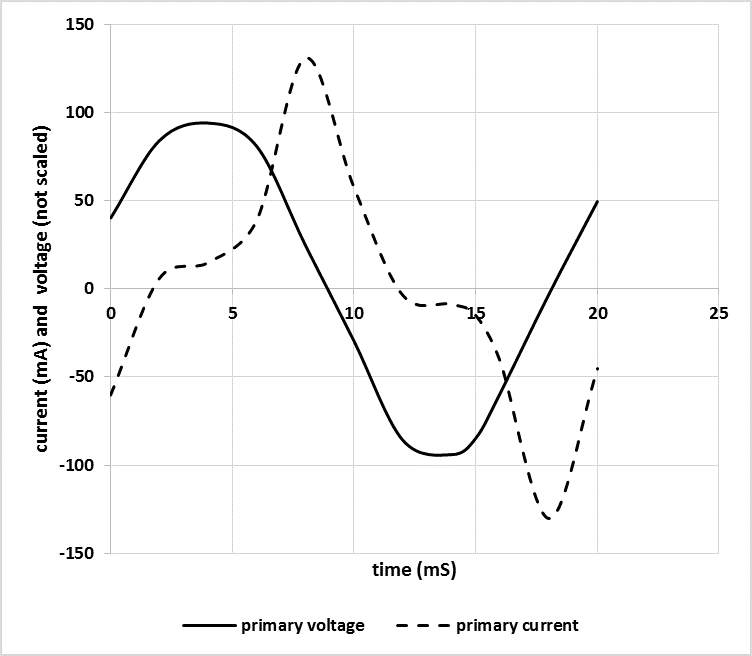

Here is an example of a classic saturated current waveform (dashed curve):
This was obtained by applying mains voltage to a small power transformer. The source impedance for mains voltage is just a few ohms.
I think if the OT saturates it creates very ugly distortion, not the good type that give legendary tone. I think very few amps have that problem, but some have too small primary inductance and therefore sound thin.
