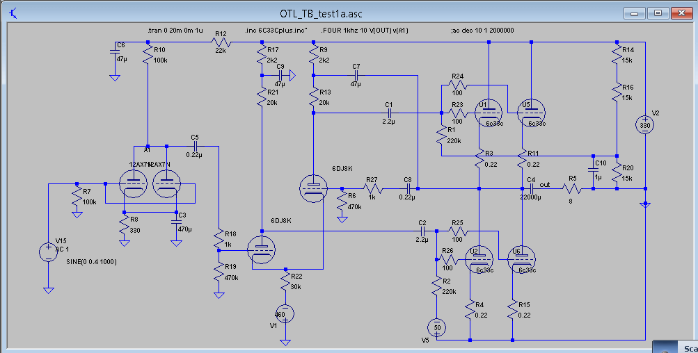

resistor helps to equalise the current sharing between the two valves
Yes they are necessary when paralleling valves but need to be much larger to be effective, they have often been omitted in commercial OTLs with disastrous results. In the datasheet of 6C33C it is recommended to derate max current for each tube when used in parallel even when current sharing resistors are used.
Yes they are necessary when paralleling valves but need to be much larger to be effective....
Agreed. At a guess 1 - 2 ohms would be useful, but even then only with matched tubes with individual bias settings. My own 6C33C project is still in boxes and on paper - too much real life stuff getting in the way.

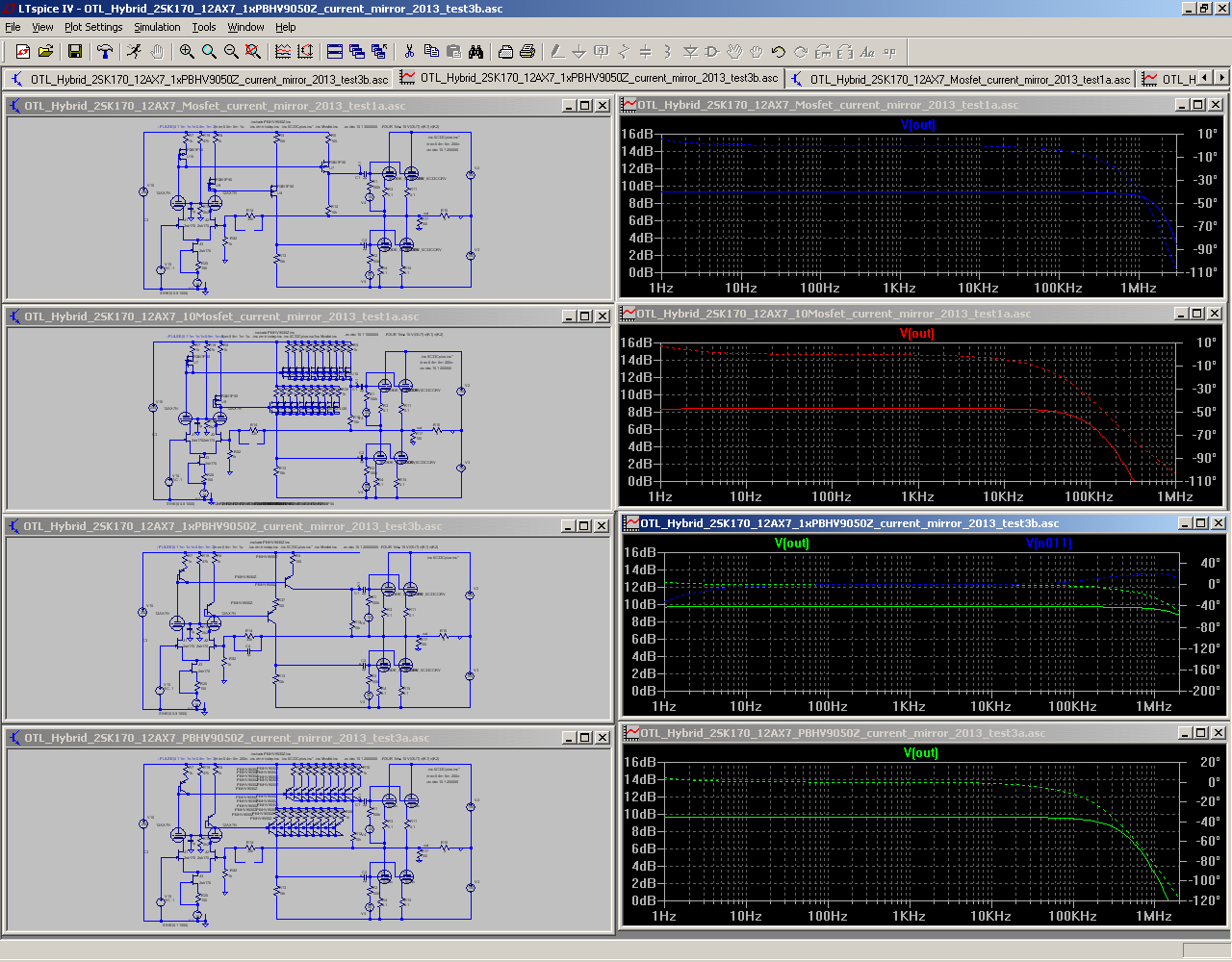

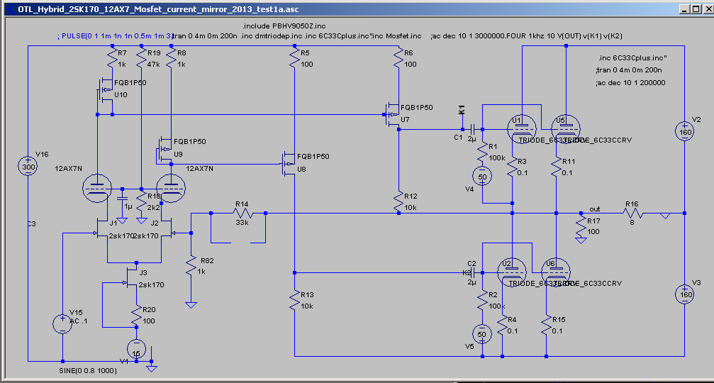

Hybrid ver1a - part 2
Today I would like to give more infomations about this circuit which seems simple but contains some particularities.
The first stage is a differential cascode configuration, the jfet add an extra voltage gain to the tube to obtain a good open loop gain necessary to be drive the amplifier with 1Vrms.
We can study different solutions for the cascode to eliminate the jfet.
The current mirror transfers the current from the first stage to the second without altering the signal.
The two controlled current generators drive the output tube with identical signals even if with different reference ground.
The current mirror has been configurated to amplify the current (from 1.5mA to 15mA) but this process does not affect the signal because if I use all Re = 1Kohm and 22 x mosfet all work in the same condition.
You can use P type Mosfet or PNP transsitor, the FQP3P50 and FQP4P40 by Fairchild should be good (TO220 500V 85W).
I don't find a good PNP with 500V, please help me.
In the simulations a single device in the second stage give better performances.

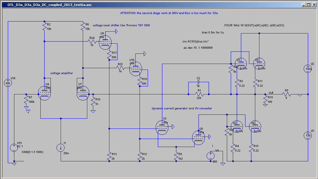

Full vacuum tubes DC coupled - first test
This is the first test on a DC coupled design with only vacuum tubes.
The circuit should be controlled in the next days, there are many factors to check before build it.
The output tubes must be disconnected from power supply in the switch-on phase.

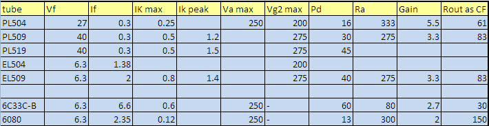

Output tubes - first data
Here some data about the output tubes to use in OTL.
Of course the aim is to find the tubes for a low output impedance and high current.

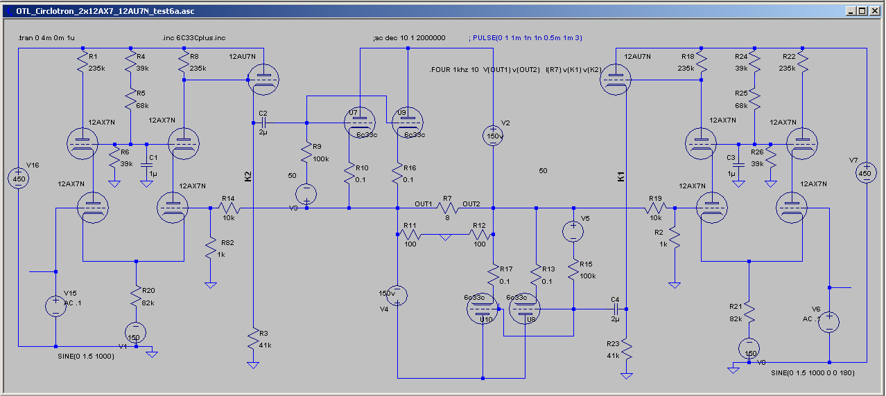

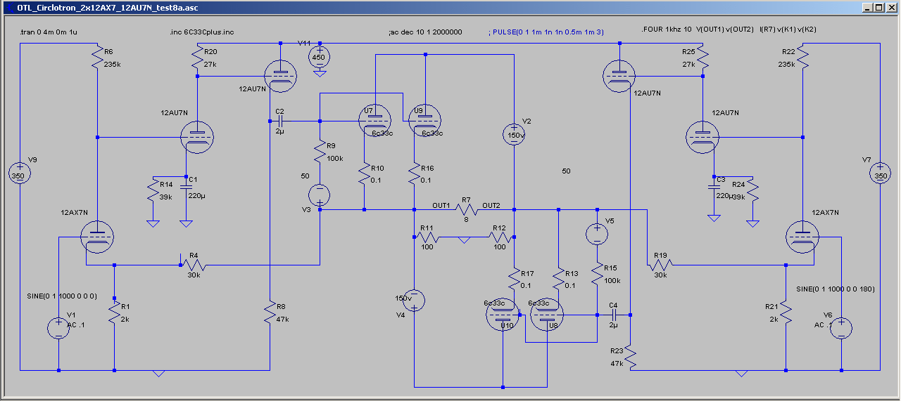

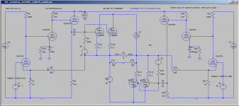

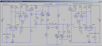

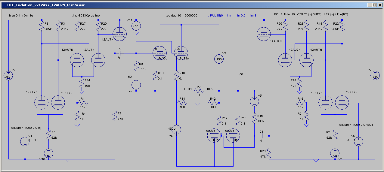

OTL Circlotron - first 3 circuits
Here the first 3 solutions to create an OTL Circlotron:
1) test6a - feedback 15dB - 50W with 1.6Vrms and 1.0% thd
only two stages and a single driver power supply but very low voltage gain
2) test7a - feedback 15dB - 50W with 0.7Vrms and 0.9% thd
3) test8a - feedback 15dB - 50W with 0.7Vrms and 0.7% thd
one more capacitor on the signal path
It is possbile use the 12BH7 tubes instead of 12AU7.

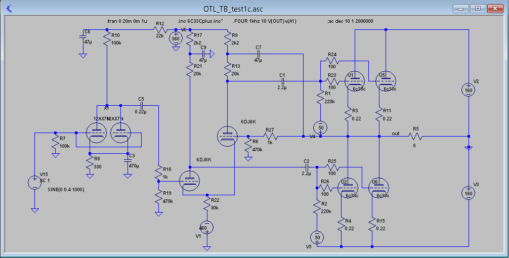

I want to try a configuration more or less similar to yours, but in a different way. My idea is to mix an Augmented Cathode Follower (Search in internet for it) plus a WCF as final stage, and with a gain of 10 or 15 times, to drive a 600 ohm headphone. Also split power supply. Output tubes are around a pair of 6S4, a pair of 6DE7 or 12W4. I have some of all them to try.
Hi Audiodesign !
Why you not try with 4 DC coupled CF triode driver , where each output 6c33c grid have associated separate DC coupled driver and in the same time separate bias pot, all that supplied from bipolar PSU .
With 4 DC coupled drivers you can easy avoid blocking distortion generated from 6c33c grid coupling caps , and in same time that solution is electricaly and sonicaly beneficial in many different ways to .
For example that`s the way how Atma-Sphere Novacron is done ,
later your input voltage gain stage can be designed and done in many different ways , depending only from question from what you prefer for .
Regards !

Interesting all those different possebilities 😎

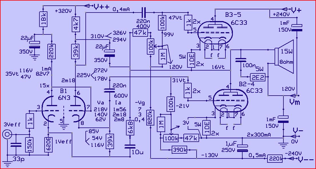

Let's play along,a sort of inverted Futterman.
Some positive feedback for a geater open loop gain and a bit of negaive feedback to calm things down 😀
There are suposed to be four 6C33 but the drawing shows but two ,makes it more open.
It's only a wild idea,after someone asked "what is there to do with Russian tubes"
Mona
Mona
