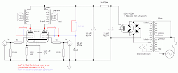

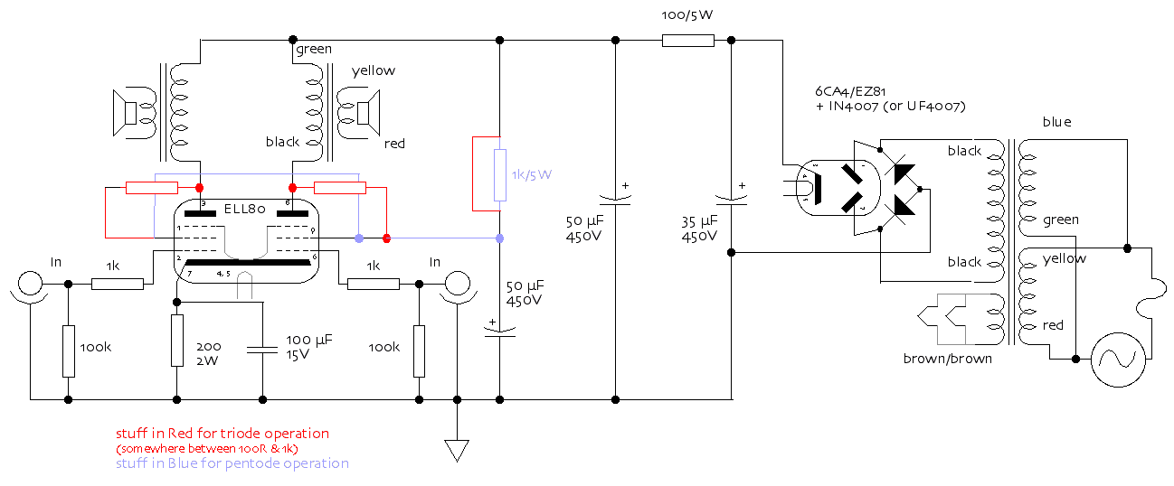

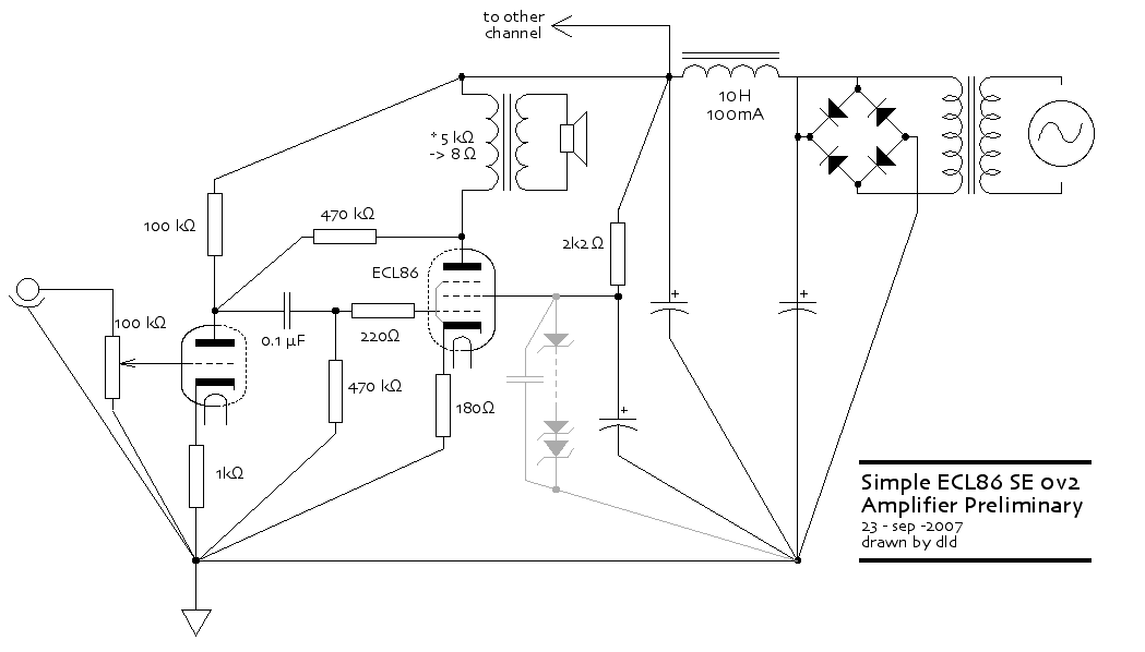

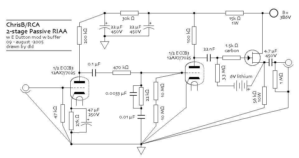

I agree on the schematic capture UIs...
VW has a bunch of features that make drawing schema a pleasure... rubberband lines can be a blessing and a curse, i'm happy to live without them. VW comes with a tube symbol library, but over time i drew my own,
Attached are some examples of drawings i've done
dave.
