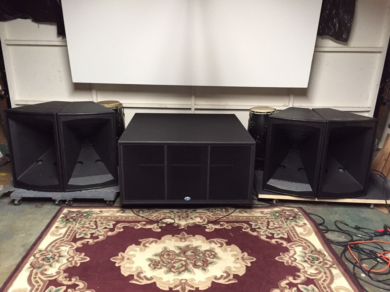

Well, I just let my friend borrow my pair of xoc1 th18 (v1, no cone correction), as he just received a pair of th118 from danley for testing. My cabs are 18 nlw 9601 8 ohm loaded.
I had work today so u was unfortunatly not able to attend.
No measurements were taken, but I immediatly received a txt to tell me that subjectively "the danley are much cleaner" I am unsure if his danley are 4 or 8 ohm cabs
Sine143, can you give us some more feedback on the comparison, especially the output, SPL. Is one noticeably louder than the other or would you say the difference is hard to detect?

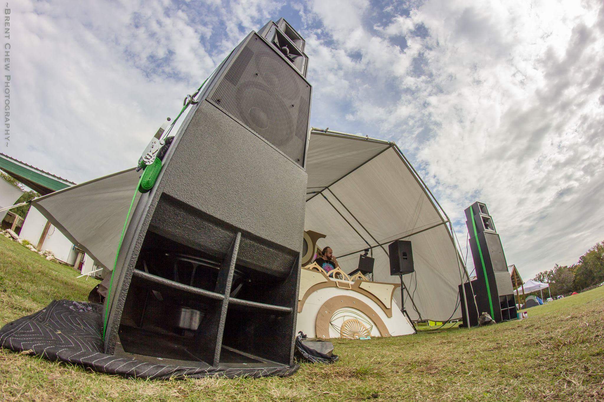

A sound engineer/avid user of 4-12 (and a few times 16-32) TH-118s used my (4) 18SW100-loaded TH18s for an outdoor event and reported back that he couldn't tell much difference in output nor quality. There was no A/B testing involved. No testing equipment that I'm aware of. Just usage and his memory. Take it for what it's worth 🙂

like to hear more about this oneQuick post before bed, after a long two weeks:
Four of these are closed up, loaded with B&C 18SW115 and making floors flex. Yes, there's more bracing throughout. More pictures and impressions later.
