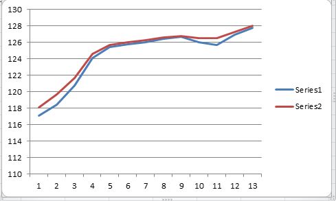

The graph you posted doesn't mean anything. The horizontal axis is labelled 1 - 13, there is no legend explaining what the red and blue lines mean, and there is no information about what is being measured (or simulated - or whatever is going on here). No information about measurement conditions (if this is a measurement), and no way "cone correction" provided that boost in the low end, if that's what this graph is intended to show. Even if "cone correction" was responsible for this boost in the low end (it's not - see Ricci's measurements) it wouldn't matter because the only place there's more than 1/2 db of difference in the low end is clearly below tuning and would be filtered out by the high pass filter.
Hardly. Just trying to demonstrate a concept (zero s2) that can be difficult to visualize without a drawing.Zettairyouiki drew a Danley TH118 line drawing - You don't believe him?

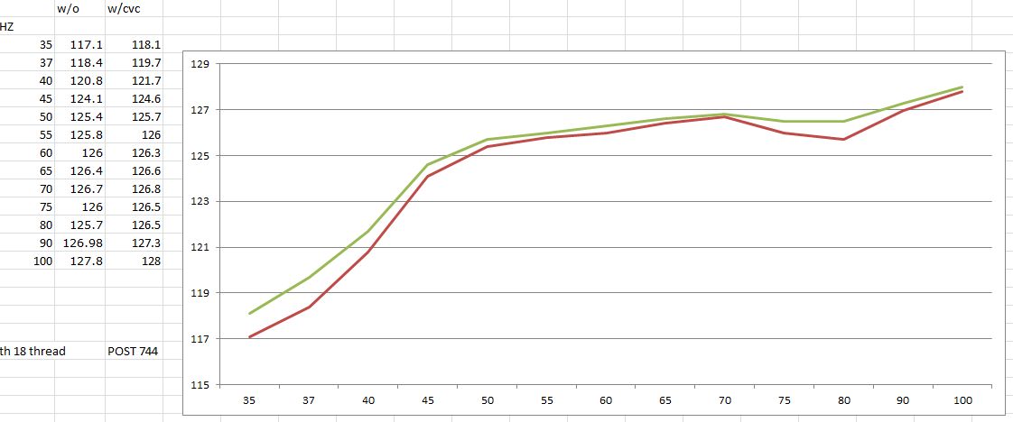

PASC posted a link to Post 744 in the TH18 thread
http://www.diyaudio.com/forums/subwoofers/190635-th-18-flat-35hz-xoc1s-design-75.html#post3146783
In this CRESCENDO reported positive effects from adding more S2 compression to the TH18.
The TH18 does benefit from more compression. It is difficult to simulate this, unless the cone correction curve method is used.
Hornresp can be use to simulate a different shape but it means making the rest of the horn far more inaccurate in order to see the effects in the area of interest.

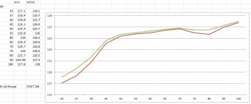

Screengrab is same data but with Hz axis. Red is without cone correction green is with. Is that clear enough?😛

Clear enough, but clearly not correct. There's something wrong here. Either in the measurement conditions, driver conditions, or something else. This just isn't how it works. Look at my pictures above, do some sims of your own, and you will see that there's something very wrong here. Even if there wasn't something wrong, the extra db on the low end is completely useless, it's below tuning and will be filtered out by the hpf.
