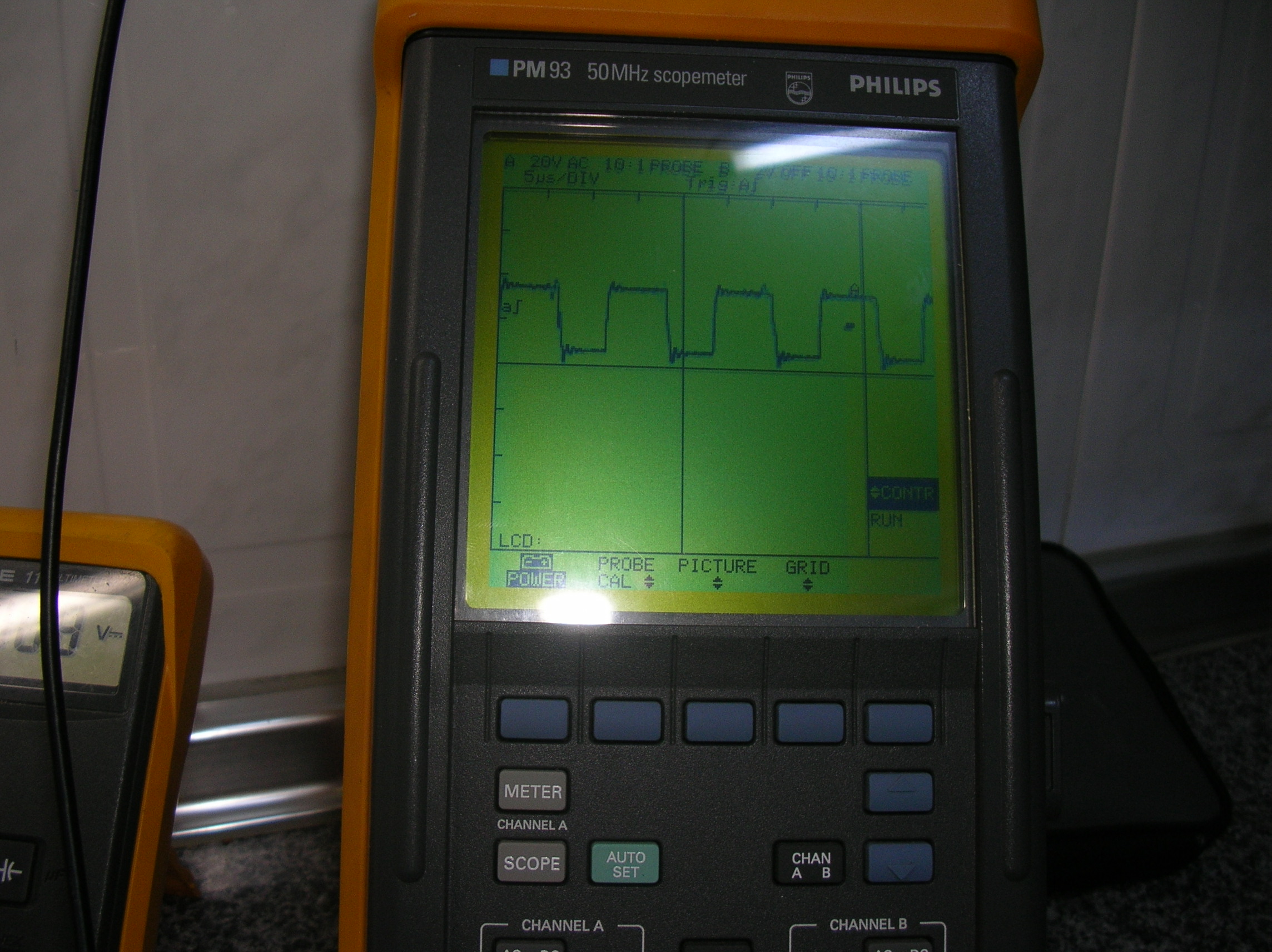

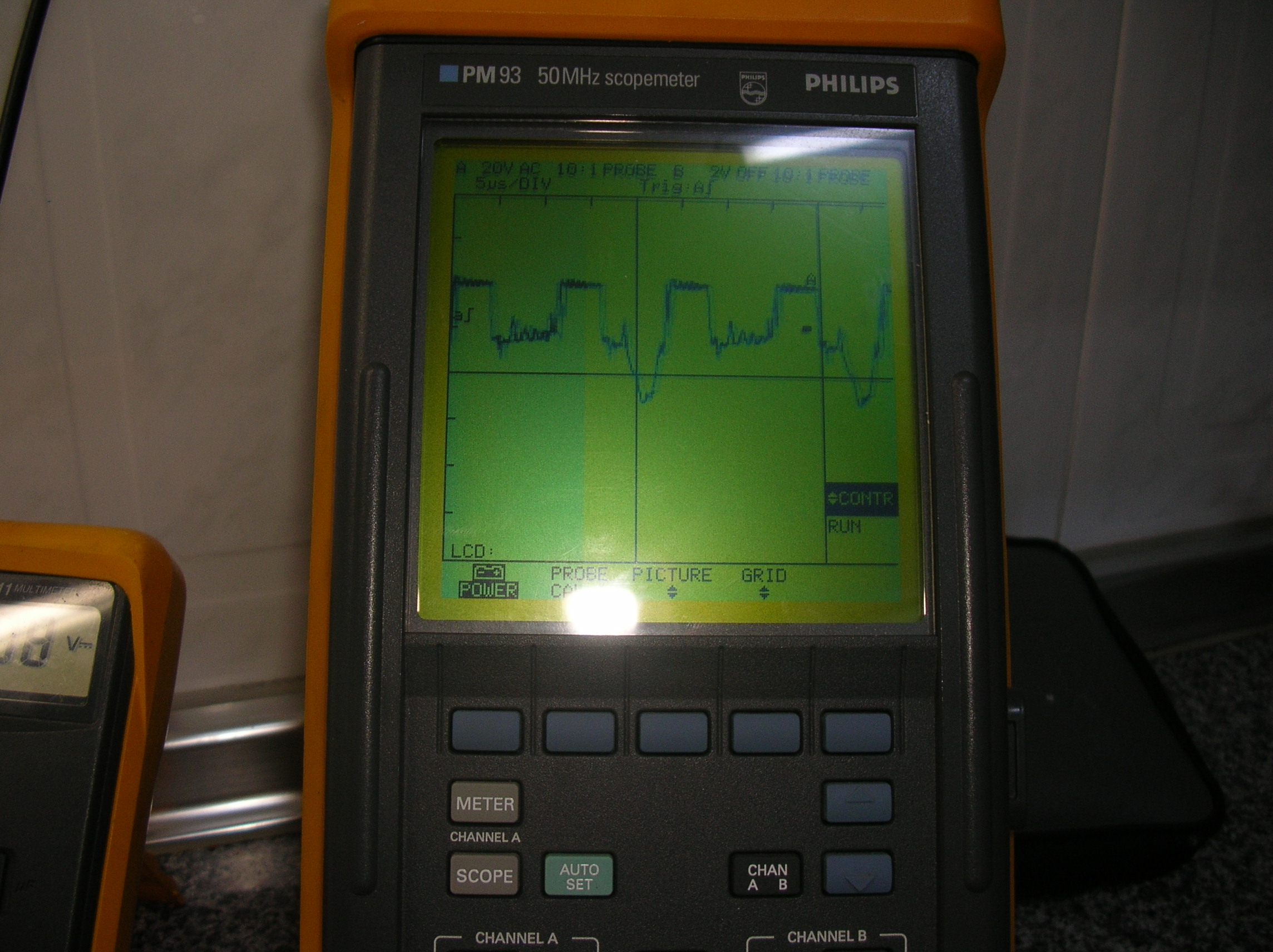

The first photo is the square waveform corresponding to pin 1 of U10, and the second picture corresponds to pin 1 of U6
The first picture, makes a triangular ridge, ranging at the bottom of the square wave, and the second picture, no.

I checked the waveforms, contrasting with other amplifier bd other works properly, (one T1500BD) and look good, therefore, this oscilloscope (philips-fluke) seems to work well.

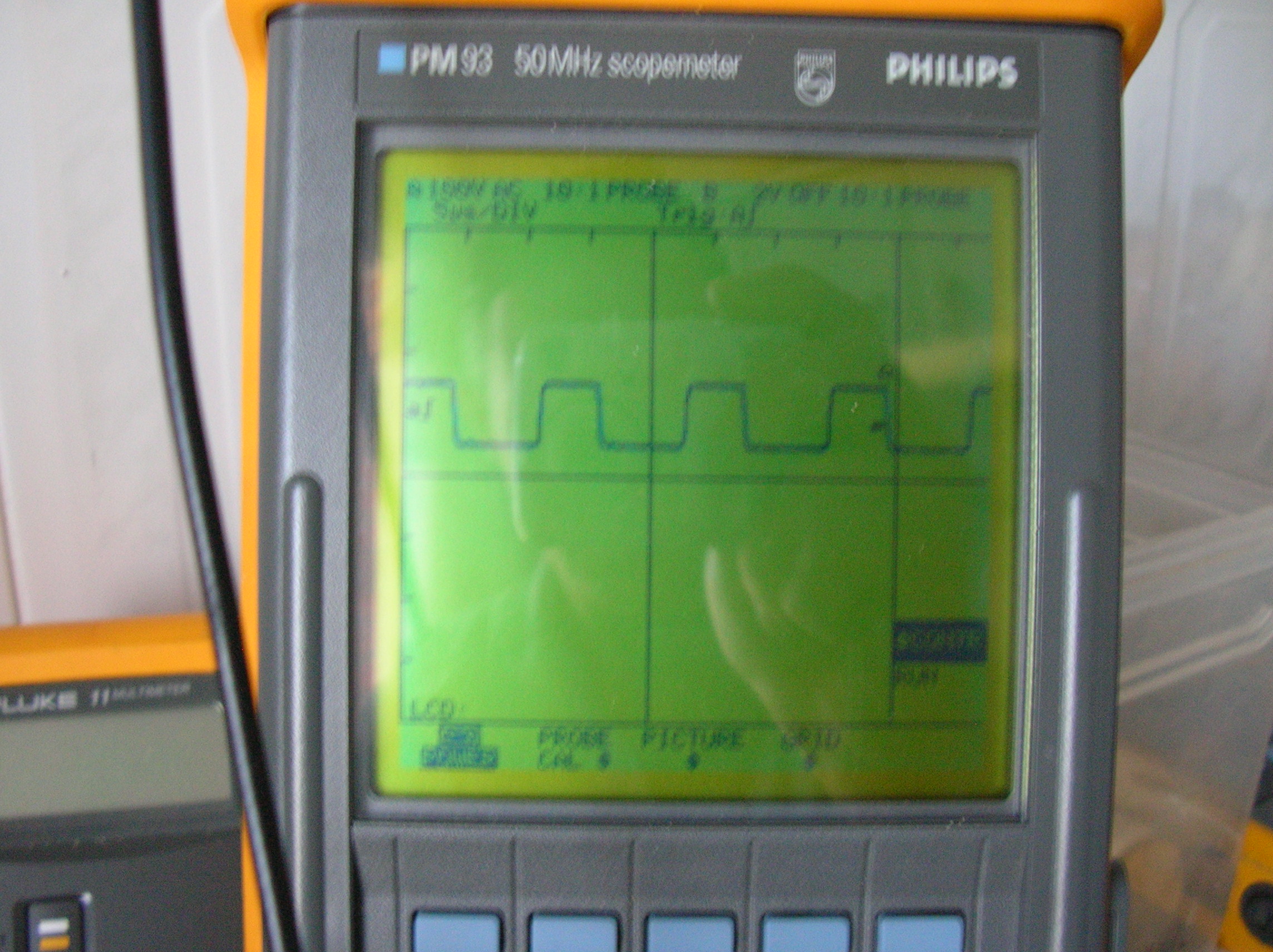

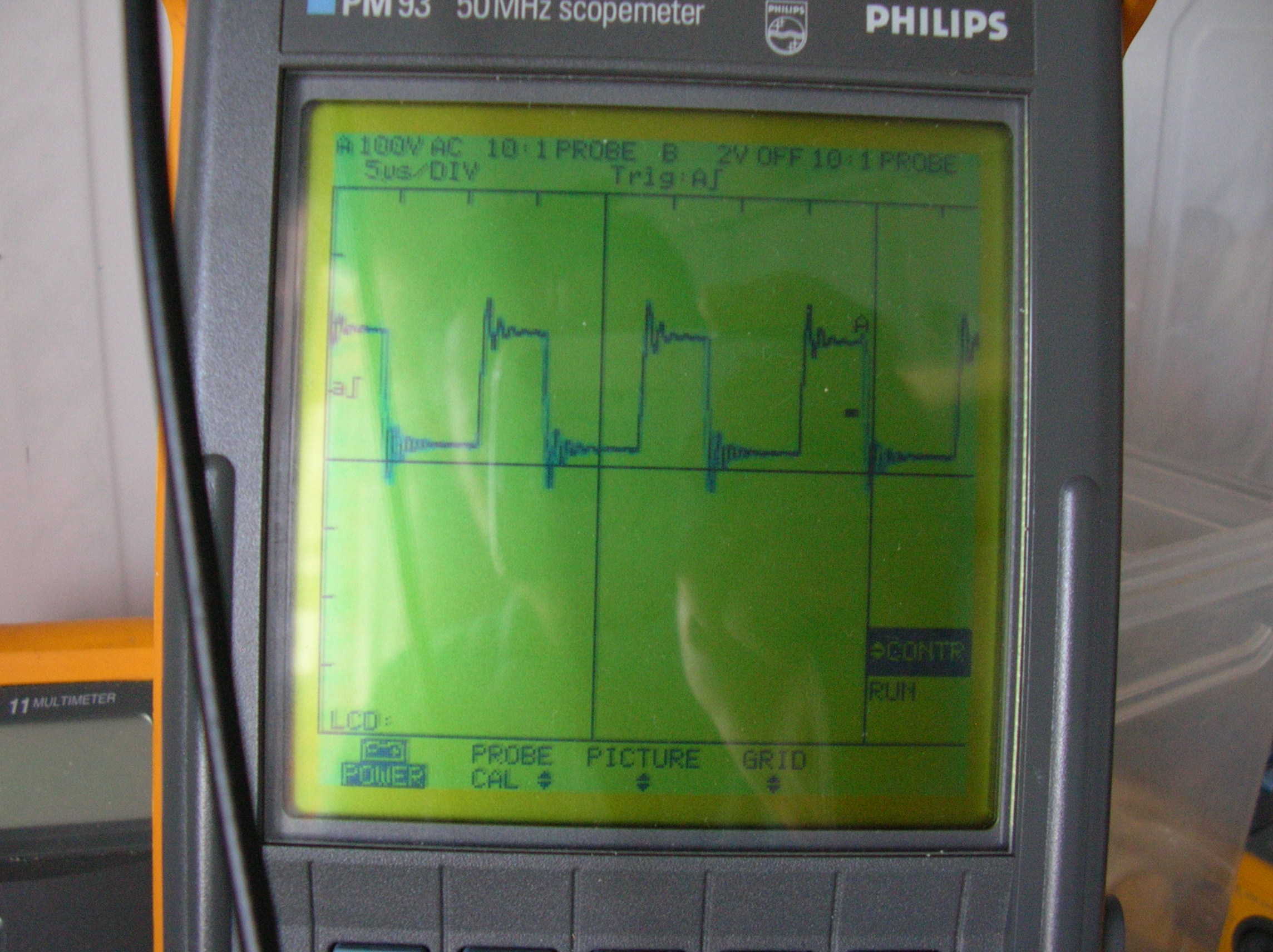

Well, Perry was right, I did not well adjusted the oscilloscope, in their correct settings.
Once this is done, the Square waveforms look good, all FETs that stage, were replaced by new ones.
