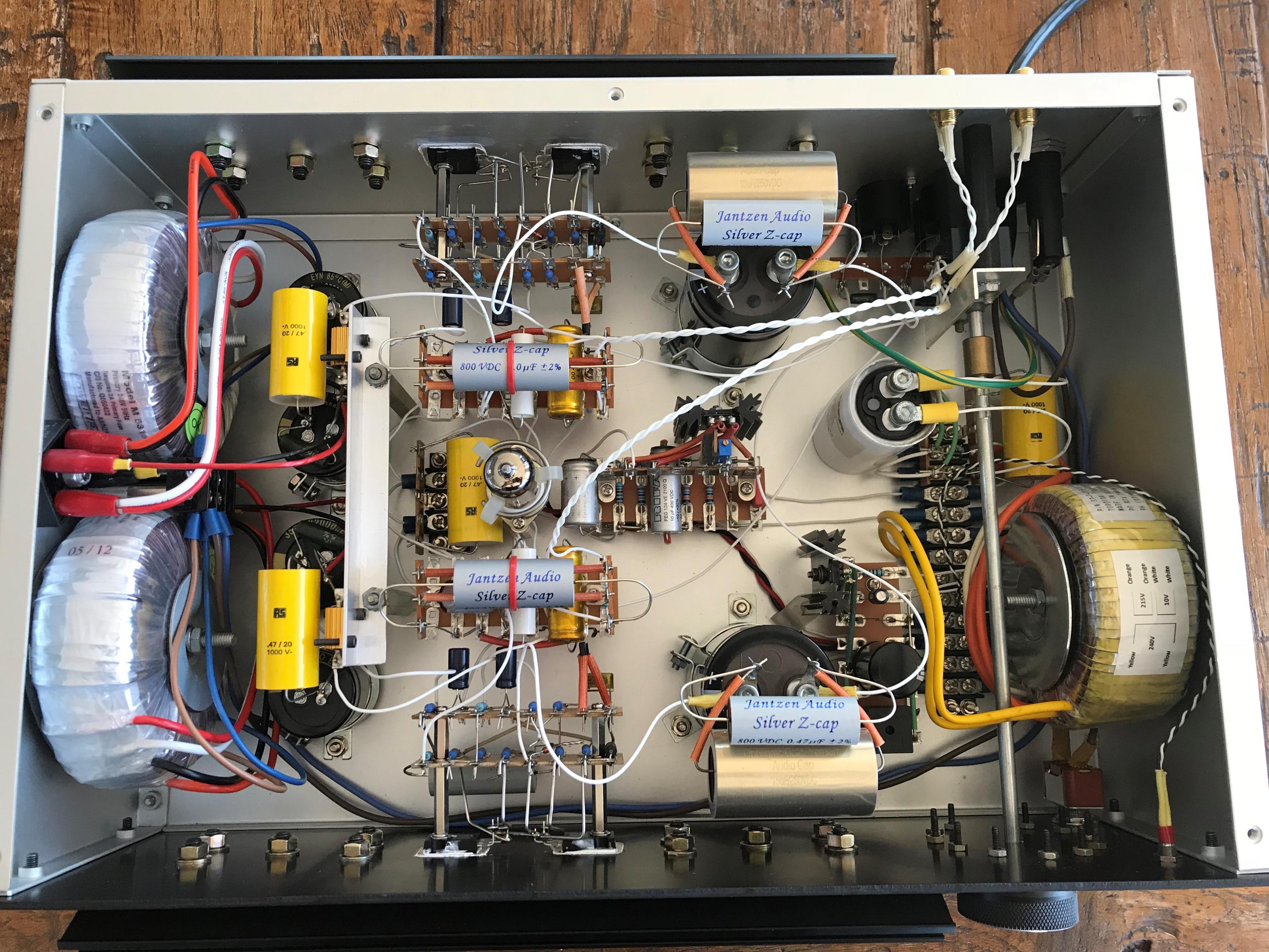

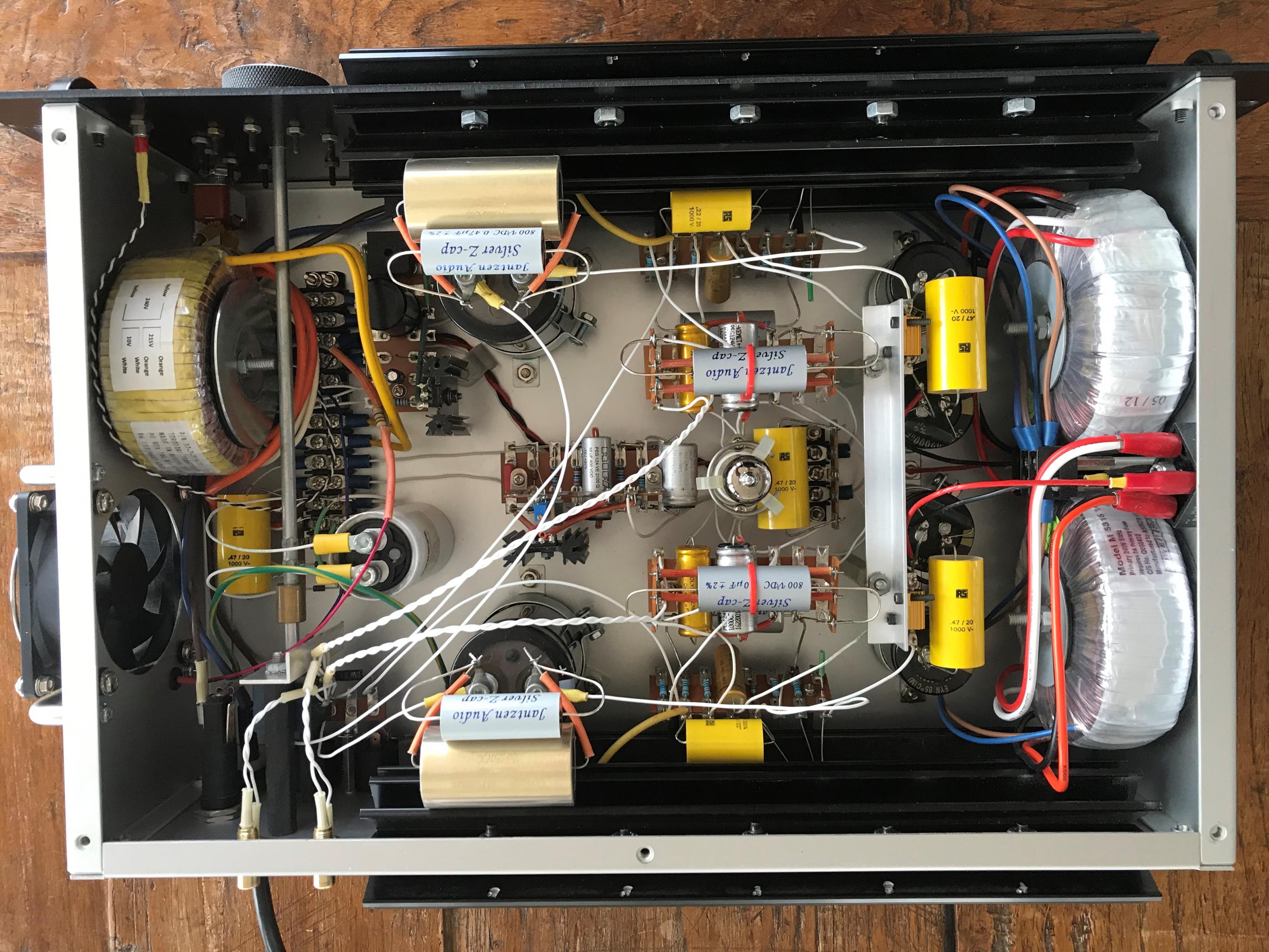

Hi ,
Here we go again , my Amp has been upgraded , and now it looks like this :
The first version of the 10 ohm resistor burned out , so I have put a 100 Watt version . I also added a second transformer and
fast rectifiers bridges on each channel .
The sound is still a delight !
@ + Philippe.

Hi guys ,
I put some pictures again from my device :
attachment.php
@ + Philippe
