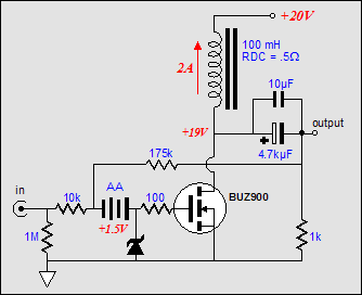

Mads,
I never made any SS amp but this is so simple for start
Here is the article :
http://www.tubecad.com/2004/blog0005.htm

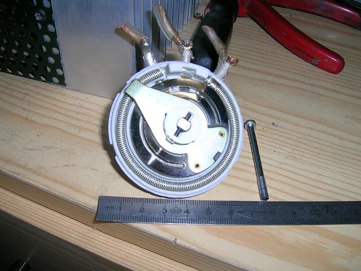

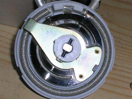

Hy there ,
I 'm back to give you news of the OTA “improved” Amp.
First of all, I recovered the R-Core transformer of an IGBT amplifier project . This transformer has 2 separated secondaries , whereas the old one comprised one of them, moreover I had to wind whorls with the secondary to obtain the required voltage.
Now i was in order to separate completely the both power supplies chanels , dedicated ground circuits , by taking care to avoid ground loops while wiring . The ground of each oh the 2 amplifier circuits is taken directly on the 2 electrochemical caps downstream, of stronger value than the first (33.000µF against 22.000µF). I also added a connection by screw & bolt on the IRF150 for the maintenance actions.
Small aesthetic relooking to finish on a wooded note.
It now remains to me to listen to it to drip the differences.
Best regards ,
@ + Philippe.
Best regards ,
@ + Philippe.
