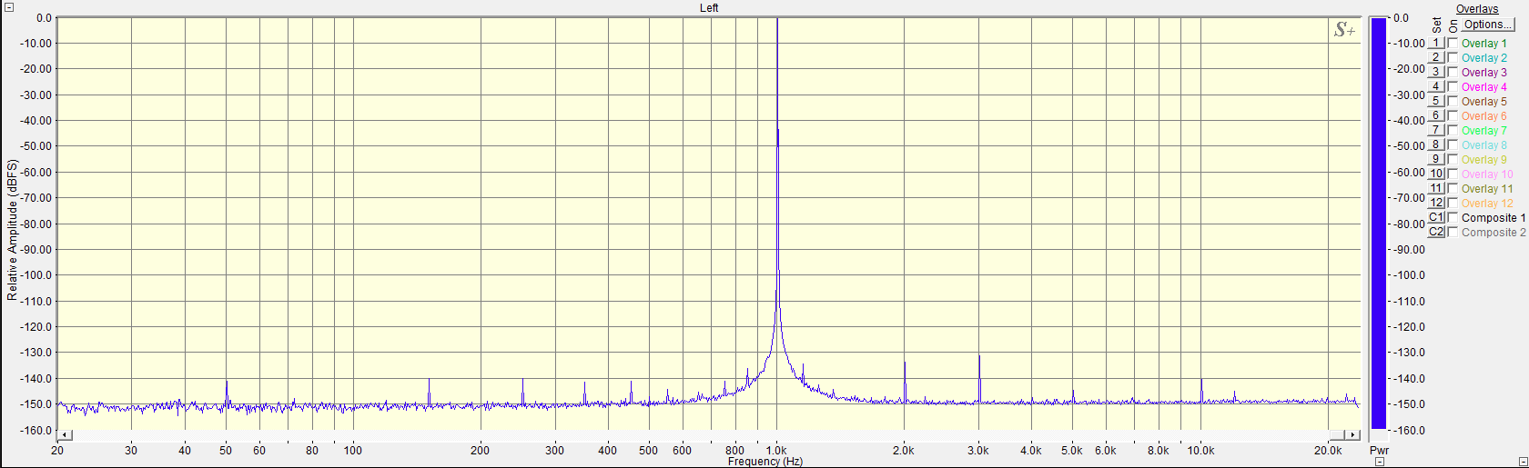

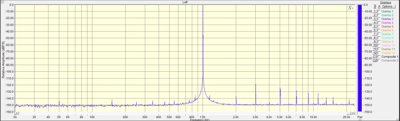

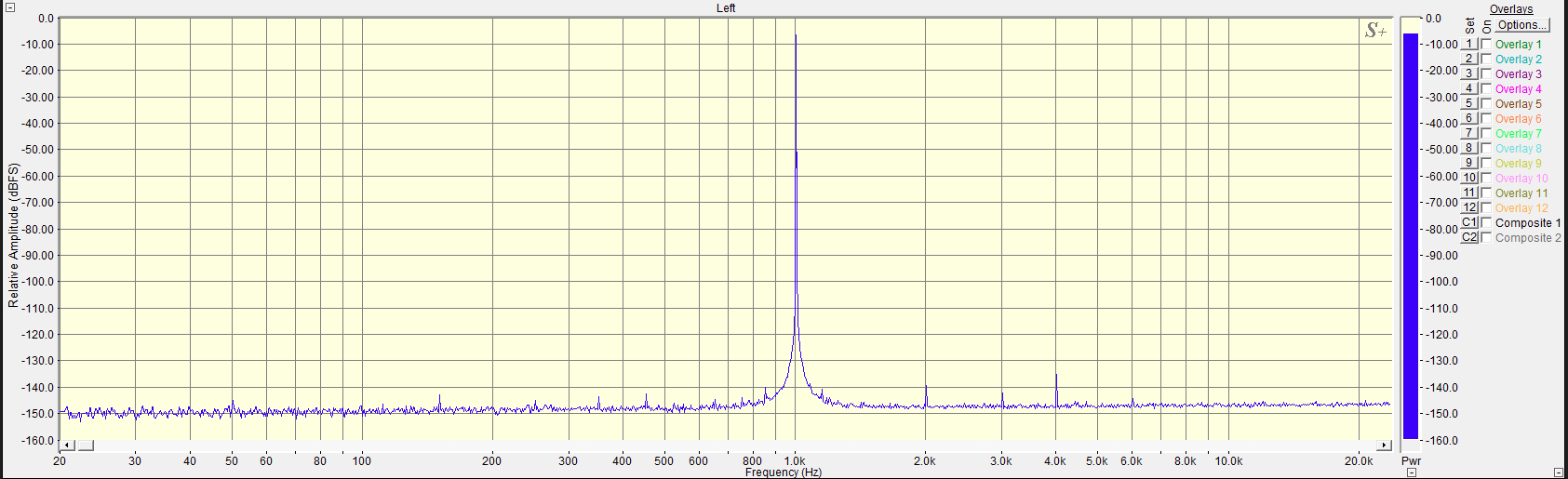

Hello, Frex. I want to understand how did you get so small THD from this ADC.AA2380V1 first THD mesurements
Hello all,
I made some first measurements on the AA2380v1 ADC board of the OSVA.
I made them using the combo AA2380 ADC board and AAPSU01 power supply board.
The source of power is a 12V Li-on battery pack that supply AAPSU01.
I used my EOSC10Kv3 ultra-low THD in differential mode to send it to AA2380v1 input.
The full setup is show on pictures below :
FFT results are below (lin and log scale).
Results are consistent from what i had with modified EVM.
The FFT spectrum is amazingly clean, with no spurious other than THD product itself.
The lower frequency band show absolutely not any trace of main supply ! (no hum noise).
Note that there is no FFT averaging.
The THS4541 input buffer seem promising, but as the input stage can accommodate others, I will try them (ADA4945-1 and OPA1632).
Frex

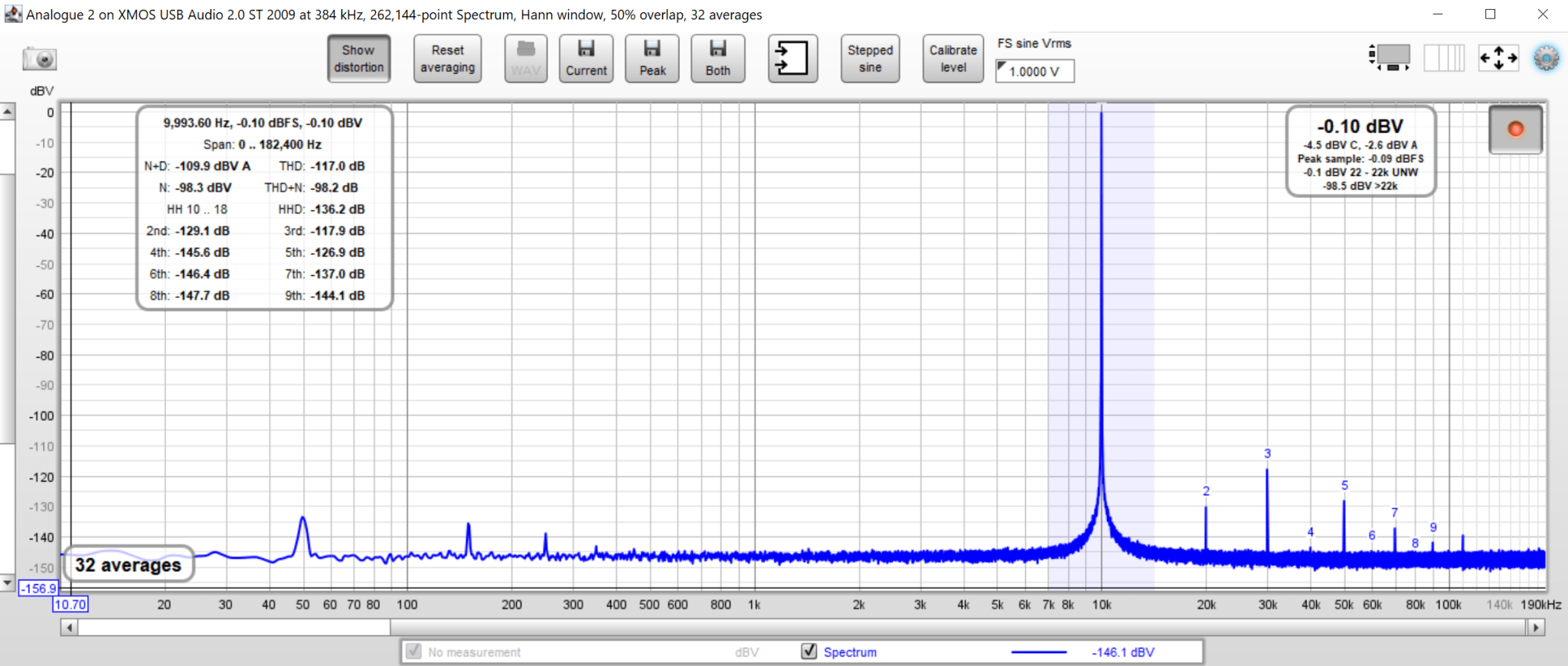

My best result is -117 db (like it's mensioned in datasheet).
Hello Painmailer,
Firt, all measurements I made has been done without any sort of compensation.
Can you point me from which measurements from me you compare your own measurement ?
(you seem to get already a very good THD level).
Maybe you can gave us few more about your design, and also your THD measurement test setup.
Designing an ADC that can get less than ppm level THD is hard to get,
but measuring this level of THD with confidance is it too !
So to try to help you, explain all your detailled test setup,
and if possible post the ADC front-end schematic.
Regards.
Frex

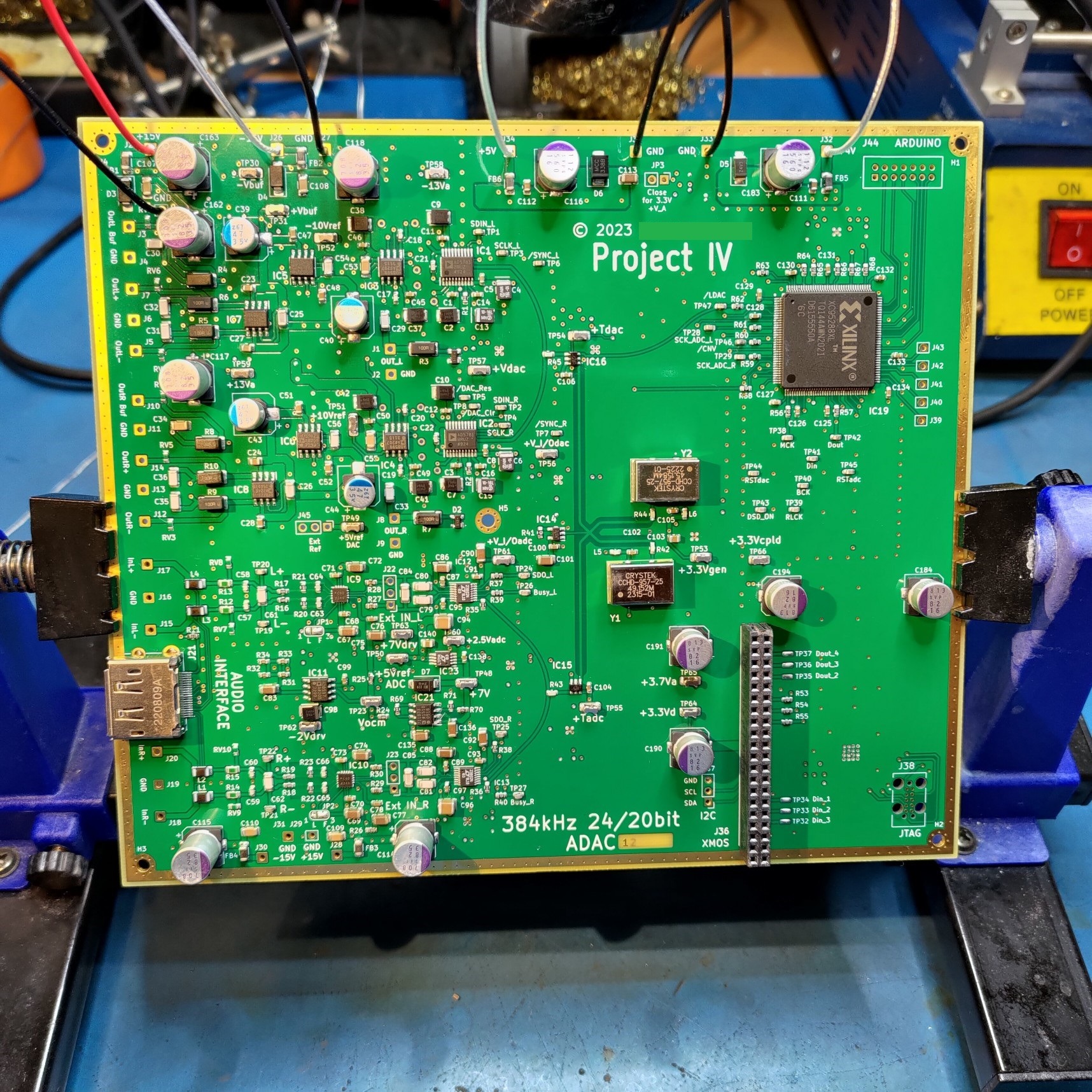

Hi folks, hi Frex.
Hope this project have have not died.
Recently I have finished my own project - high performance USB stereo audio card with ADC based on LTC2380-24 chip and would like to share my tips and experience.
I have used similar to original Frex schematics with ADA4945-1 drivers but with fixed 384kHz input filter.
ADA4945-1 is quite tricky to use and here are my tips:
The measured performance is corresponding quite well to datasheet figures.
And thanks to Fred for his beautiful low-distortion generator, it's quite a piece of gear!
- Connect chip pad (pin 17) to -V pins;
- While designing PCB, clear all GND layers from copper under input and feedback components of the driver;
- As I have found (the hard way), that accidental short of +V bus to the ground leads to driver chip failure with dead short between +V and +VCL pins. And in my case +VCL was directly connected to +5Vref bus, so +V voltage (7V in my case) was applied to ADC Ref pins. ADC chips survived, but it's highly advisable to put 5.6V protection zener diode on +5Vref bus.
- I have used single +Vocm buffer for both drivers, but put 100R resistor between each driver and buffer output.
