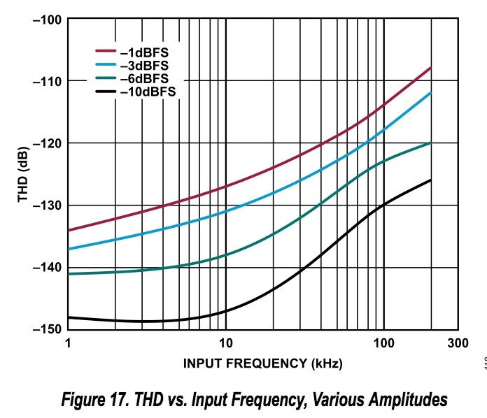

It is perhaps a bit late to consider a change of the ADC ... but the new AD4030-24 SAR ADC looks even more interesting than the LTC2380-24.
