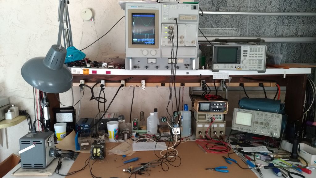

Hi busaboy,
Nice setup. You are testing things exactly righ, so you will live to use your gear for a long time to come.
What scope it that on top of the HP power supply? WHat power supply is that?
-Chris
-Chris
-Chris
Tektronix DSA-602A Signal Analyzer. It's an ancient beast that offers a bunch of nice plugins and has 2 GS/s rate. Old style optical X-Y touch screen. I used to use a Tektronix 11801C at work and got used to the arcane interface.
PS is an old Lambda. I have a bunch of them. Easy to fix.
