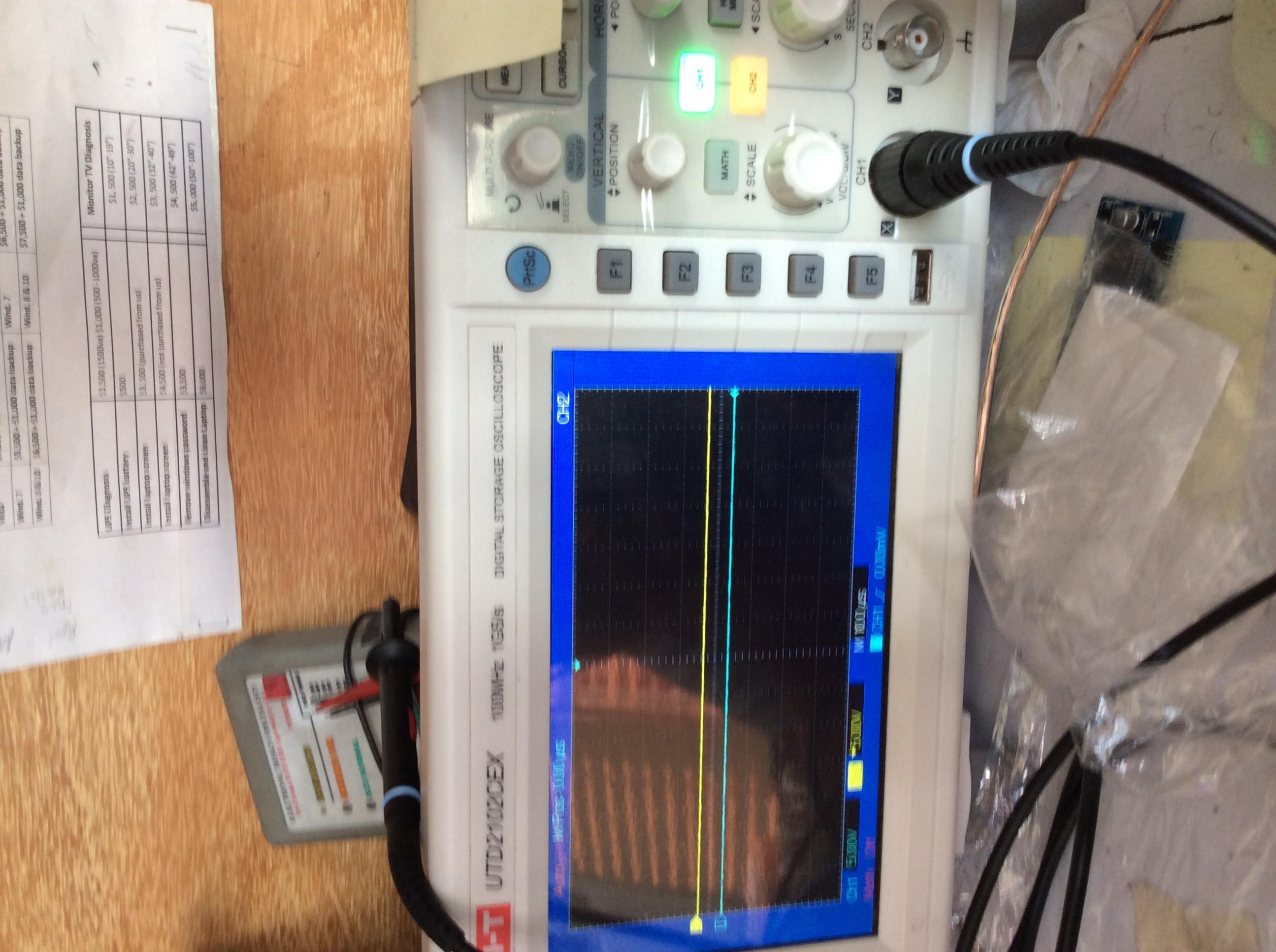

My main reasons is just to check for various waveform in pwm circuits in switching psu, AC-DC converters, office rated UPS (non commercial) and non industrial equipments (military nor medical).
I have an isolation transformer that I can use for my DUT’s but I want to be able to probe hot circuits (with added personal safety) but not the fear of breaking the instrument or worsen the job.

Do you realize that I suggested using the scope in differential mode with 2 channels and no ground connection to the device?
The scope needs a reference. Generally, that is ground. In differential mode, the reference is the other probe. Anything that within the range of the scope's input is safe.
Again, the ground of the scope is NOT used. The second channel input (center conductor, not ground) is the reference.

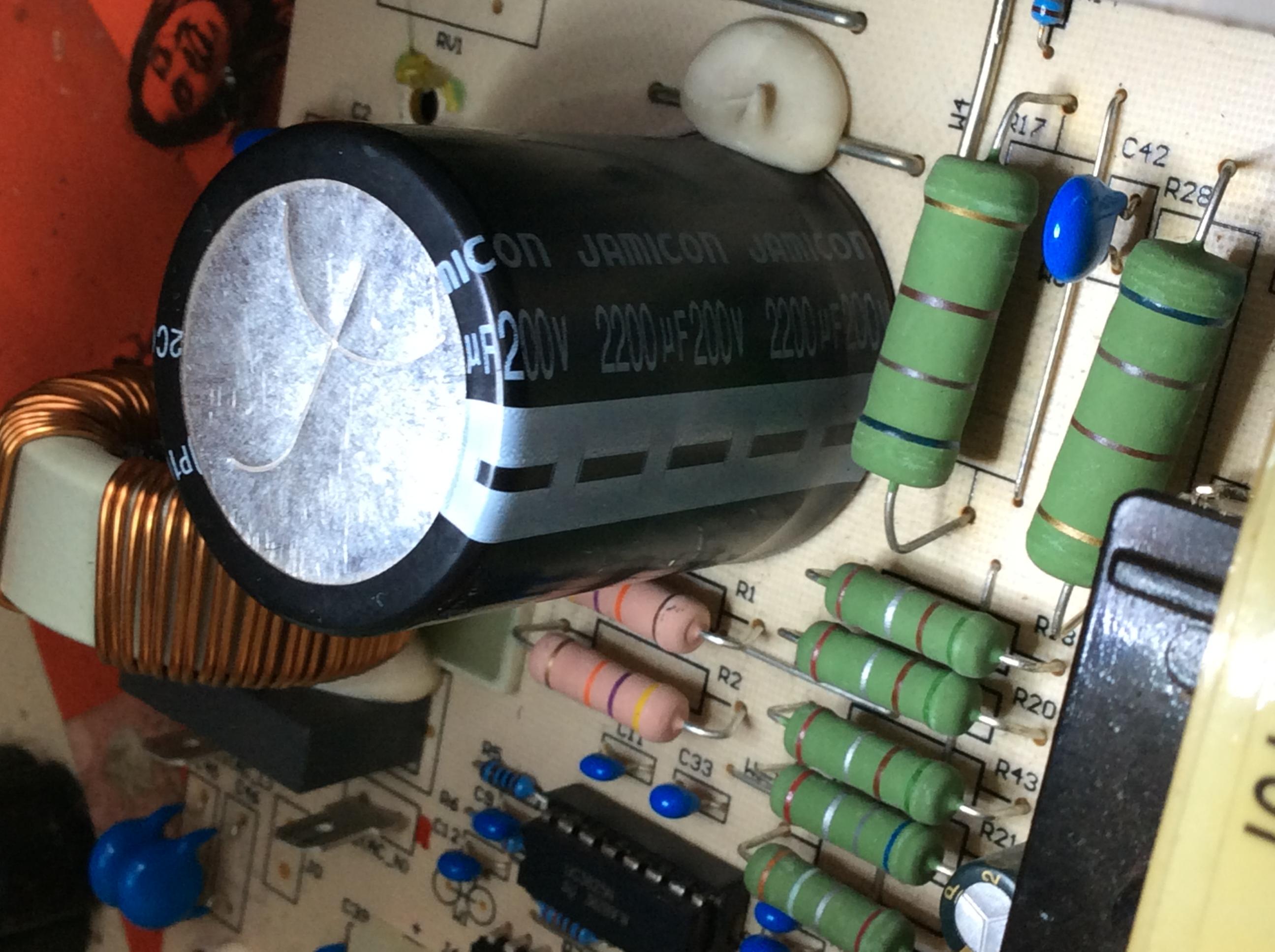

What's the highest voltage in the device? Across the main filter cap, across the rectified mains, I'd guess.
I haven’t energized the device it’s a RV charger 120vac-12vdc 80amp. The filter cap is 200v 2200uf, (I’m guessing about 160+ across).

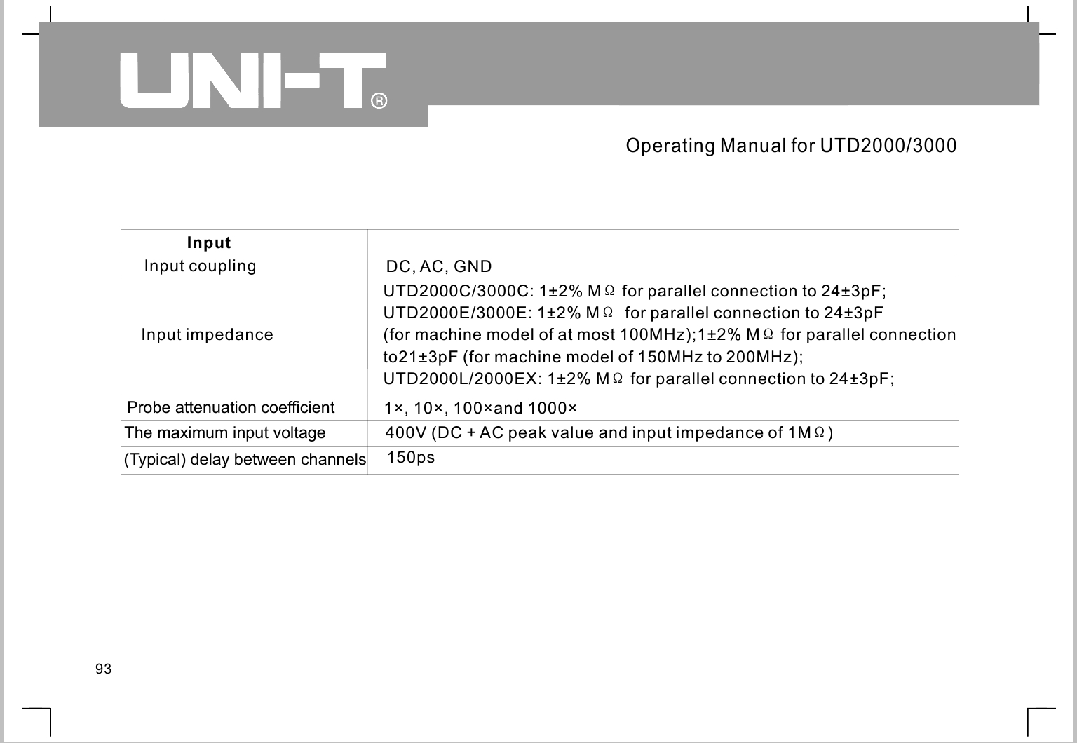

Is it that if connected the scope and I try to inspect the or a waveform by decreasing my volts/div the scope would break?
You will be using the probe at 10x. In that position, the probe inserts a 9.09M ohm resistor in series with the scope input. The input has protection against overload. That protection and that 9M resistor will protect the scope.

How large would be too large, and will it break the scope if I try to inspect a large volt or waveform?
Hi Formas,
Well, the wrong range wouldn't do the inputs any good, depending on how serious the overload is. But you would find the circuit would saturate and you wouldn't get a usable waveform. So it is a pointless thing to try (don't).
In a nutshell, if you can use the probes (X10) on a range where there isn't any clipping, you can subtract one for the other (on the same range). If you need to see the difference amplified, you will then have to use an isolated, differential probe. Just remember that you can't remove the safety ground, and you can't overload the input amplifiers and get any useful information.
