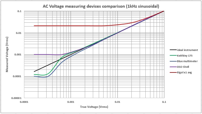

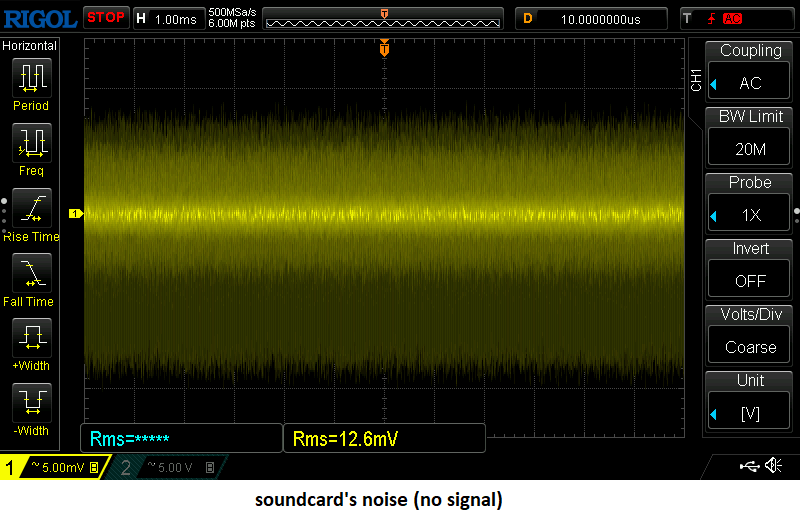

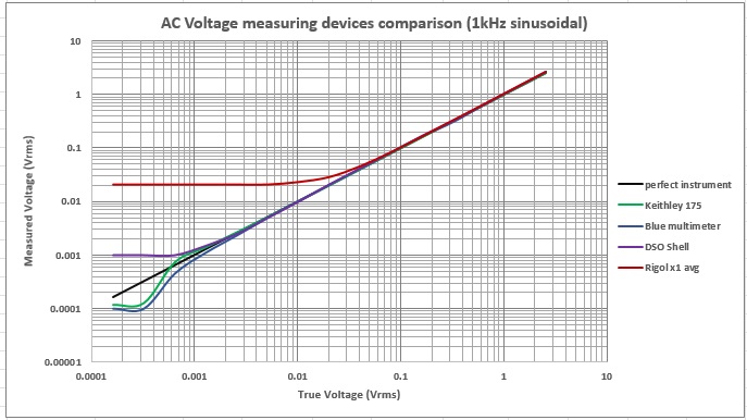

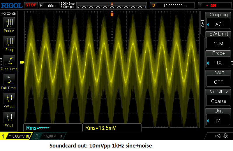

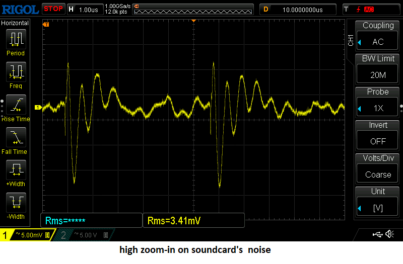

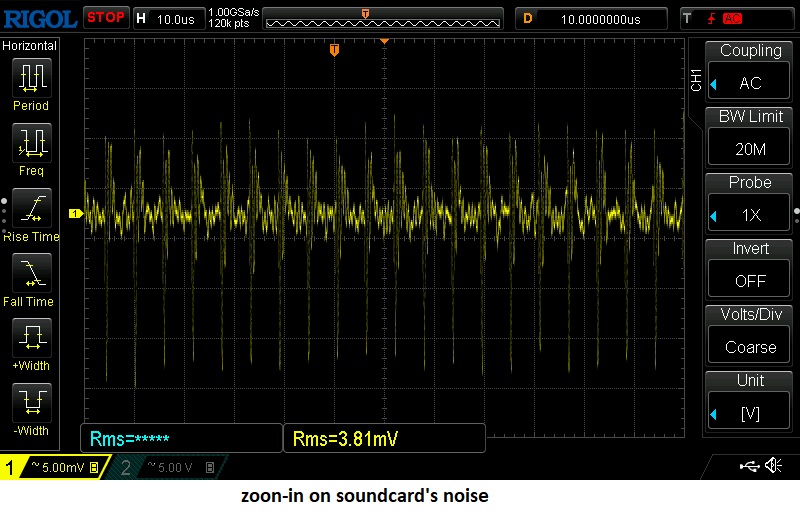

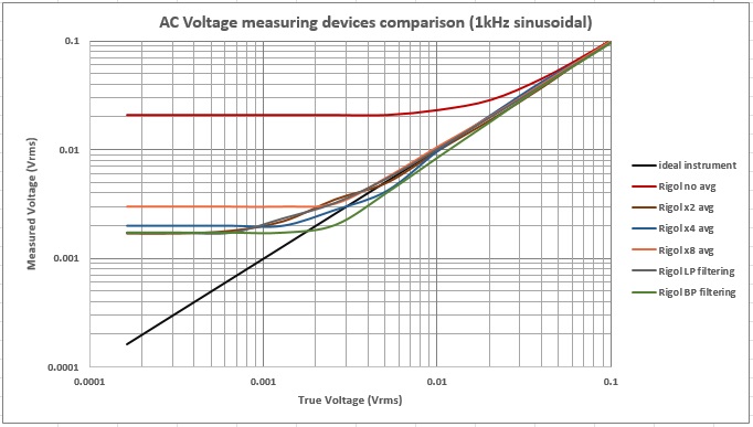

When it comes to measuring the amplitude of noisy low level audio frequency signals, please check out the amplitude read-out of the oscilloscope, it may provide erroneous results.
I was checking the measurement readout of my 8 bit Rigol DS1202Z-E using the output signal of my sound card (EMU-0404) as the signal source.

Good point. What was the impedance of the load?
I would like to learn more on this, especially as DSOs throw a lot of "data" at you, the key is understanding what is good data and what is bad. I've already seen the front end amps distort signals based on offset.
I've worked with metrology folks (national physics laboratory) and the discussions around subject of measurements (in this case optics and electronics) means I'm happy to admit my very kindergarten view 😀
Source was 150 Ohm. Load >10 MOhm.Good point. What was the impedance of the load?
Always, regardless of all the bells and whistles modern DSOs provide us with.the key is understanding what is good data and what is bad.
One way is to have control over the signal you want to measure.
In the case I showed above, I verified that the signal’s noise level was fixed regardless of the sinusoidal signal level. Then starting with a high signal level, I was reducing the signal level in steps of 6dB. As long as the measured value followed the 6dB drop law (halving of the voltage at each step), measurement was reliable.

Below 1 mV there are several things that contribute to the uncertainty of your measurement. Noise, measurement resolution of the instrument, stability of everything etc. Measuring small AC signals is difficult and the best suited instrument is a wave analyzer. A spectrum analyzer is second but checking it when you are at the bottom of its range is tricky at best. Most RMS converters are not specified for accuracy below something like 1/3 of the range which probably explains the Keithley result.
Most important is to not believe any instrument blindly. Crosscheck or verify because its easy to miss a detail.
