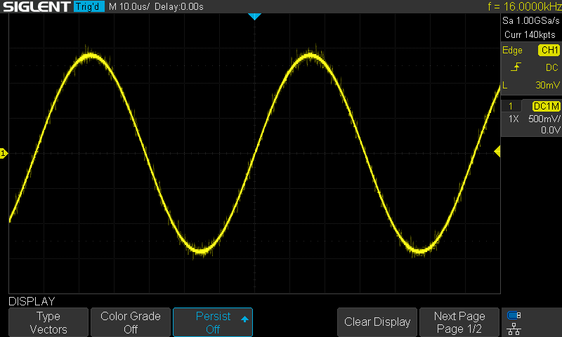

That's useful Nick. Your showing only 500Hz there and the sampling is very clear to see if you look closely.
Also what are all the other things. On analogue you would look at that and say the signal source had HF instability but I'm guessing here those are display/sampling artefacts and not present in the original... or am I wrong on that?
If that sine were at say 50kHz or 500kHz would it look even more 'quantised' or not?

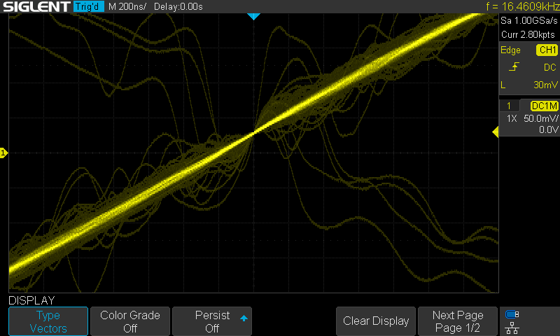

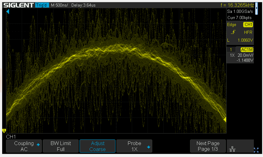

I can zoom in to the top of one of the waves without a problem - the scope will go to 500uV, but I wanted to show the curve of the wave. The screen is better than the web browser screen shot:

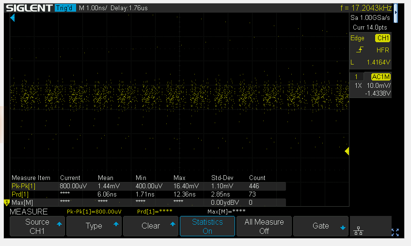

The main issue is when you run/stop as there's no sampled data other than the samples it's got already.
Zoomed into the top of one of those peaks at about 6.15ns:

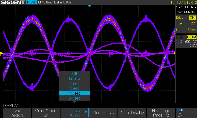

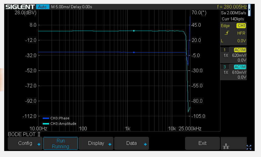

An a software program running as an AWG being controlled for a bode plot of the Mac mini headphone Jack - not massively accurate but free:

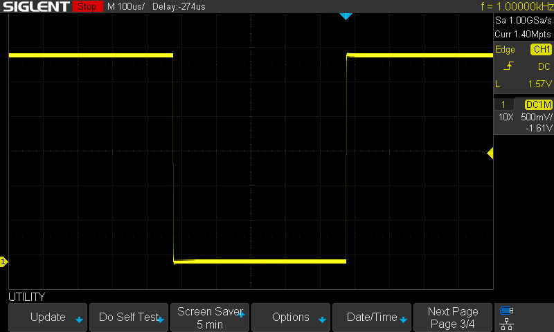

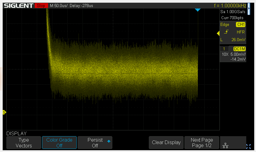

So some direct scope captures on USB sticks attached showing the screen resolution with vectors rather than dots on.
One of the big things you get with a better (and £$€) is a higher resolution screen. I'm not defending the capabilities of the 1104 nor excusing any of speed performance.

Lastly one - just to show the 8bit depth limit, this on the 1KHz set with 10x probe, you can see the lines of what I assume are the voltage levels on the ADC:
