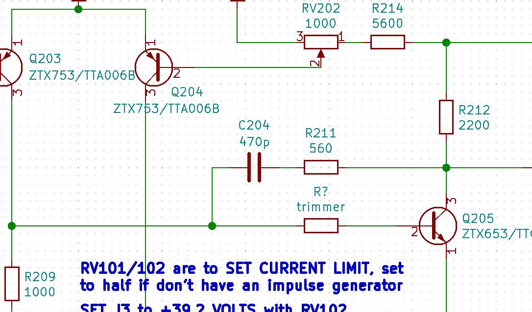

for stopper i put a resistor on the base but how many ohms ? 10 ? 100 ?

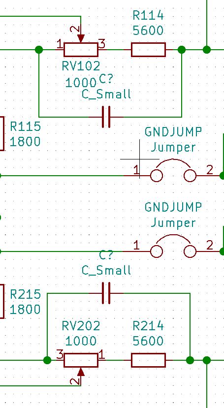

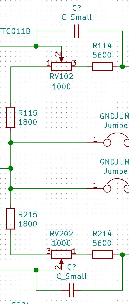

I was able to test it with ceramic capacitors on R114-R214 using the wipers It's better than MKP style.
I also slightly modified the resistor values of the RC circuits.

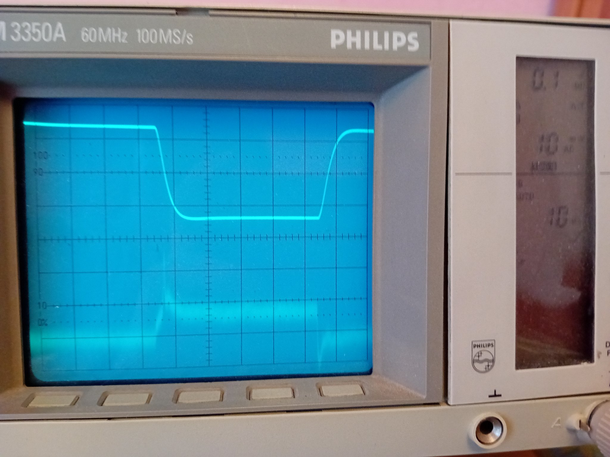

Here it's with a 100pF capacitor, but with a 200pF capacitor, I only have a maximum oscillation of 10mV instead of 14-15mV.
This is on the negative rail; we still see minimal oscillation.
On the positive rail, it's almost perfect.
If I increase the power, there's no instability or more oscillation. I've tested it at 1.6 volts at the input.
To go further, I'll have to solder them directly.

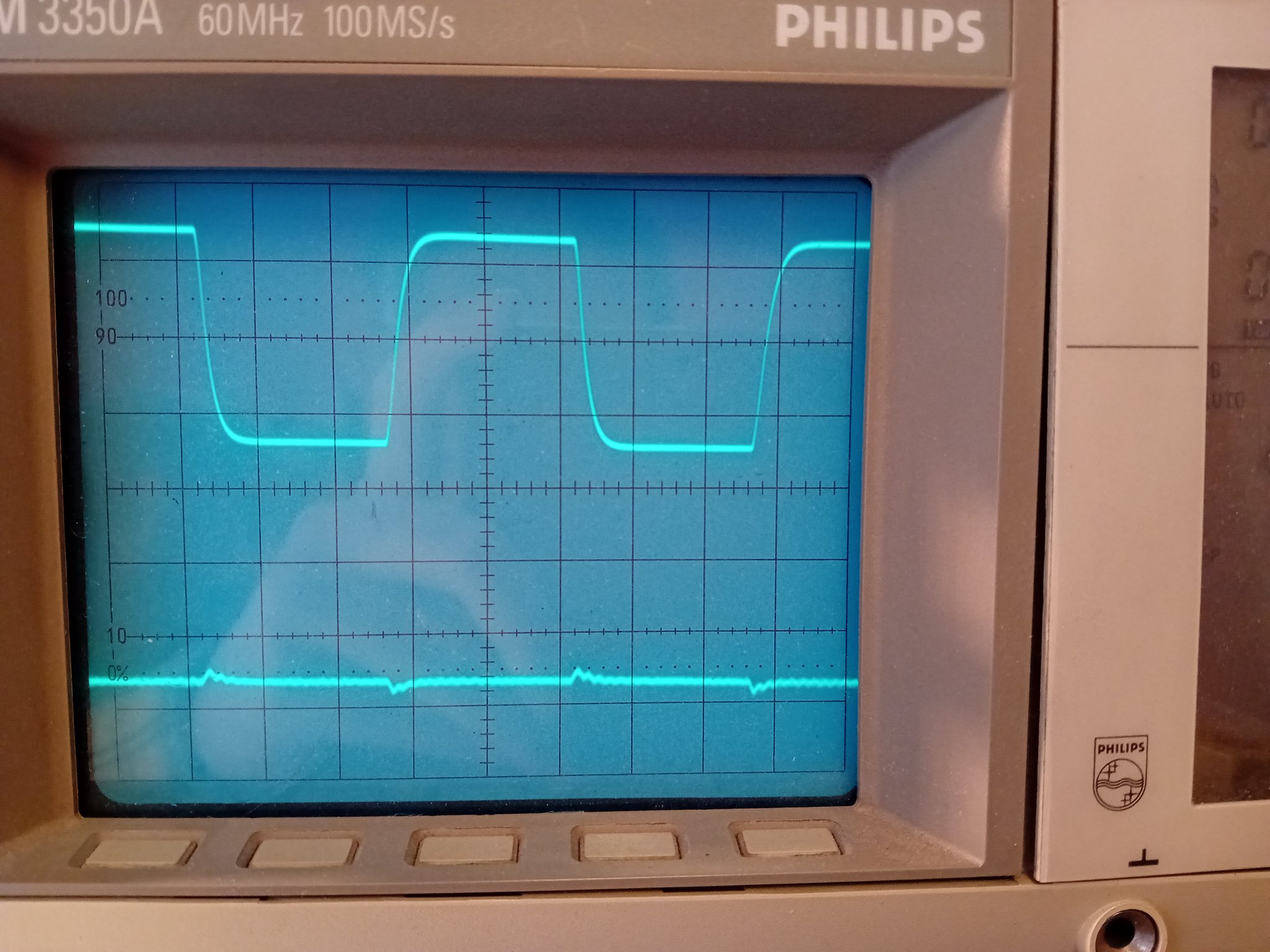

It seems the visible residual of the lower traces just reflects the frequency dependent internal impedance of the supply.
by way of comparison here is the same thing on my first clone of NAP 250 we see a little less oscillation but we also see that the voltage varies more on the square signal the regulator therefore seems more efficient on the new clone
Not clear which one is which. Settings are the same ?
Where is oscillation ? I see some small overshoot.
Blurring of the lower trace in second picture is noise
or "oscillation" is not visible due to low resolution.

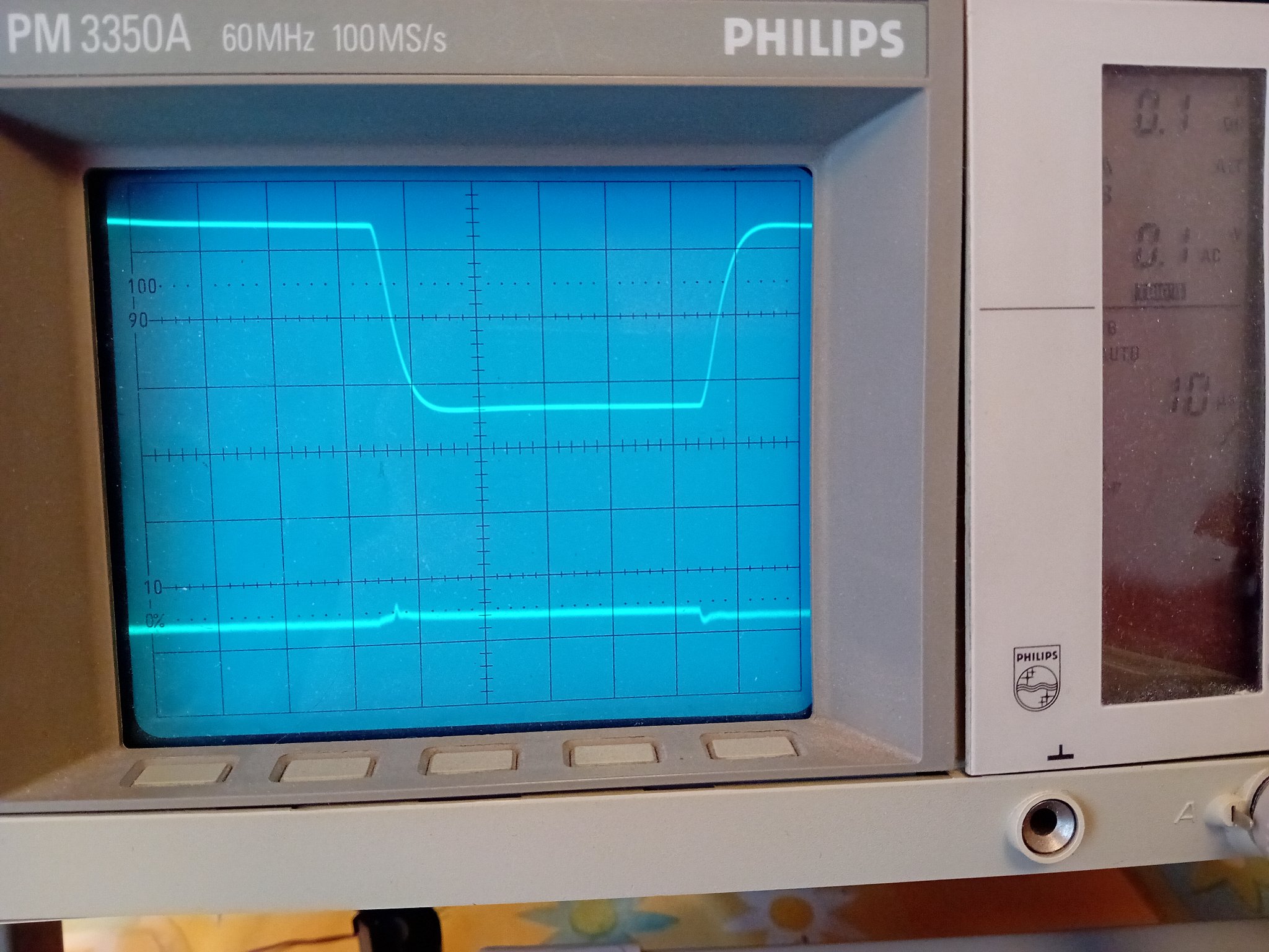

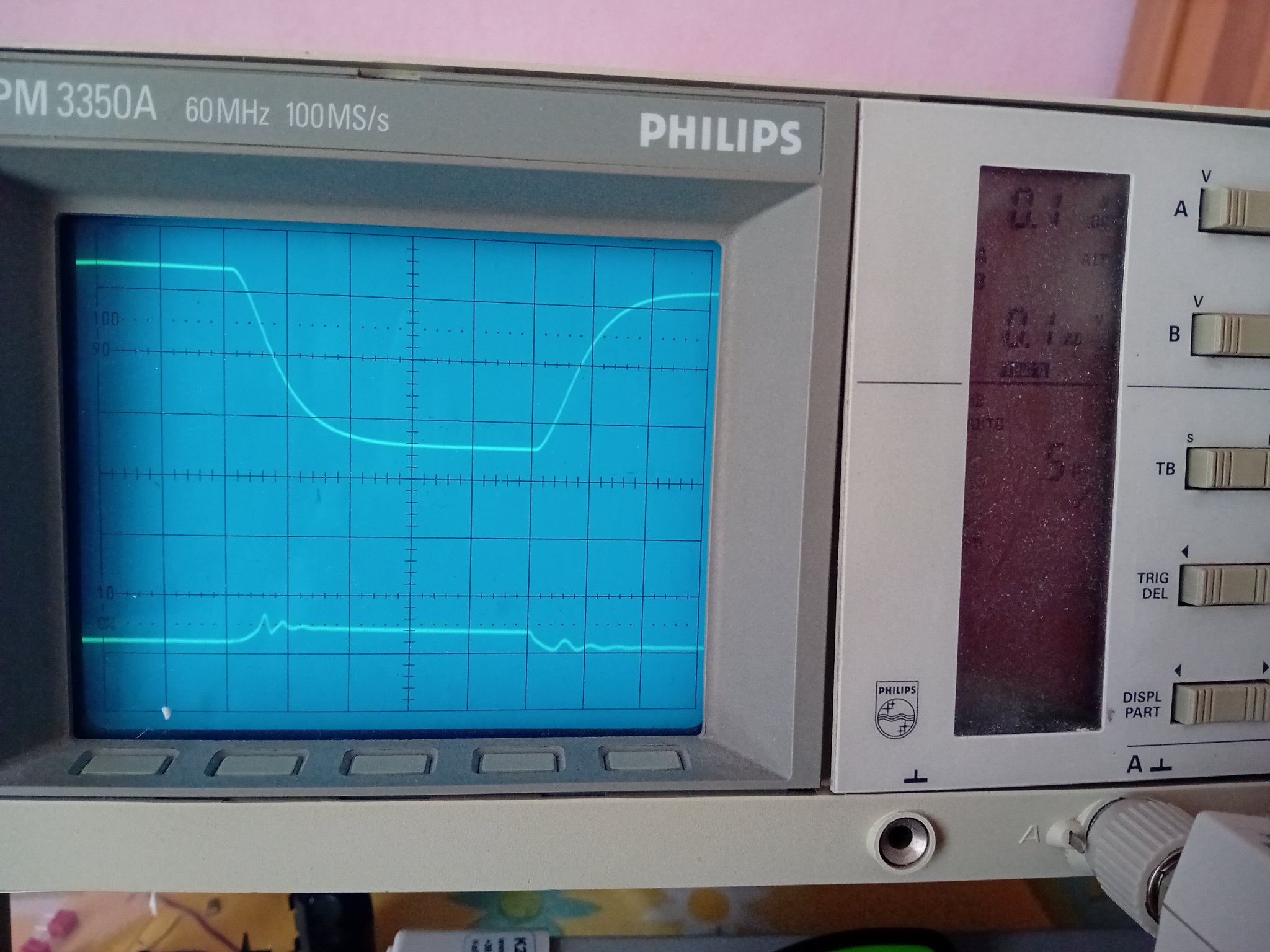

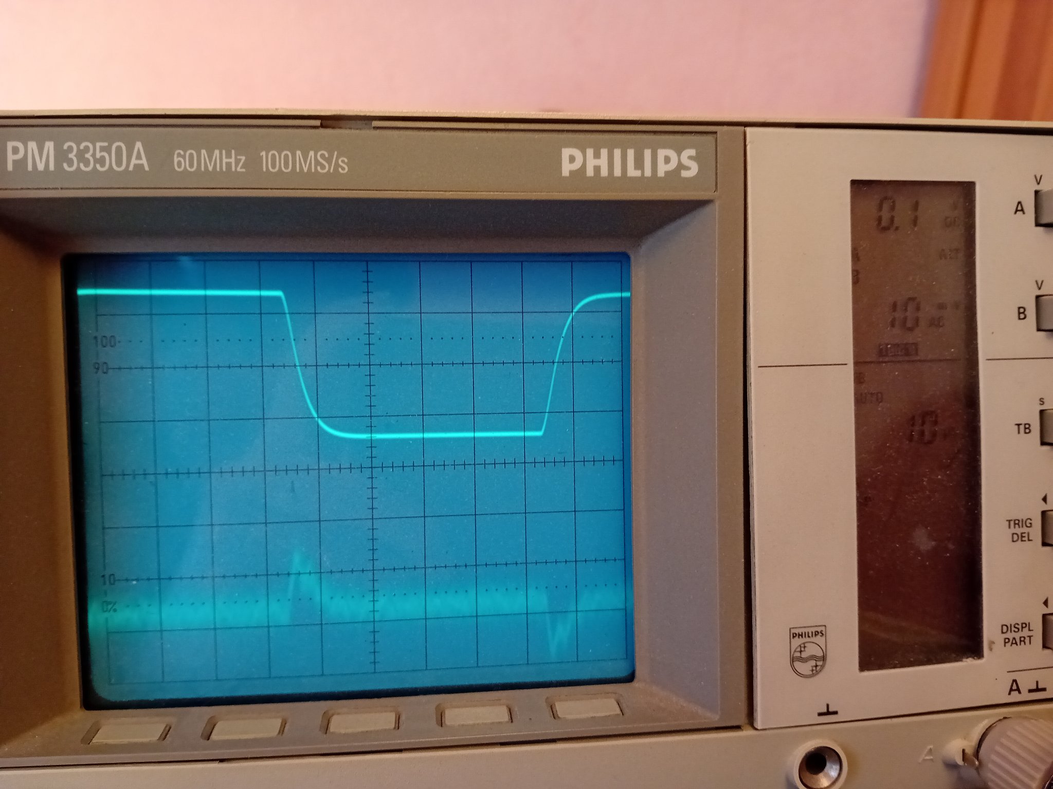

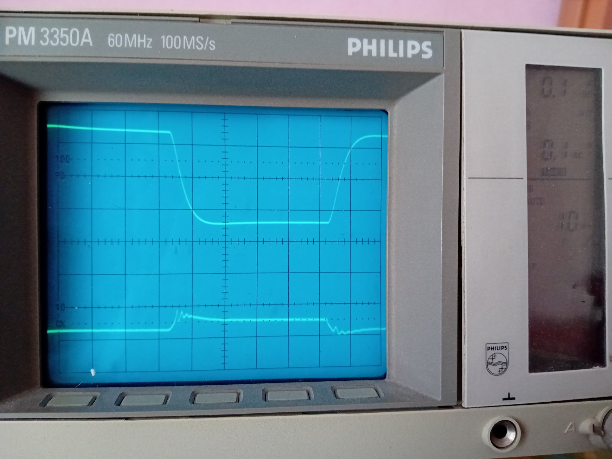

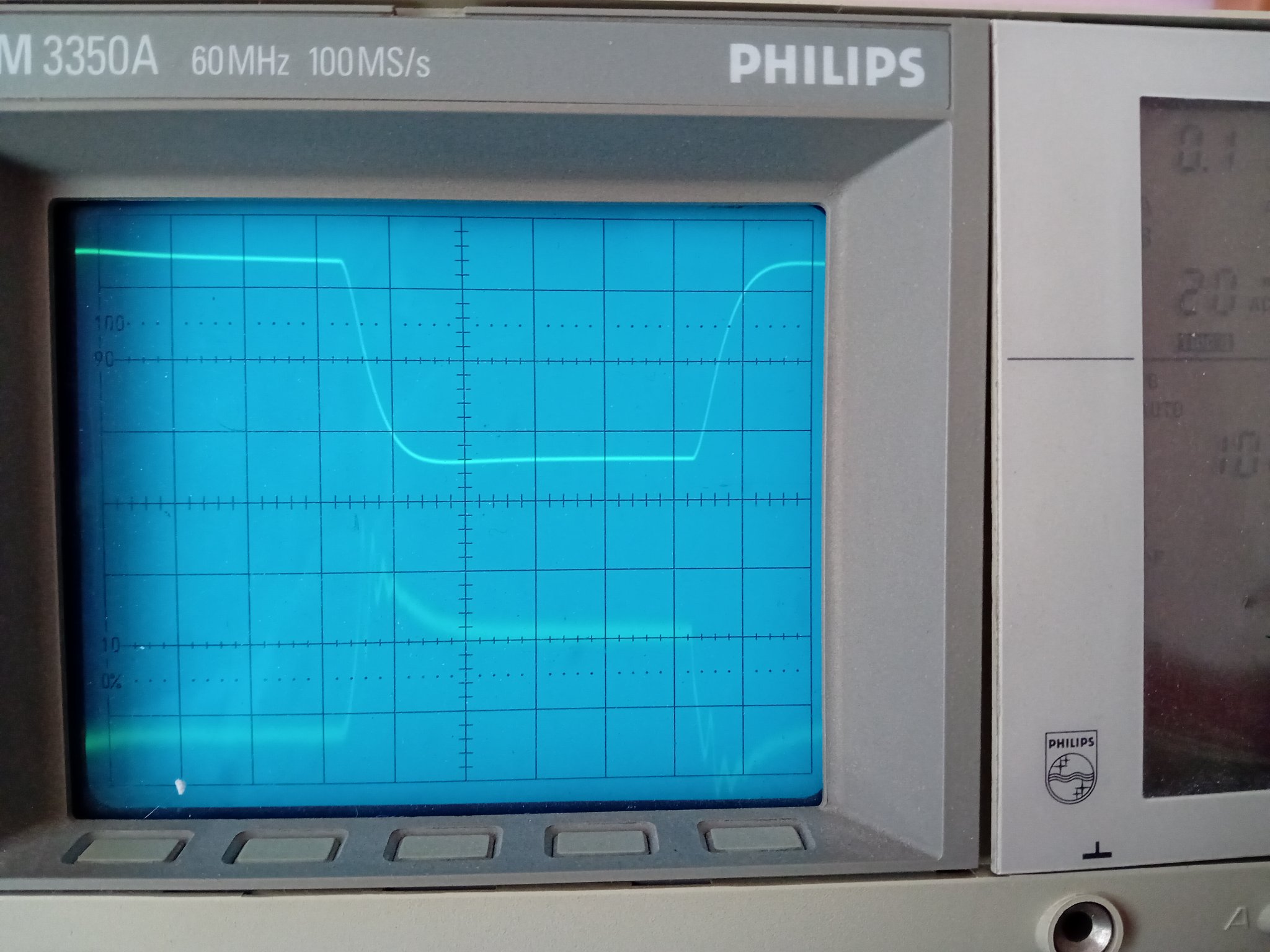

The first two pictures show the negative rail of the regulator with the modifications made on a 10 kHz square wave.
I think there's still a very slight oscillation of 2-3 mV (we're at 100 mV per square for the adjustment).
The second picture shows the same thing, but with only 10 mV per square, and the lack of definition masks the oscillation.
The next two pictures show the same thing, but measured on my first NAP250 clone. It's not visible there, but if I look for an oscillation, I still find one, but weaker, around 1 mV. However, I can't be very precise because we're at the limits of the oscilloscope's capabilities.
I don't know if these residual oscillations are due to the regulators or if they are simply small imperfections related to the power supply or my measuring instruments.

ok i try 180 pF but it's not really better
i try to put a trimmer on the base of Q205 and it's worse if i apply a resistor between 0 to 300 ohms
I think I'll try a series resistor across the 10 uf output capacitor to increase the ESR, as Jpk73 suggested.
But I mostly have the feeling I'll have to switch from the ZTX753/653 to the MPSA56/06, like on the original Naim.
I might try the Mj15031 driver again if the series resistor doesn't help, as there was less oscillation with that one as a driver.
