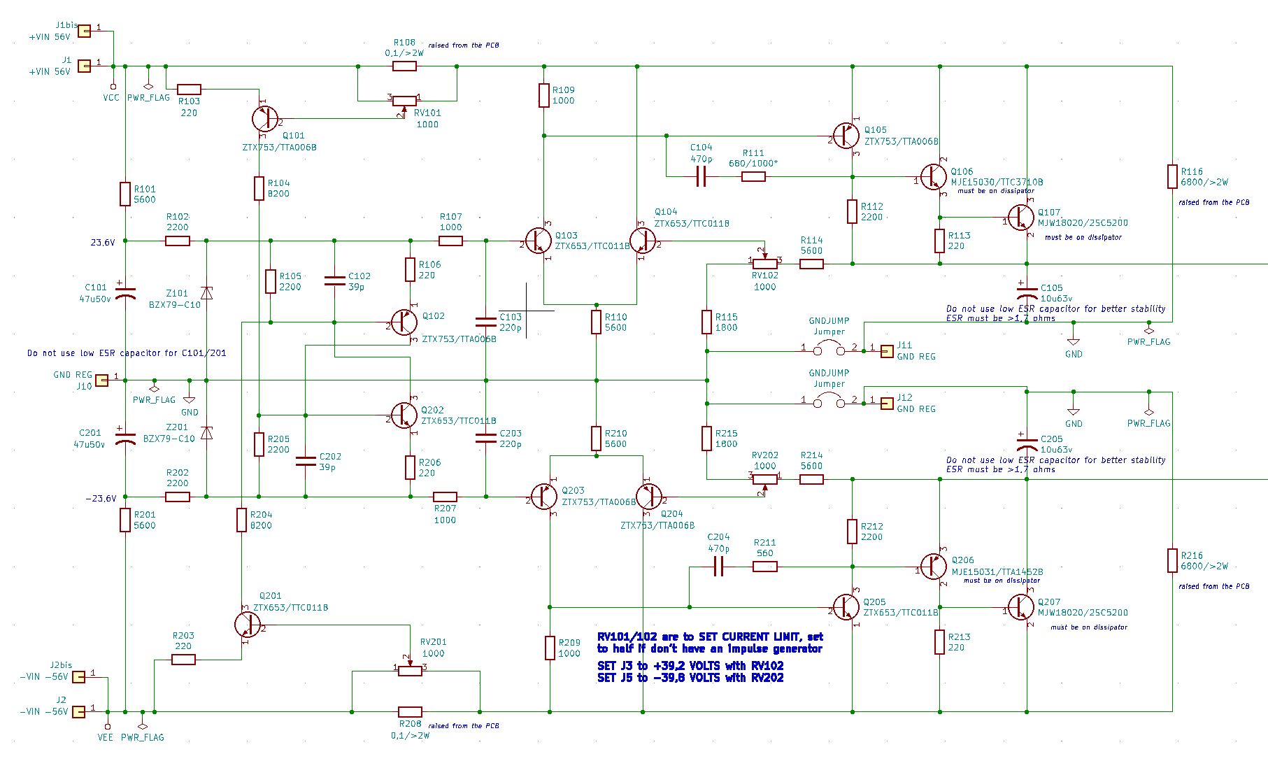

Hello everyone, these last months I started designing a more accomplished NAP250 clone, I may have been too ambitious and suddenly I end up with a small problem of oscillation of the main regulator.
I respected the Naim audio diagram with the difference that I placed the amplifier and the regulator (NAPS) on the same PCB, routing level it was complicated to do.
After wanting to improve the amplifier I replaced the MPSA56/06 transistor references with ZTX753/653 which are more robust
the drivers and output transistors were also replaced by
TTC3710B/TTA1452B
and MJW18020 at the output.
The output filtering capacities are at good esr for stability and those at the input too.
everything else works fine the amp the phase compensation etc I even added the TGM10 speaker protection which works and also a front regulator (like the NAP250 DR) but for the moment I dismantled the front regulator to focus on the NAPS which is faulty.
I specify that on laboratory power supply everything worked without problem and the oscillation was therefore not present, I think it is the ripple of the symmetrical power supply which is not supported by the regulator.
do you have any ideas as to the cause of the problem compared to the original design? or do you have a modification to make that could stabilize this problem?
thank you in advance I put you pictures of scope and the new design.
the oscillation is a 150Khz component which makes 100 mv on the negative rail and 50 mv on the positive rail.

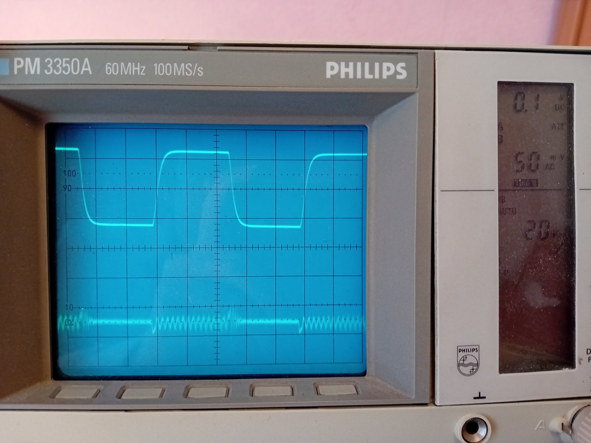

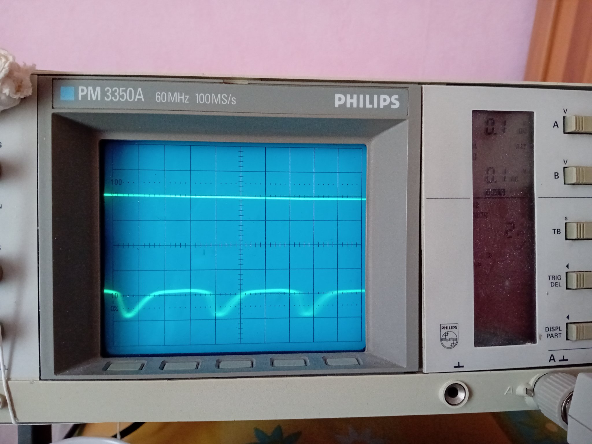

up trace is the out on a 8 ohms load
down trace is the negative rail out of the regulator (same problem on positive less amplitude)
first picture no signal 2 us for time trigger on the down trace 0,1 v on both

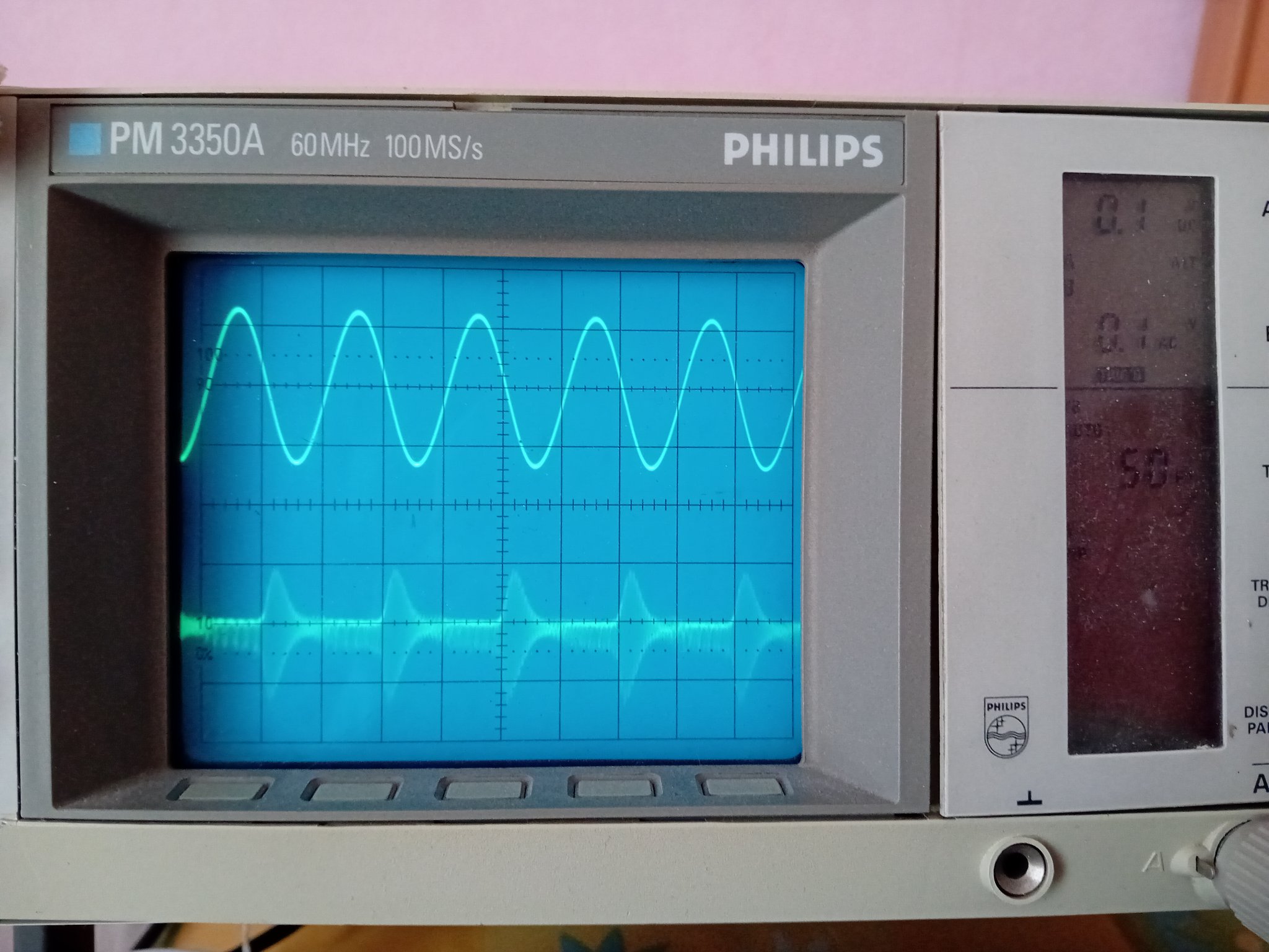

second picture 10Khz signal sinusoïdal 50 us time 0,1v both

The output Q105, 106, 107 etc is complementary darlington or Sziklay.
This can be difficult to tame sometimes. Try base stoppers for Q105, 205.
Did you already probe around ? Are C104, 204 non-inductive ? Small
(ceramic) cap parallel to R114, 214 ?

If you want to tame the oscillation do not look at the input,
but output and maybe feedback as suggested in post 10.
This means a cap in parallel to R114, 214 may be useful to
try, apart from my other suggestions.
A polypropylene cap is not non-inductive in the general case,
but ceramic caps are - C104, 204.
If you see a nasty oscillation it will show up everywhere, even
on ground wires (and depending on probe grounding position),
so it is necessary to find out where the main source is. This is
in most cases the point with highest amplitude, but not always,
depending on impedance level.
Probing different points in the circuit the results can change, so
watch the ac component of output voltage at the same time.

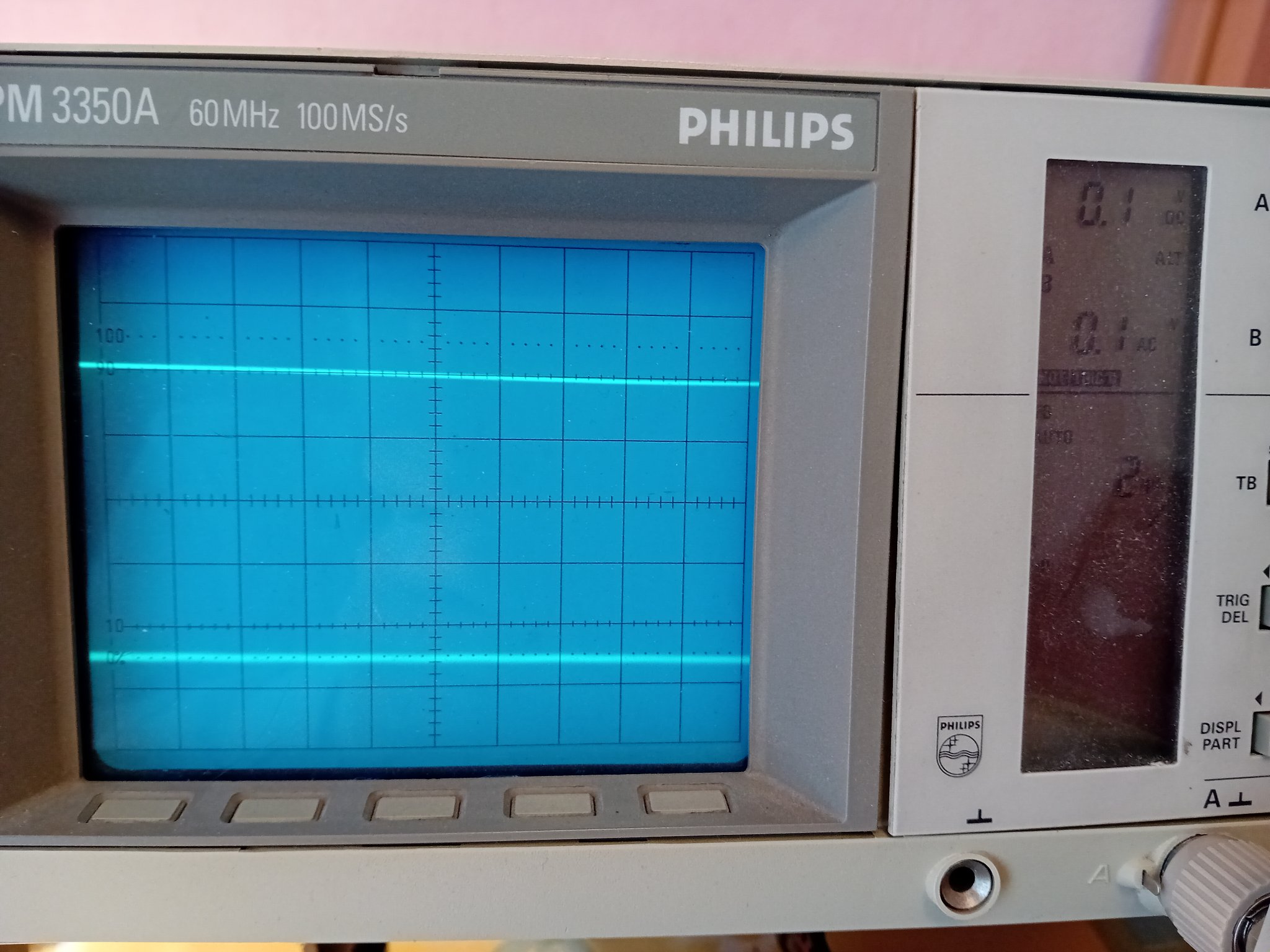

Ok i put a 560 ohms in parallel of the RC circuit to have 280 ohms it does nothing
i try capacitor in parallel of R214 and there is a very good improvment with 220pf (39 pf don't work and 470 pf don't work too)
i think it's a MKP but i think it's not a non-inductive type here ther result at low current (10Khz 100mv signal)
here at 2 us trigger on B we can see no oscillation with the 220 pf
here with the 10 Khz signal 100 mv it seems to be more good unless the power rail oscillate a little but it around 20 mv only

Do you think that this oscillation of 20 mv on a square signal is problematic? it is true that on my old design I do not have that

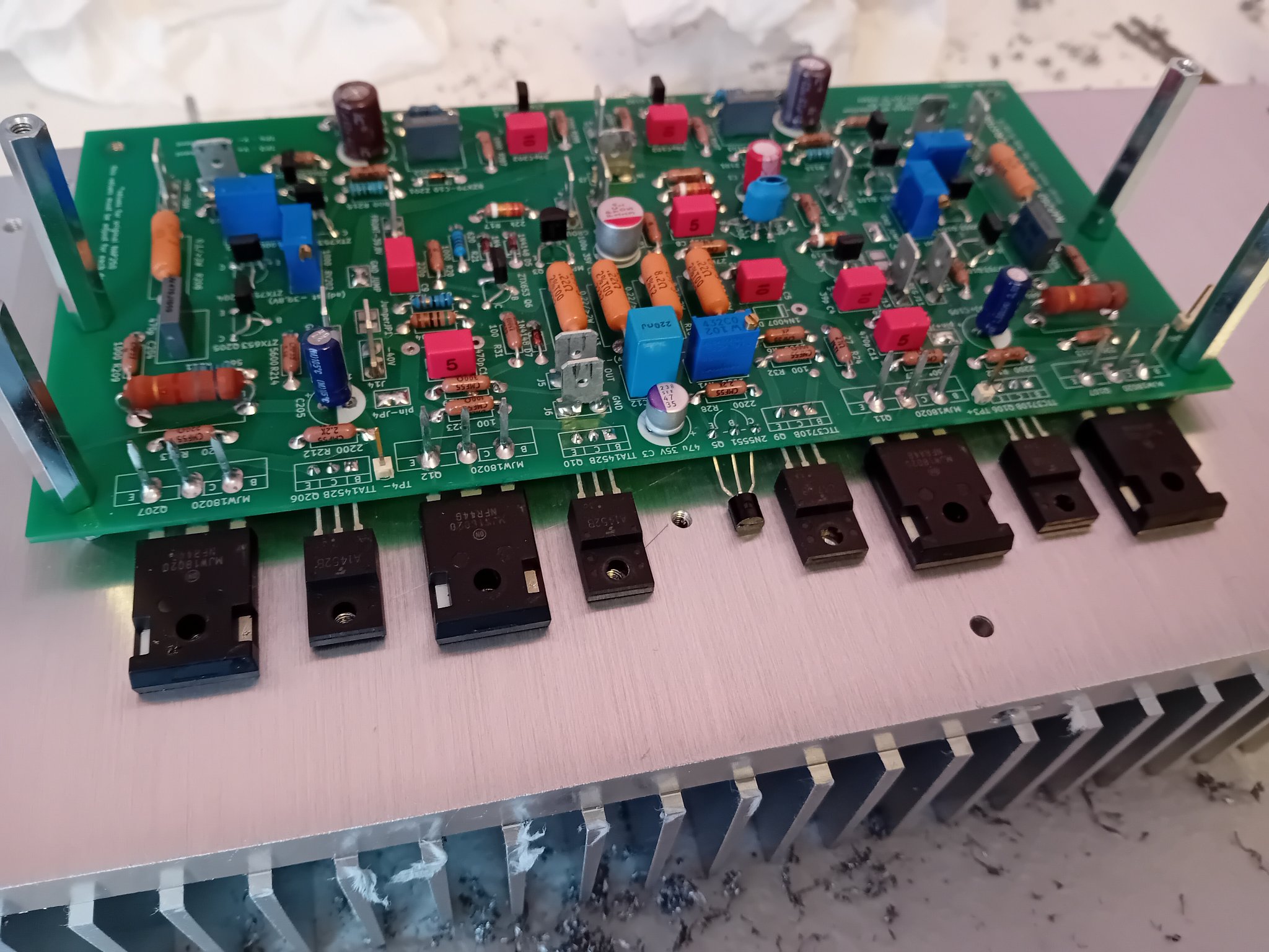

ok so I disassembled the PCB to place it on the test heatsink which frees up the back panel to be able to change components for testing.
i just did my first series of tests:
i changed the 10uf output capacitors which have an ESR of 1.8 ohms for 2.5 ohms of ESR which is less limited
i placed 2000ohm trimmers on the RC networks to vary R111/R211
i added in parallel on R114/R214 grips files to be able to test different capacitor values again.

I see no need to work on the RC networks with R111, 211 and think I did not recommend it.
R 114, 214 are in the feedback circuit and any change will change the output voltage. I did
not recommend it. I recommended to try ceramic caps in parallel. To be even more effective
these can be connected to the pot RV102, 202 wipers, not just the left side of resistors R 114,
214.
I also recommended to try base stoppers.
214.
- Oscillation into voltage regulator of my new NAP 250 design.
