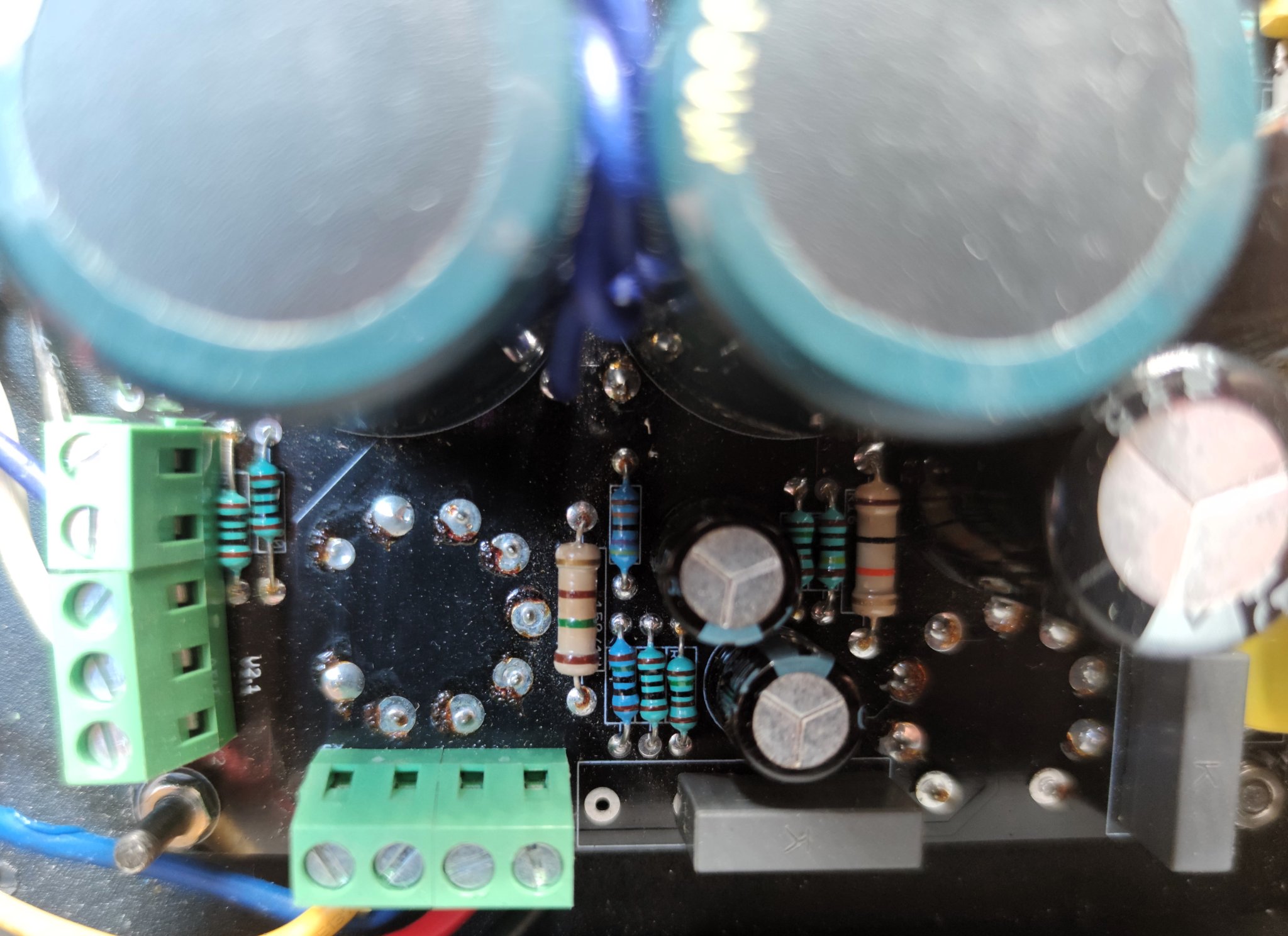

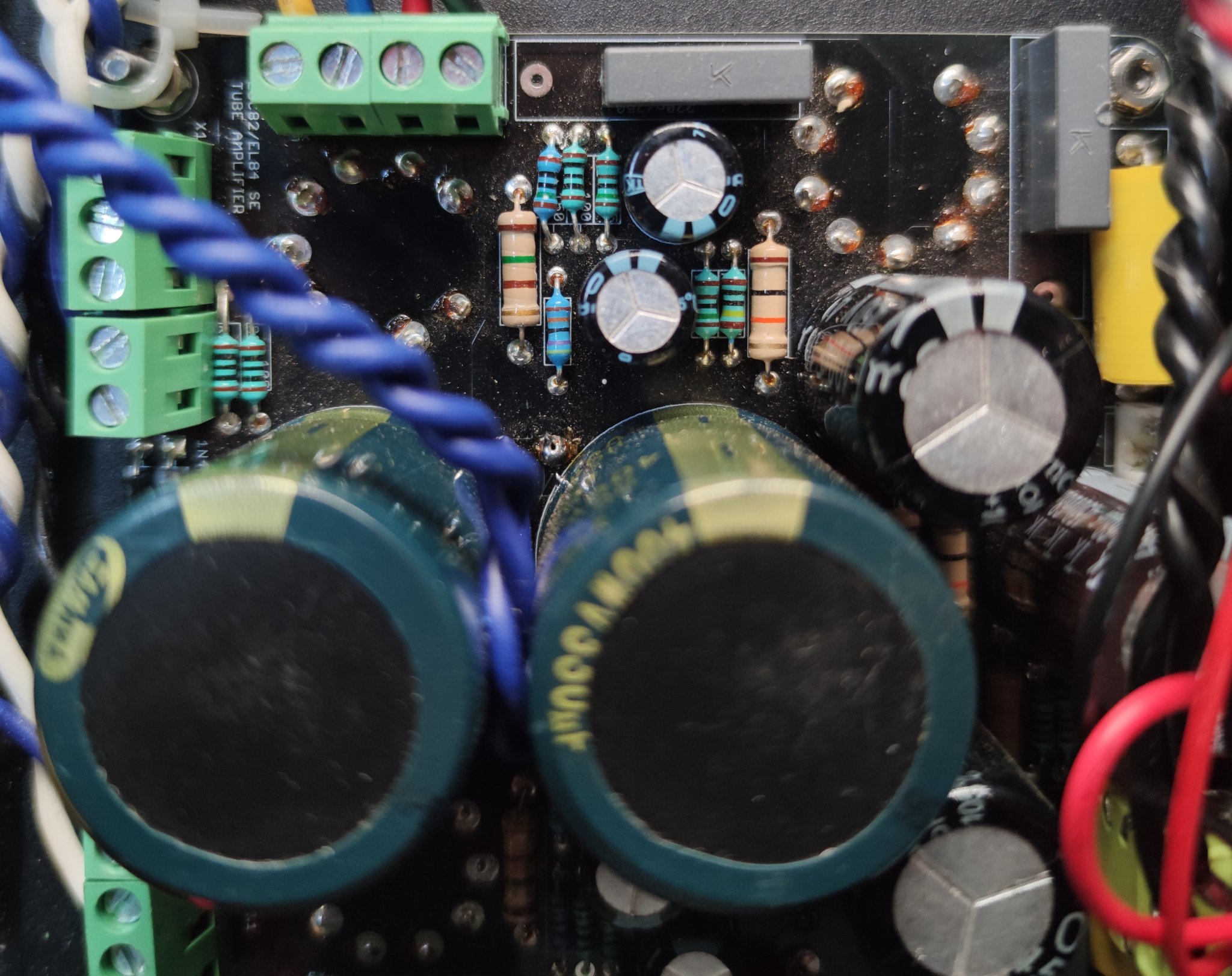

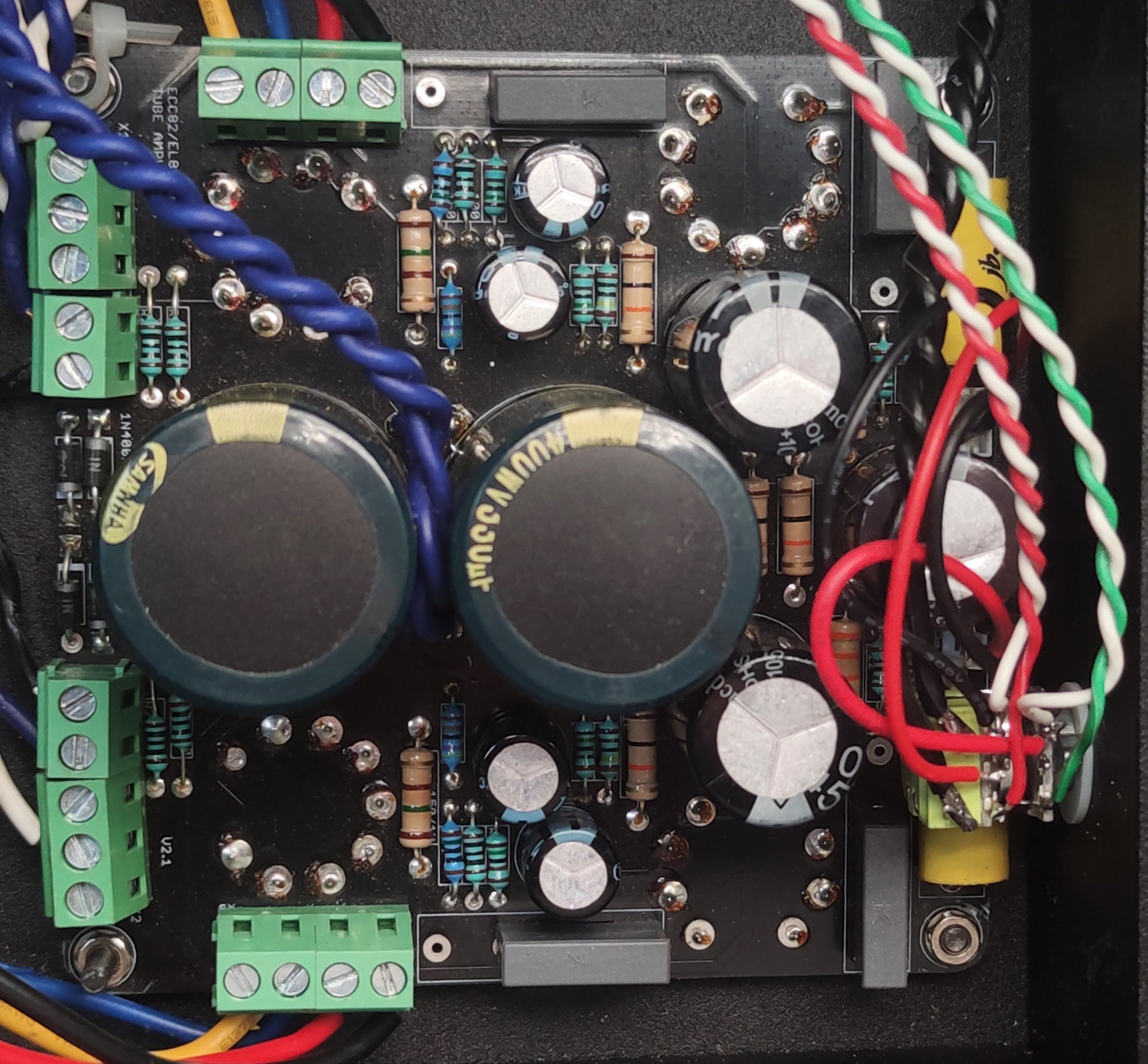

See attached images, going to check capacitor values when I have it out. Filter caps are 400WV/330uF.

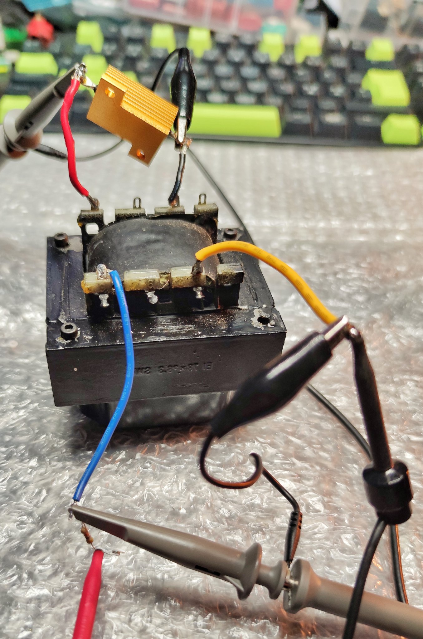

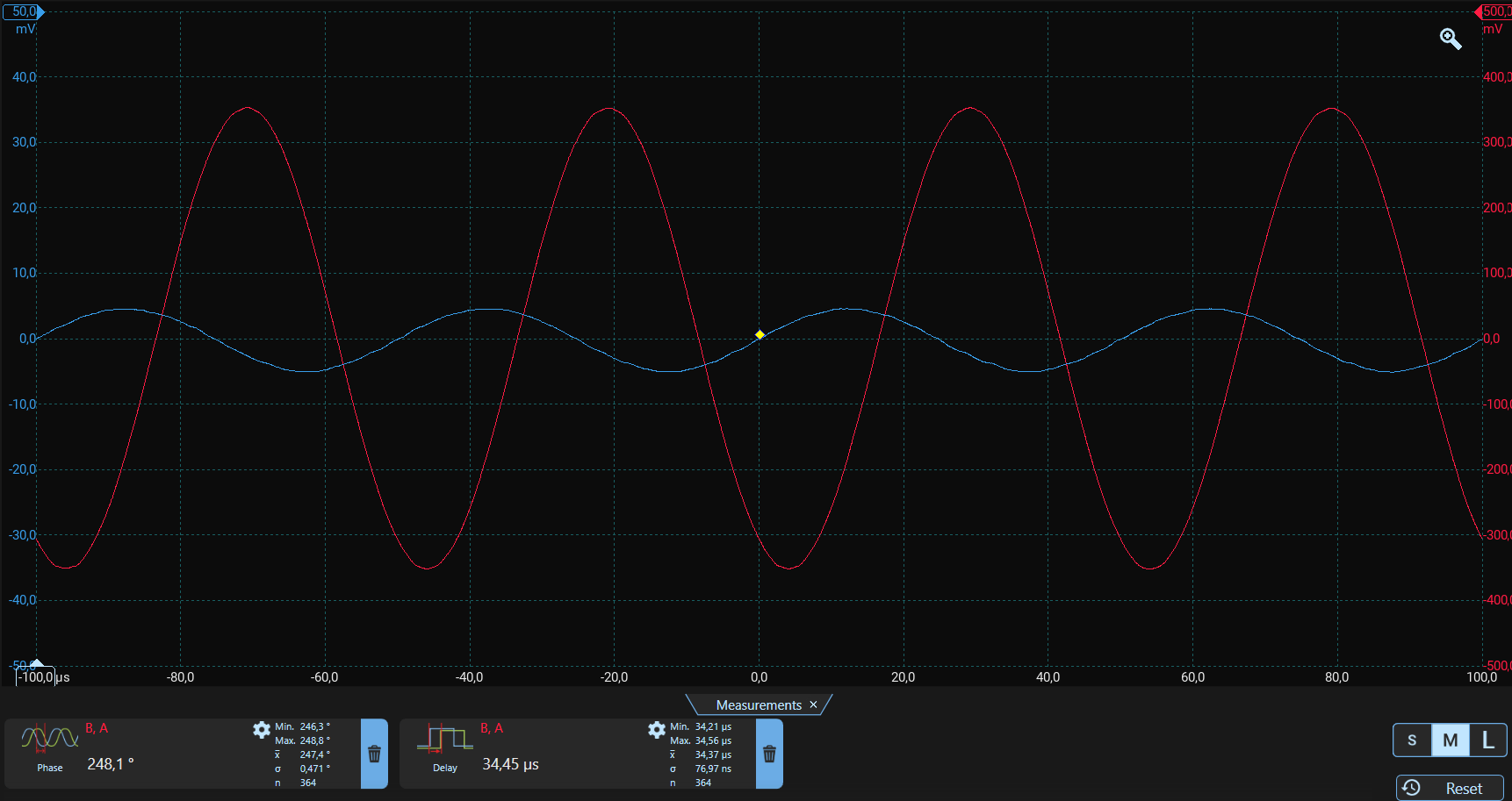

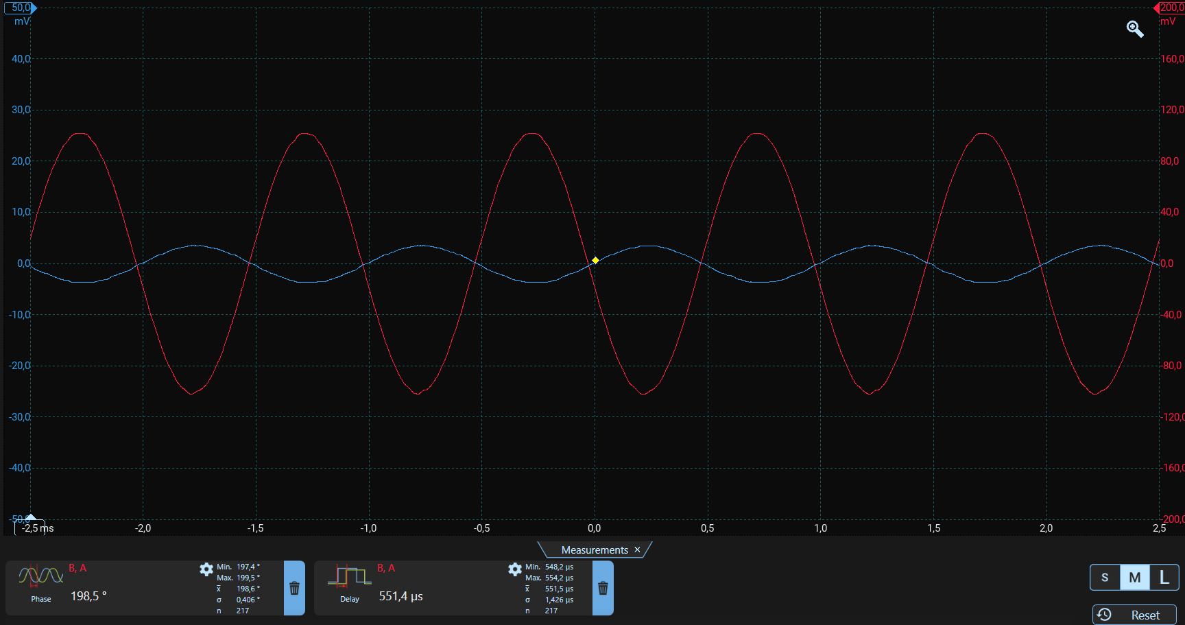

I guess you used the 600 Ohm generator to the 47k series resistor to the primary winding.
Then I guess you measured across the primary on channel 1, and then across the Loaded secondary on channel 2.
This needs to be a bare bones measurement, with no other circuits connected to the transformer.
An output transformer with 280 degrees phase shift from primary to secondary at 14kHz, or 16kHz, or at 20kHz . . .
Well, that means one of two things:
1. You did not connect the primary and secondary so that they are close to In-Phase at 1 kHz (near zero degrees). Measure there first.
Or
2. Your transformer is not very good to use an EL84 in Pentode mode to drive it.
If you have to re-connect your transformer so that it is In-phase at 1kHz; then when you re-measure the phase shift at high frequencies . . .
The new measurement reading will become: 280 degrees - 180 degrees = 100 degrees phase shift at high frequencies.
Please let us know the 'new' high frequency phase shift degrees number.

Ok -- Turned out one of my probes was bad. This time I also pulled the OPT entirely out of the chassi. See attached pictures for the setup and measured values.
Seems like it's flipped ~180 degrees, but I wasn't sure so I just measured it as is. There seems to be about 50 degree difference between 1k and 20k.

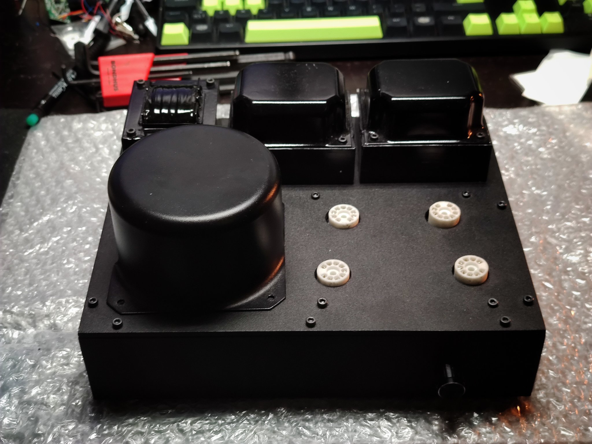

Hey folks!
Recently bought myself a single ended E80CC/EL84 amp from a fellow enthusiast. First one I've ever had, and I primarily bought it to use with the Beta 8-loaded Dallas horns I'm building (Follow that bit here).
To test the amp I hooked up some of my fathers' cheap logitech satellite speakers. Whatever was there sounded fine, and now knowing it worked I felt confident connecting the Beta 8's just for fun. After a minute or so, I noticed some low-frequency stuff happening and when I looked at the speaker cones they were oscillating something fierce. I cut power and proceeded to sweat bullets. Let it cool down and switched the tubes around, same thing happened. Went ahead and filmed it, oscillations visible only in the last few seconds.
I asked the guy I bought it off of if he'd ever had any issues of the sort, and he told me no. He'd only built it a few months back and had been running it for extended periods regularly through both his BR-mounted Flat 8's and some 3" Tang Band speakers. Upon request he provided the schematics for the amp -- Some sort of DIY kit he had bought off of Ebay. I'll be posting them below.
Only thing about the schematic that worries me is the absence of any kind of resistor on the screen grid, feel like you usually see those on pentode amps. That said, I'm still fairly new to valve amp design so any input from the sages here would be much appreciated.
In the meantime I'm going to borrow some 100x probes from work and feed it with my signal generator to see if I can make any sense of it. Have plenty of old radio drivers that I don't mind bricking for science.
J

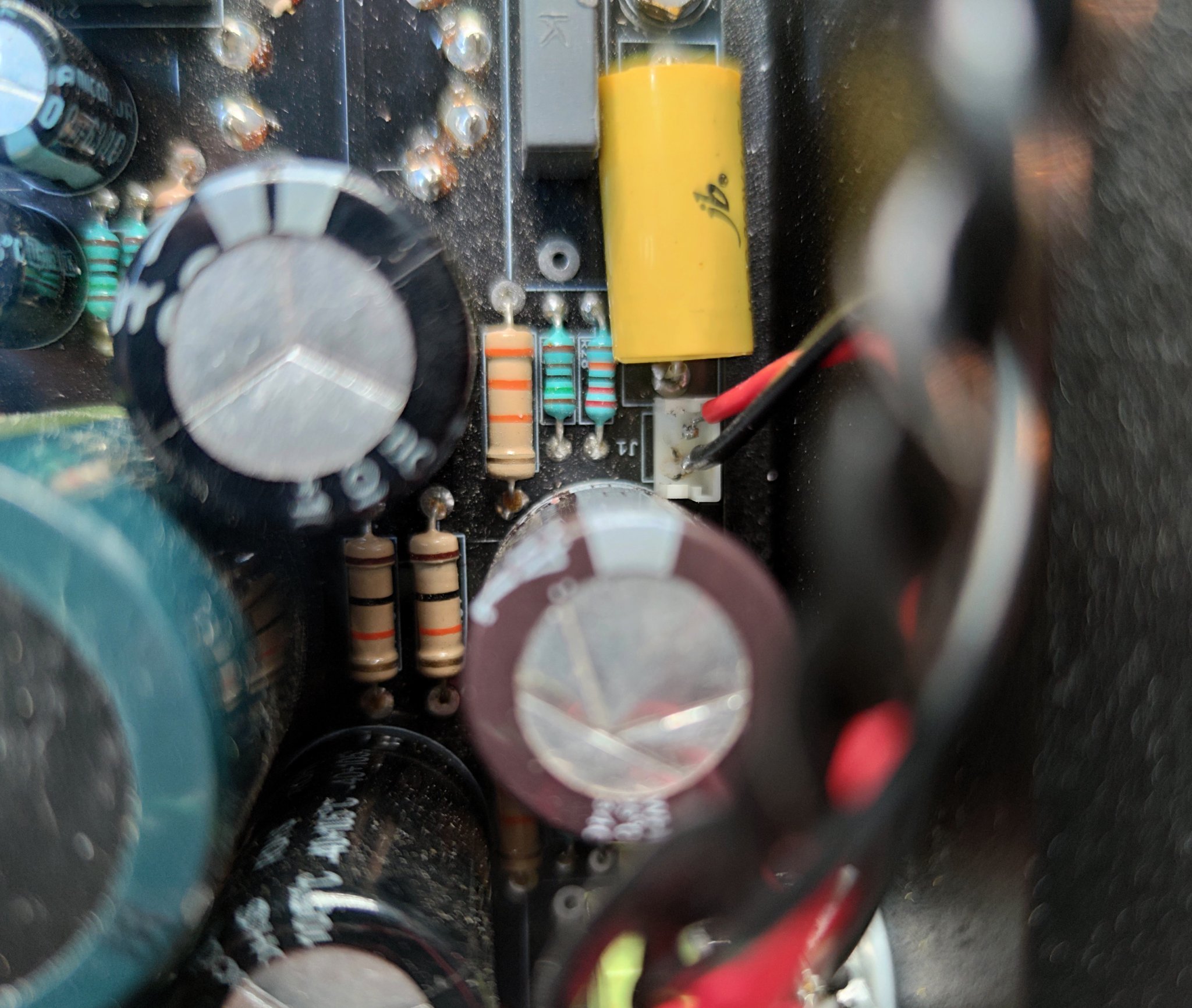

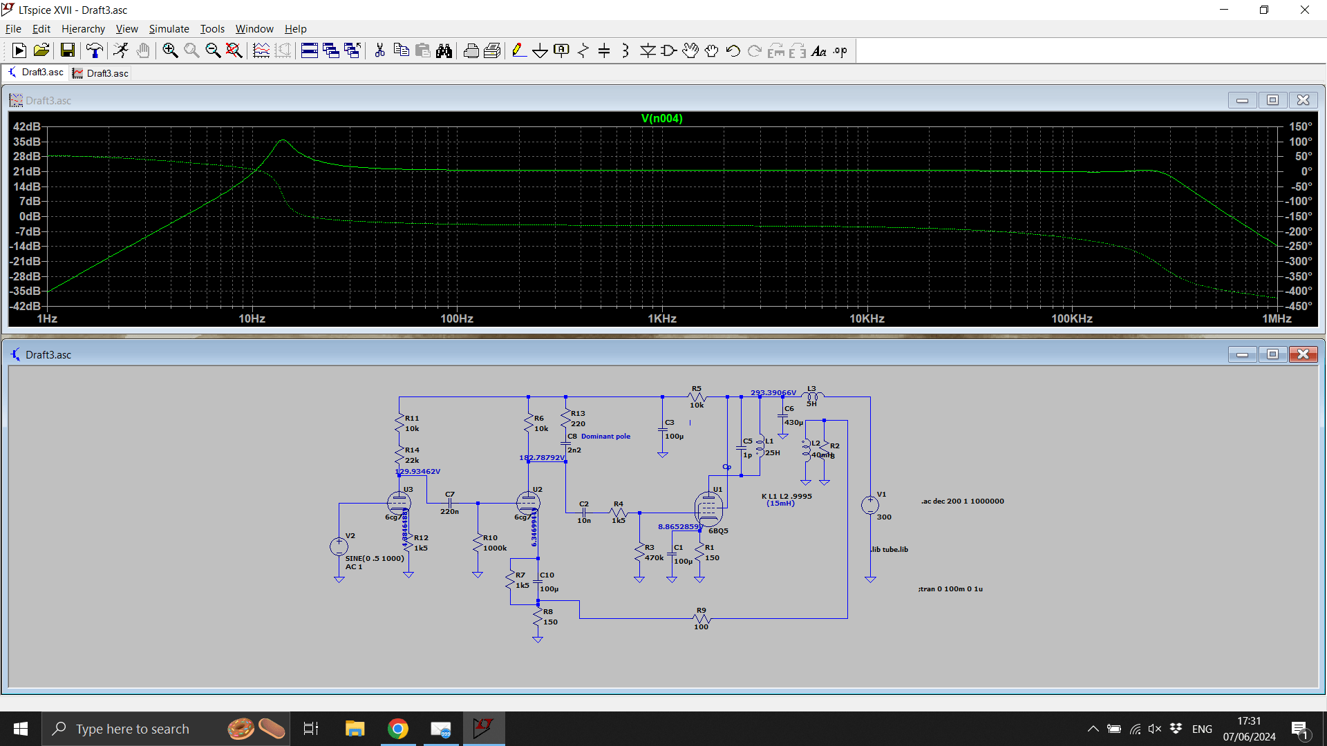

Could you read the labels on the grey caps and the yellow caps please. 10uF is good for now. What I don't understand is why its at 14Hz. The simulation does not predict this at all. That seems to suggest there's a mismatch of what's fitted against the schematic.
Unreal. I was blind to it since they seemed appropriately sized -- always been one to miss the forest for the trees :fight:
Took a good few hours, but I found two 220nF caps and 470nF caps each. Put the 470's as couplers and 220's for C1 and C7.
Going to put it all back together and give it a test, then see if i still run into oscillation issues @ higher loads.
If that's the case, interstage decoupling will be next in order, and then triode strapping.
I just noticed something that does not relate to your problems. But it should be changed anyway
Change the connection of R4:
Connect C2 to R3 (R4 does not belong between them).
Connect one end R4 to the newly connected junction of C2&R3
Connect the Other end of R4 directly to the socket tab of U1 g1 grid.
Done.
Now, when correctly connected, R4 acts as a grid stopper, which is its only reason for R4 to exist.
(the original connection of R4 is a very common mistake, both for the schematic, and for any such actual wiring connections).
Some people have stopped understanding the reason for, the theory behind, and the proper application of grid stoppers.
A. Sometimes, it can be helpful to run a simulation program, with the negative feedback Disabled:
Disconnect the 100 Ohm negative feedback resistor, R9 from the output transformer secondary (*), and connect that end of R9 to ground.
That will do 2 things:
1. Disable the global negative feedback.
2. Maintain the exact same bias voltage on the cathode of U2.
Now, re-run the simulation program, gain and phase, including the output transformer.
Is this a "New" Idea? . . . Special low frequency simulation to find the gain and phase?
B. Next, change the simulation schematic to put a 5k resistor across the output transformer primary, disconnect the 8 Ohm load from the secondary, and disconnect the global negative feedback as above (*).
Re-run the simulation program.
Since you know the primary inductance, no other details of the output transformers are needed in order to get a Very Accurate gain and phase at Low and Very Low frequencies.
This is key when adjusting low frequency time constants.
. . . Just another tool for your toolbox.
Many diyAudio fans have done A. above.
I bet very few have ever done a simulation as listed in B. above.
Comments, Please!
