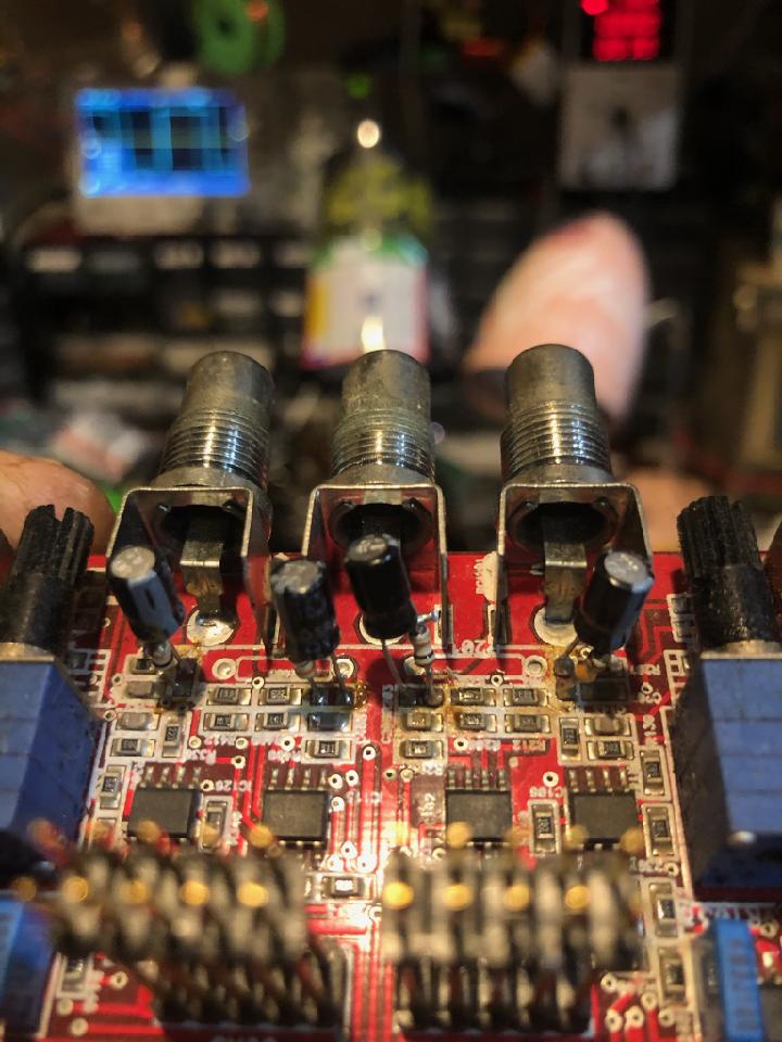

I am working on an Orion xtr5004 and I have run into a wall and need a little help. I have rebuilt the power supply and with the rectifiers out it powered up just fine. I have removed all the output fets which are irl540n's. When I put rectifiers in the amp cycles in and out of protection. If I remove the voltage regulator ics it powers up and works great, Even with the rectifiers in. I replaced the lm337 and the lm317 but with them in the amp goes into protection. I replaced both 100ohm resistors that feed the v regs as well. Does anyone have any thoughts about what could be my problem?

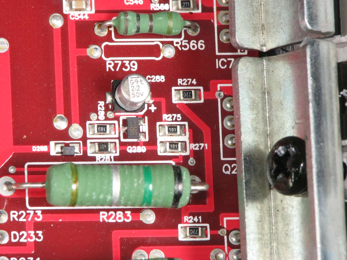

In the photos I have, it's an SOT-23 which is likely a 2SC2412.

Just replaced it and the amp is still going into protection, it's like the amp tries to rebuild a square wave and goes back into protection. But like I said if I pull out the lm317 and 337, the amp builds a perfect square wave.
This had been done to the amp before I received it so I have a feeling that it had distortion issues before. Should I fix it back to original? If so I don't know the R values. I'm going to check pin voltages on the opamps now.
