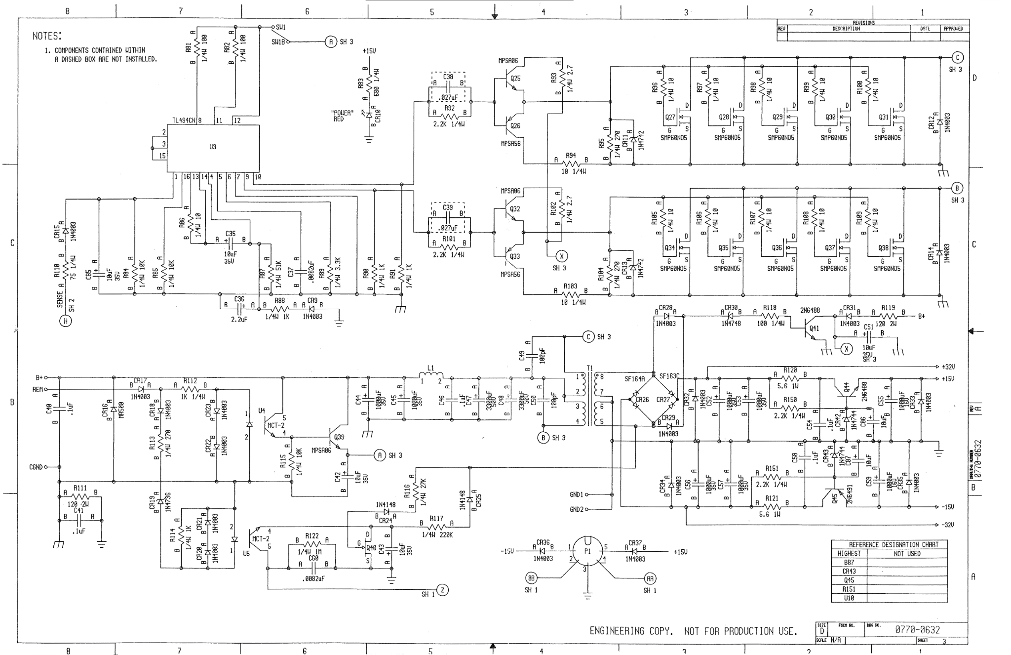

Hi everyone,
I have a orion hcca 2100 that I repaired..... partially. The mute mosfets are not getting turned on, I have the opamp output but the mute fets off..no output. does anybody have had this problem. Any help appreciated. When I remove them I have output.
Thank you,
Raf
See attached. Point Z drives the gates of the muting transistors. Find why they are not getting the negative voltage they need to pass audio.
This is a 225 but the circuits should be similar.
