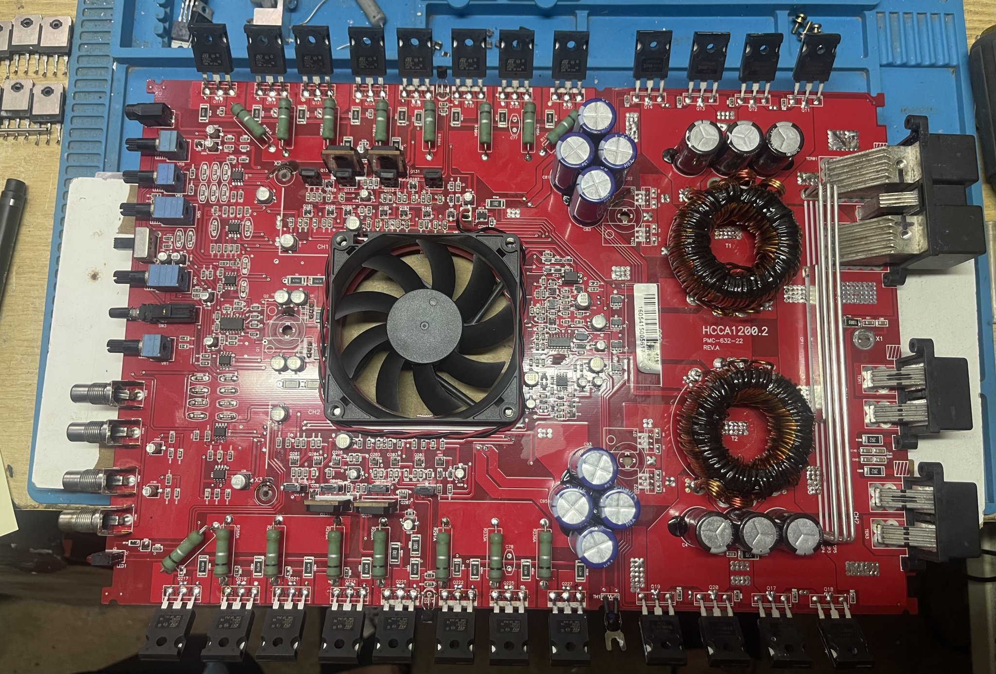

Orion HCCA 1200.2 OutPut resistor question

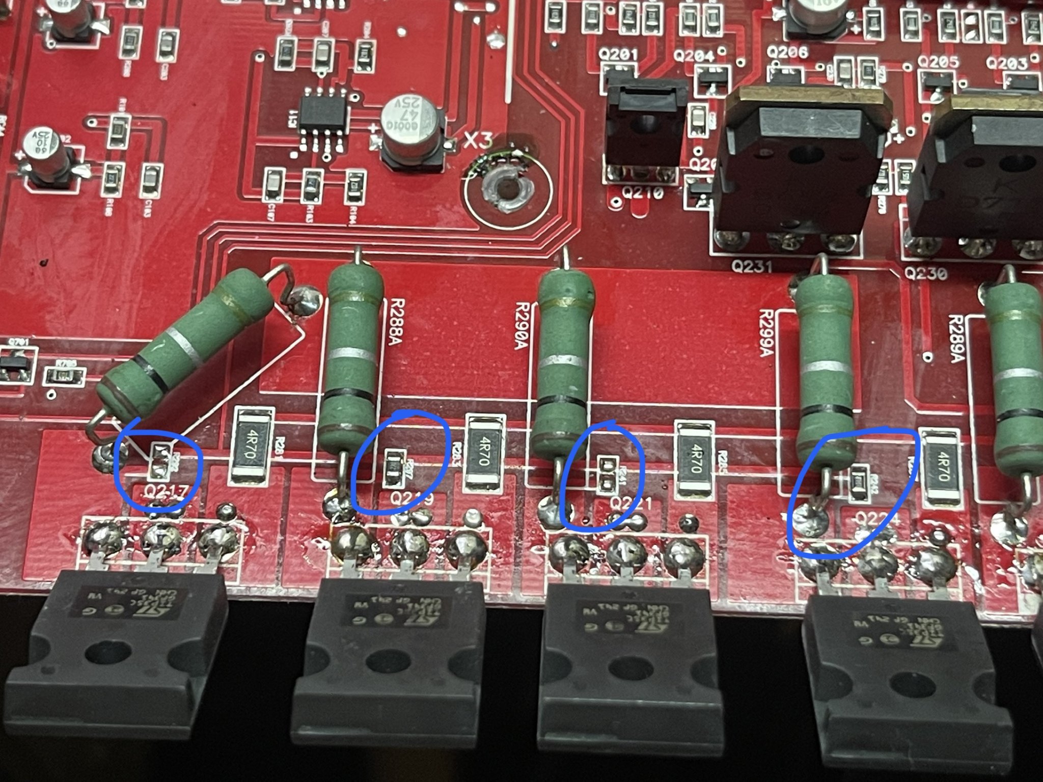

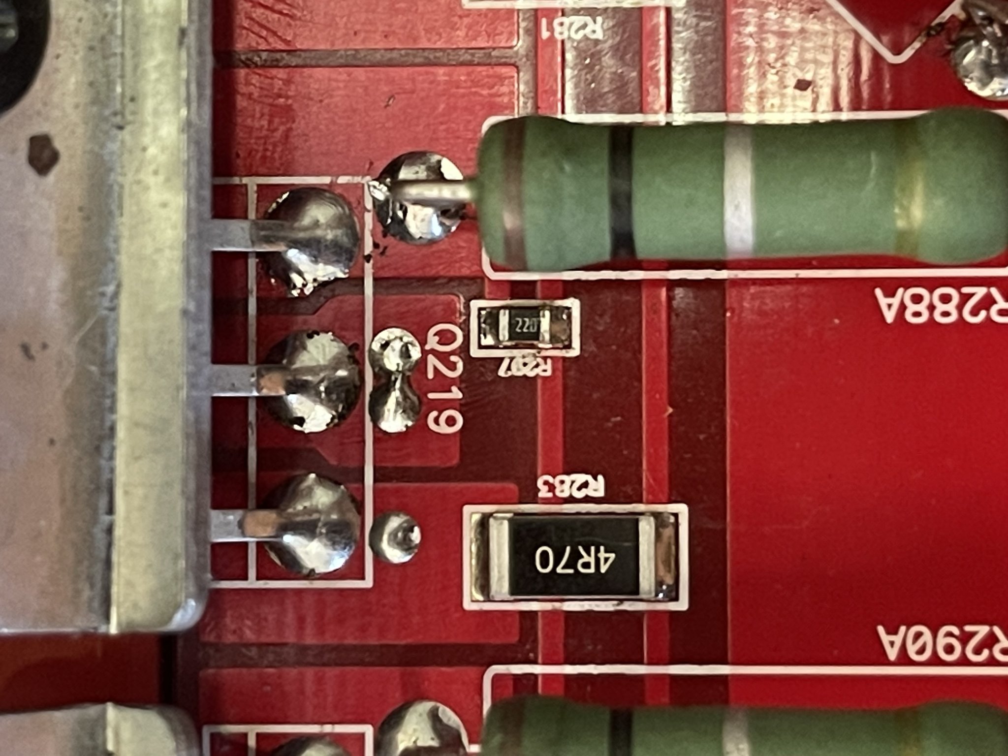

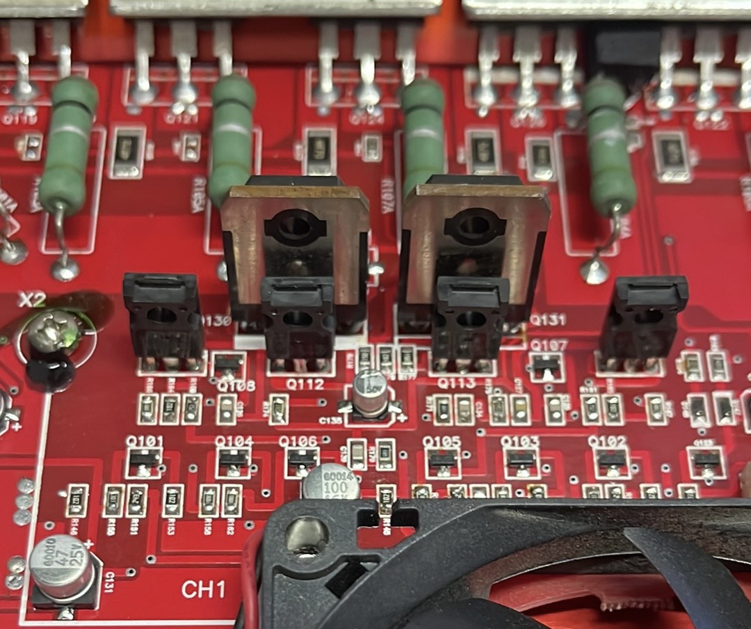

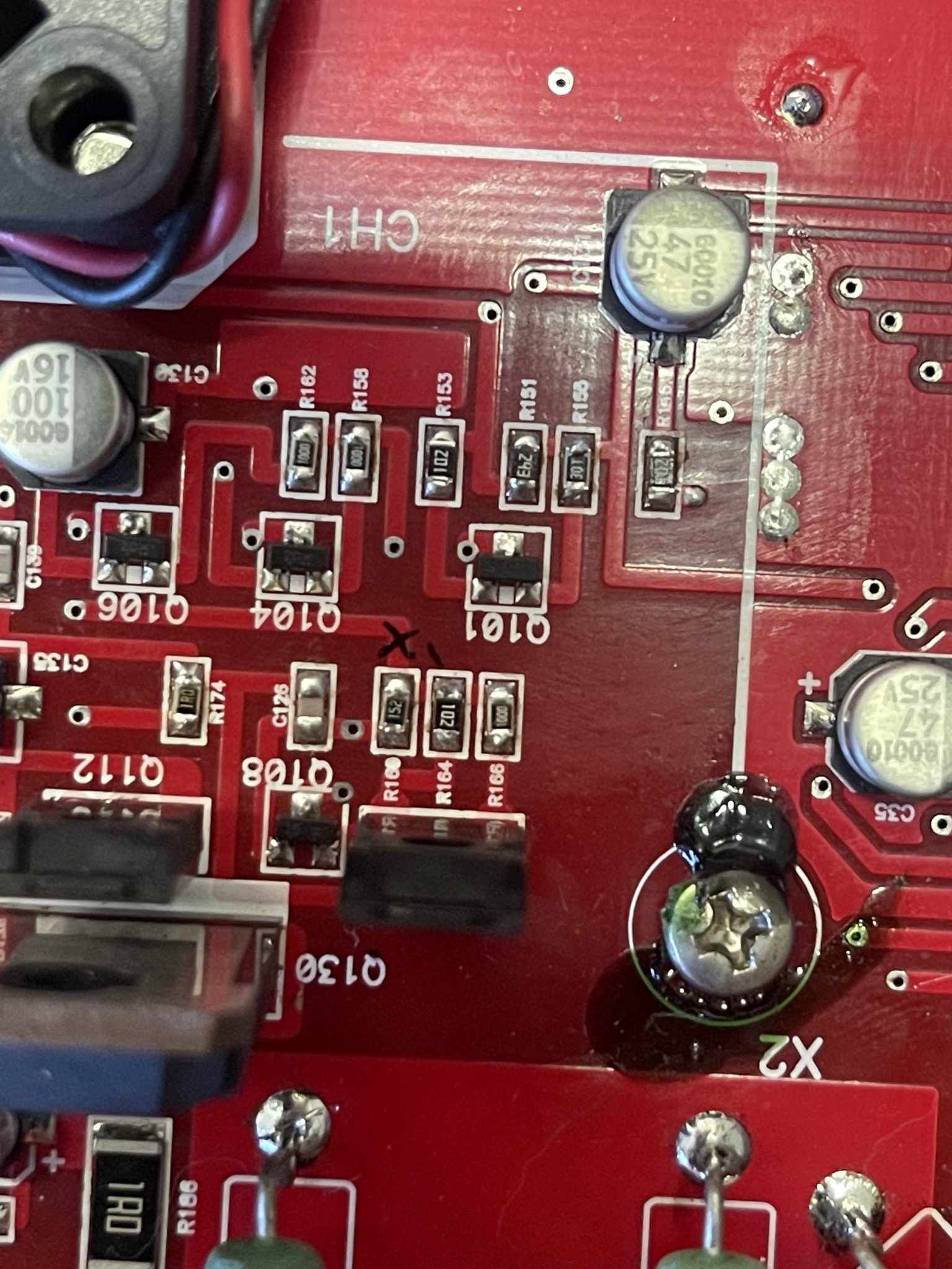

So I replaced the blown bond resistor, noticed the FETs were mismatched from a previous repair (stickler for my gear running as prime as possible) so decided to swap out all the output FETs (TIP35c/36c) from the lesser version to the better ST, matched set, and just got done looking over my joints (haven’t even cleaned flux off the board yet) and noticed this amp is either missing 2 resistors in the TIP35C section on each half or empty but mismatched areas from factory? I tested amp after bond resistor replacement before FET change out and it seemed to run great at idle, so I’m guessing this was in purpose from factory? Why are they not in same exact area on each side? Did the previous tech who repaired the first blowout using mismatched batch/brand FETs remove them? Each resistor is 22 Ω and even the empty resistor sockets probe are 22 Ω as well.
Just trying to make sure the amp is running proper, and this just doesn’t look right, if it was from factory I’d expect it to look the same on both halves of the board, any info/insight would be greatly appreciated. Resistors of concern/empty sockets circled in blue.
Also depending on answer, can I move the one resistor that isn’t on one of the 2 outside FETs to the outside to match the other half of board? Just OCD preference, lol, just looks as if location doesnt matter just as long as 2 are there like it looks, placement looks random 😅 unless there is 2 from each side in fact missing 🙃 or would it be better to have the resistors as populated/unpopulated/populated/unpopulated or like I 1st mention as populated/unpopulated/unpopulated/populated …I know this may be overthinking but still would like to know 🤓

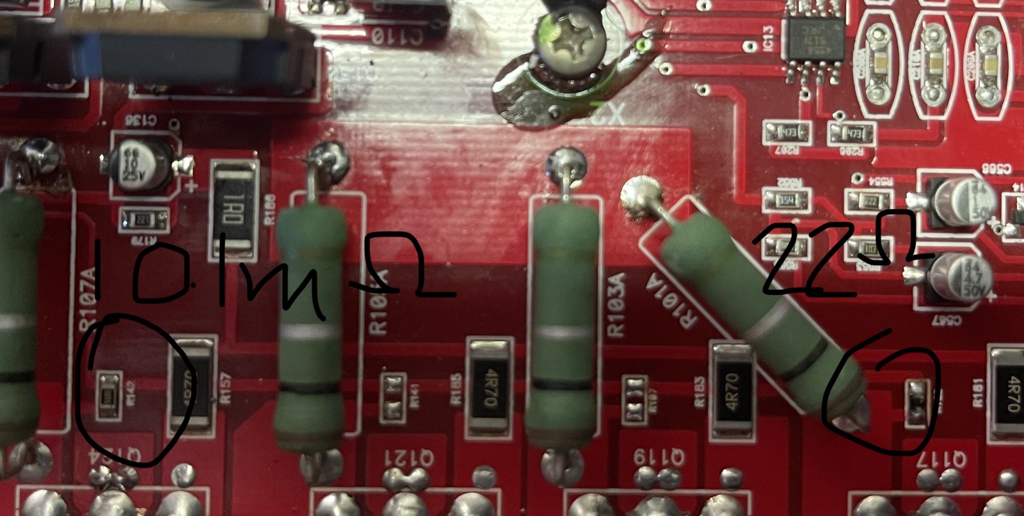

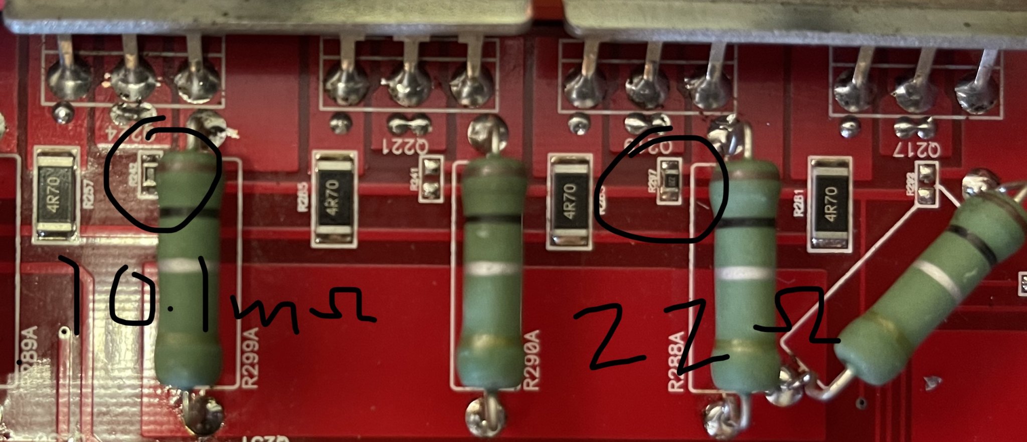

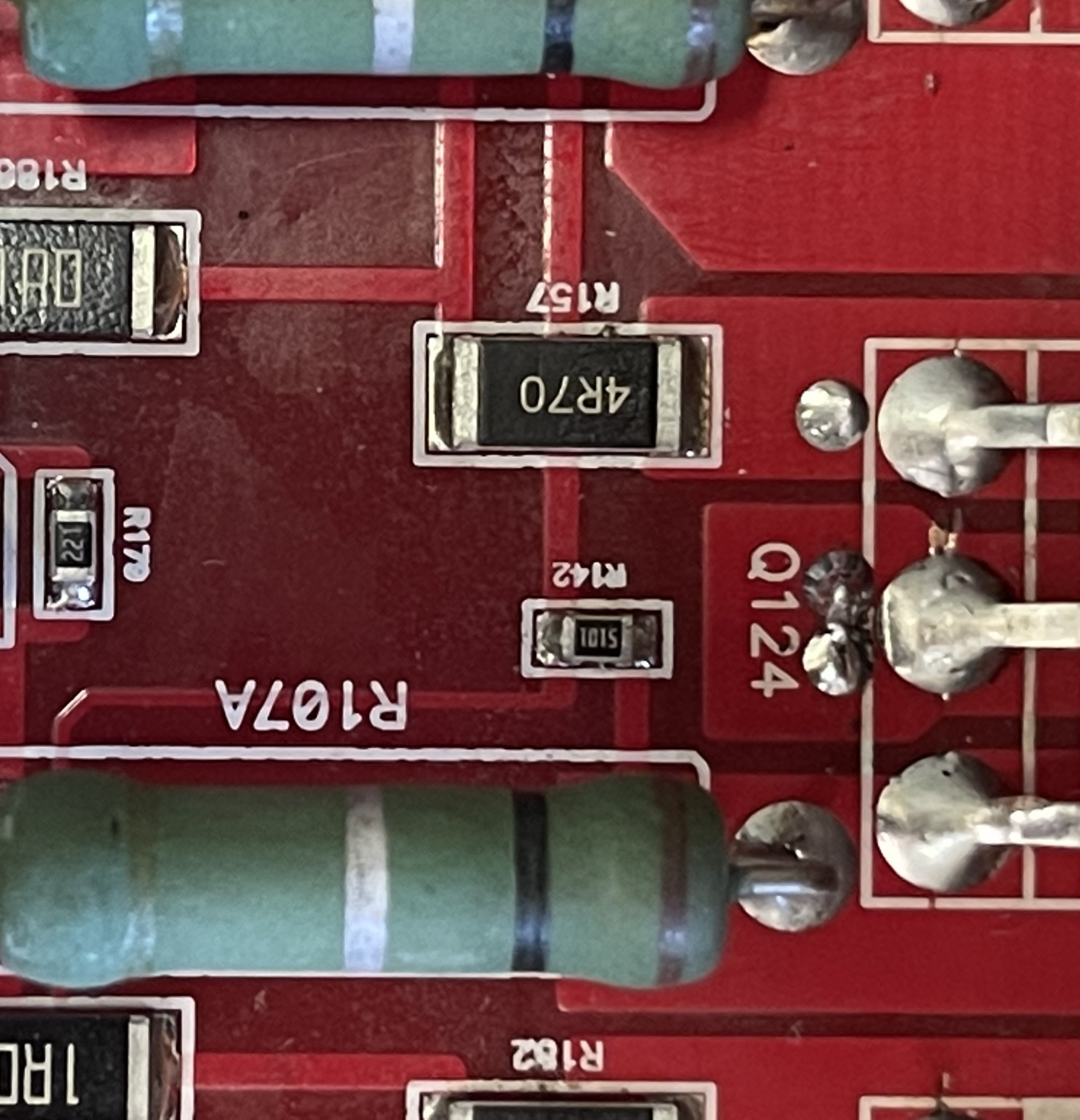

After you asked I went back and actually checked, I just assumed they were all 22 Ω since the 2 resistors that were in different spots read “220” on the resistor and all 4 resistor locations (wether populated or not) read as 22 Ω but the first resistor on each half of the board is actually a 10.1m Ω “1015” …I should have made sure by checking each instead of assuming 🤦🏼 But that makes this even weirder, but I’m not the best at A/B so 😅

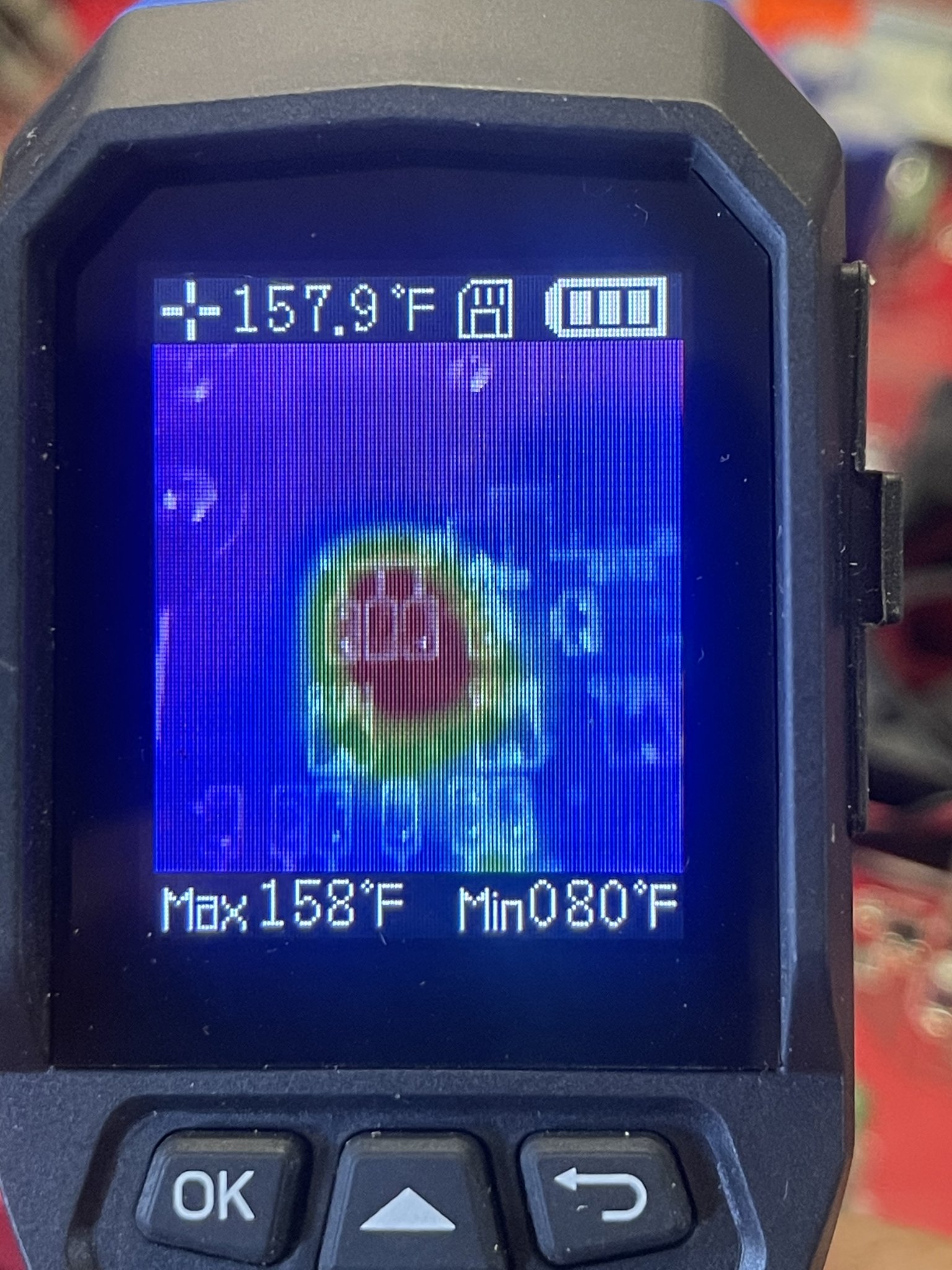

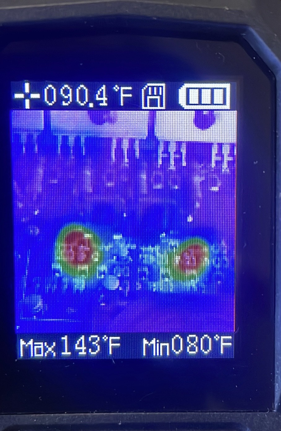

And I think I might have found my problem, my newest addition to the toolkit, and already loving it, thermal imaging camera with picture overlay 🤓 Seems my b631k/d600k are out of spec? Which I can’t seem to find anywhere but eBay 🤦🏼 Searched Mouser&Digikey for KTB631k/2sB631k and coming up empty handed. Is there another model number to search for for these components and their complements? What is usually considered the best brand for these? I need a new set for my HCCA 2000.4 I just got as well 🙂
I’m going retake some thermal pics and get in close with my thermal to make sure, going to probe each component in that area as well to make sure all within spec. 99.999% sure the dc offset problem is in this area 🤙🏻

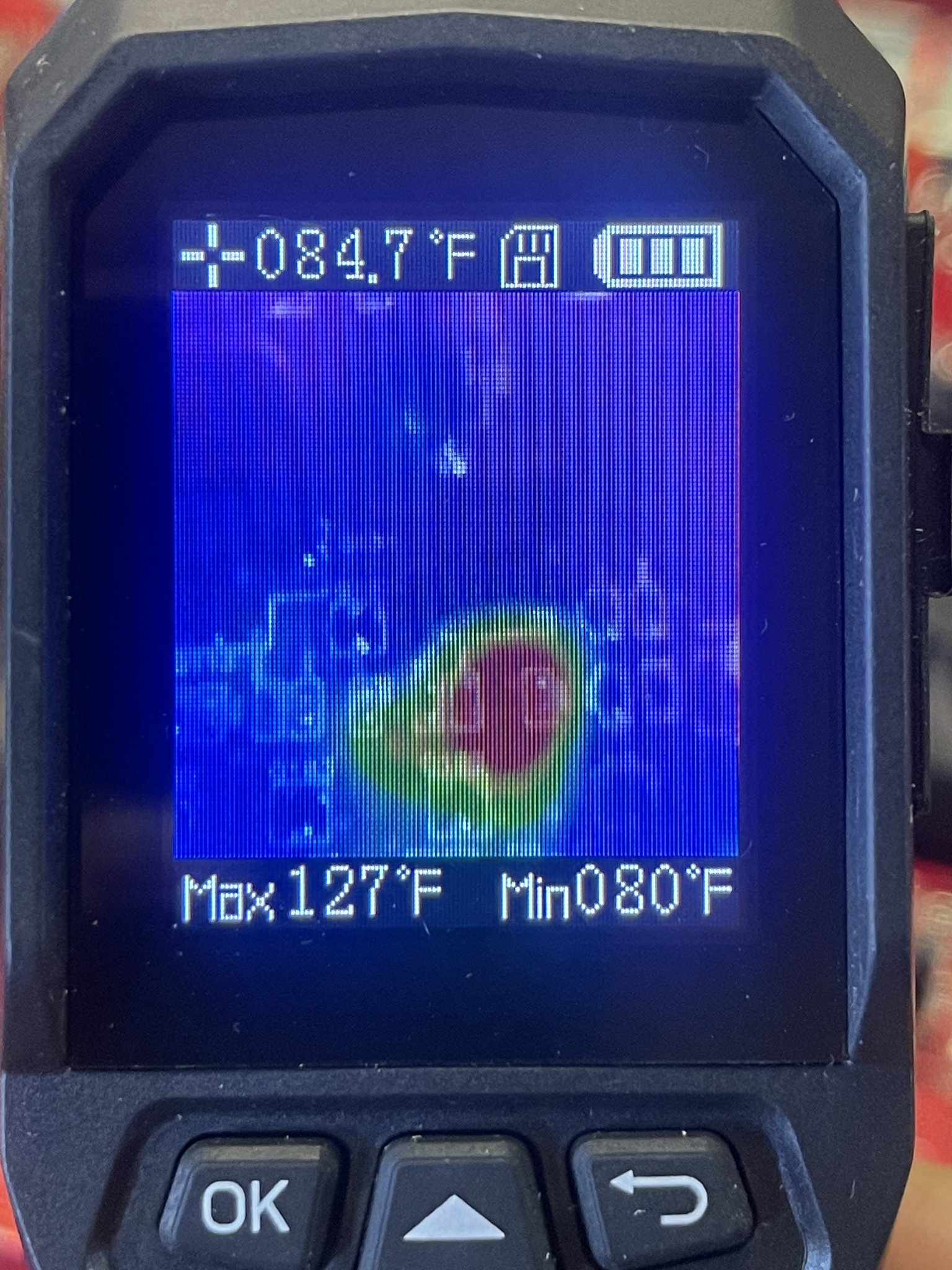

It’s actually a few resistors? in front of the outside 631k/600k that are heating up really bad and you can tell they were replaced with the shoddy prior repair

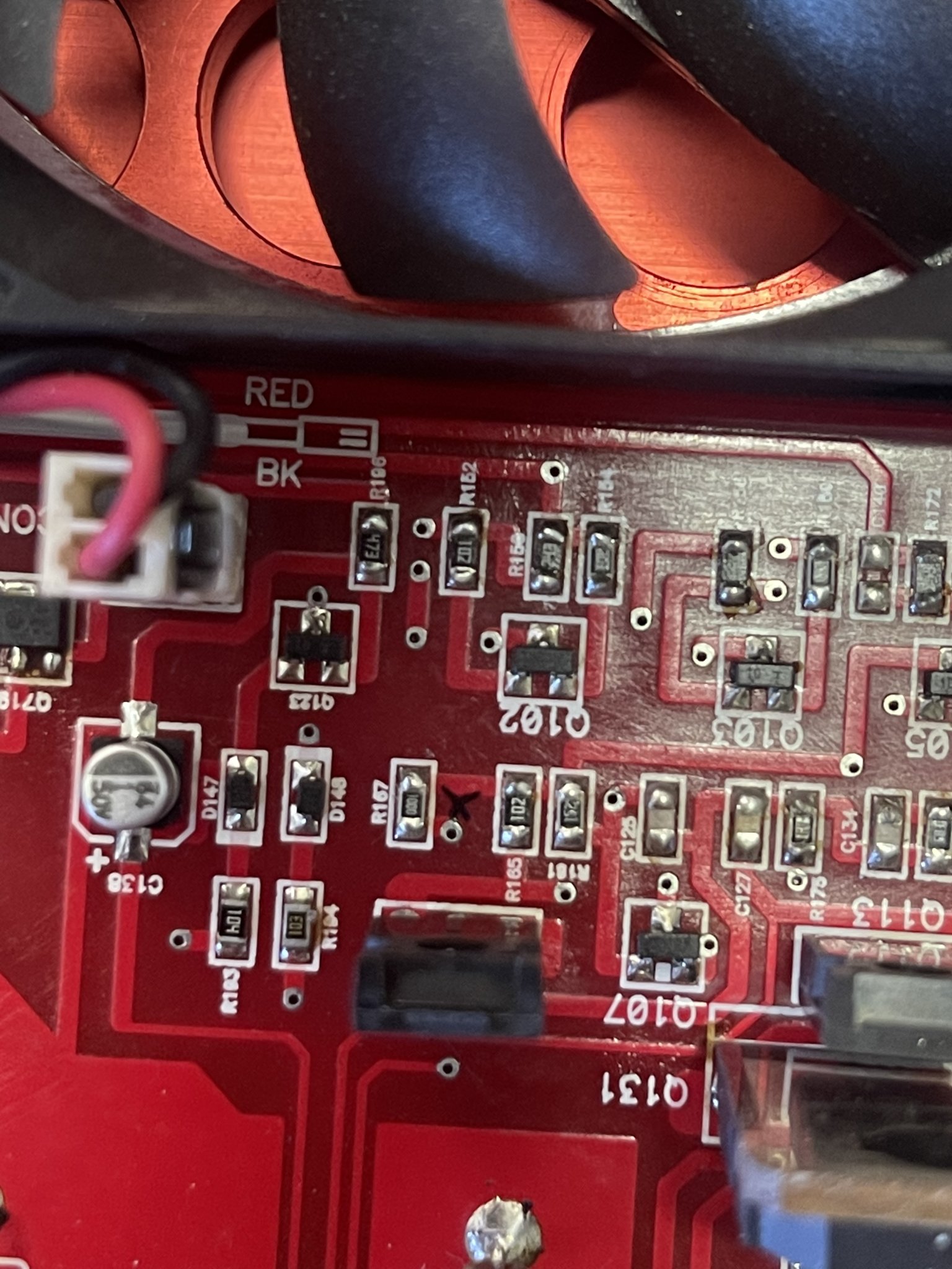

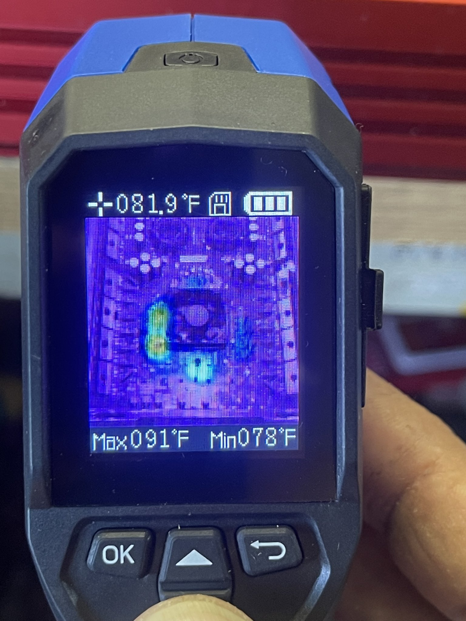

I marked on the board where the heat was concentrated on each side with an X, each of the resistors are within spec on both sides, would the actual component they are in front of be offspec and cause this?

I stepped away from my bench but I’ll check on the values to see if they match (should have done that already) and I don’t have a way to test up to clipping yet, still working on that (waiting for cells now for in-house bank) but the thermal shows that’s really only the thing heating up and it’s fright from boot up, nothing else @ idle even gets warm

Those are BJT, not FET.............and the smd resistors seems like over current detection, where someone remove one or two due to possibly false trigger when playing loud, just my guessing since we don't have a actual schematic.
