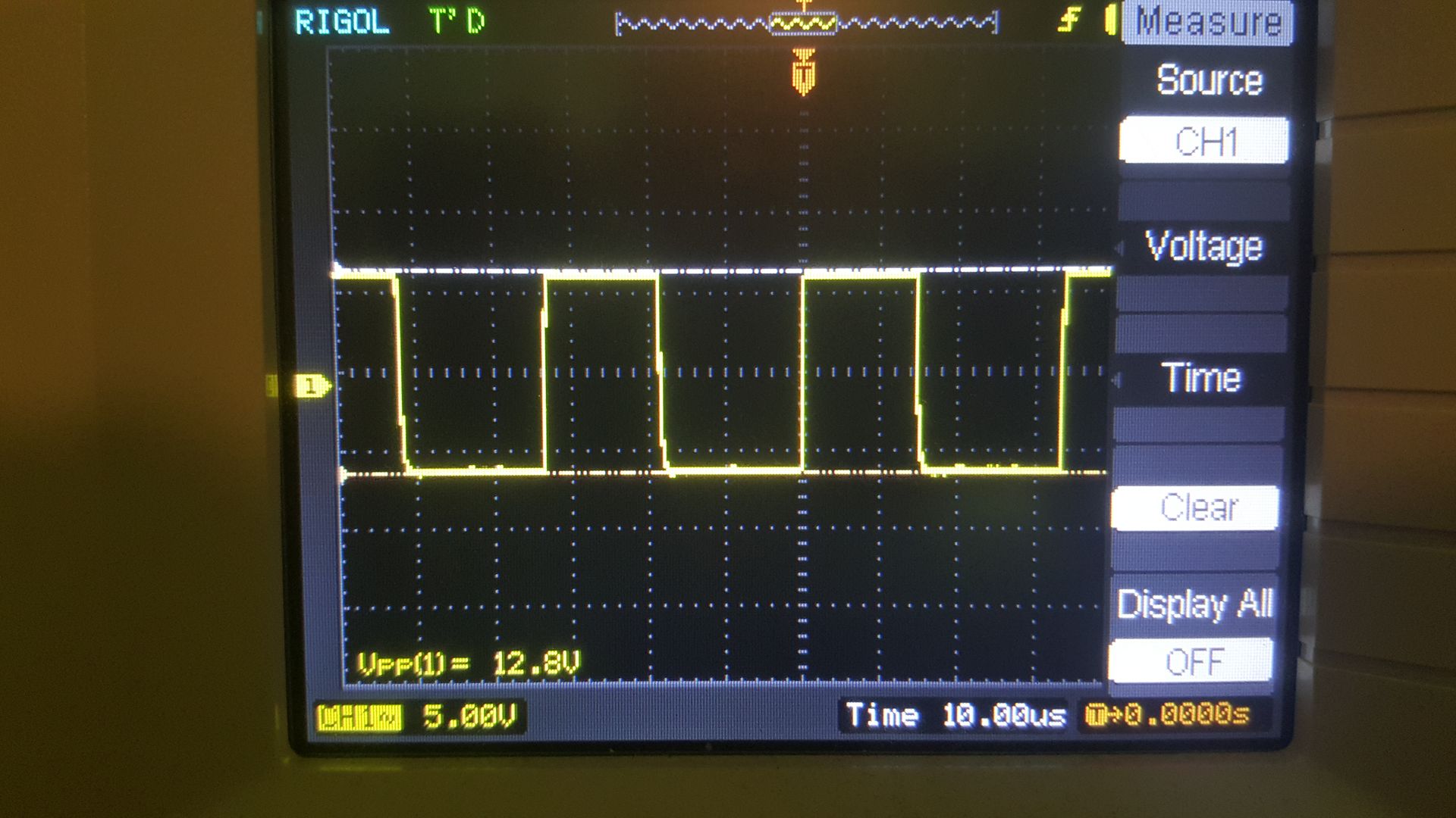

Check the drive signal on pins 9 and 10 of the 494. Scope set to 5v/div and 10us/div. Confirm that you have the same basic signal on the side of the gate resistor (pads) that are NOT connected to the FET pads.

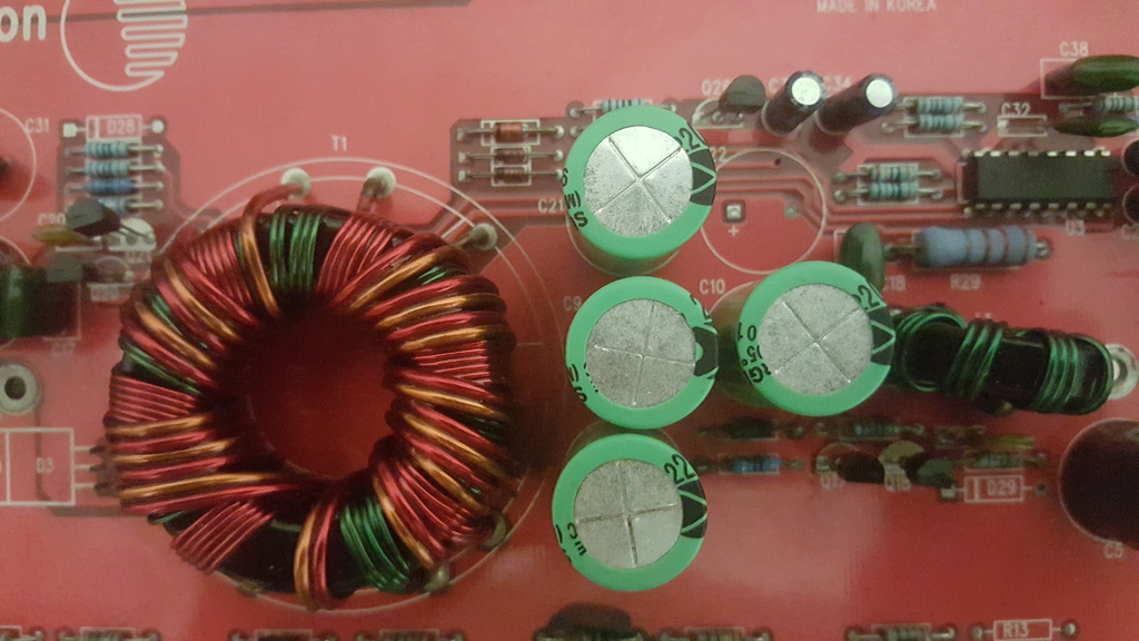

Hi Perry, guys,
No fets came today🙁 but I did set up the scope at 5/div, 10us/div to look at the drive signals but never got the chance. Running at 10 amps the caps c3,c9,c21 all immediately got warm and wanted to vent but the fuse didn't blow so I disconnected power . First I want to make sure I didnt create any solder bridges on the transistors but something is taking the caps above a their 25 volt threshold. If you compare the caps to photos of them earlier on in the thread you will notice they started to bulge in just a few seconds.....
Ideas?
Ideas?

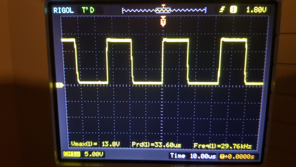

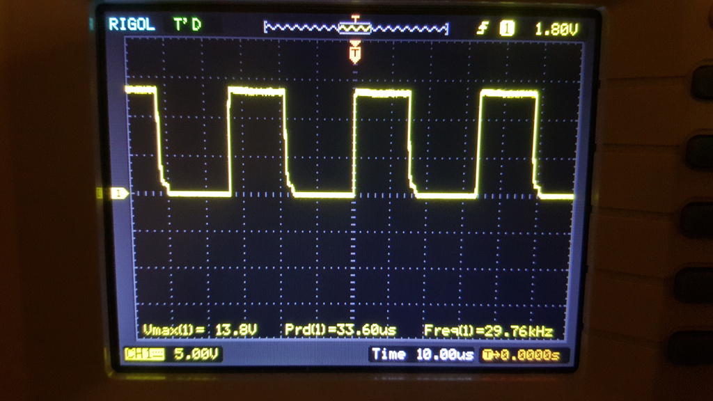

Im an idiot Perry forgive me fellas 😱 apparently so.... Good thing I hurriedly cut power. Seems like all is well is far as the caps heating. I got 12.8 to 13 vpp. square wave On pin 10 on pin 9 it was around 13.8 vpp.
Pin 10
Pin 10
pin 9

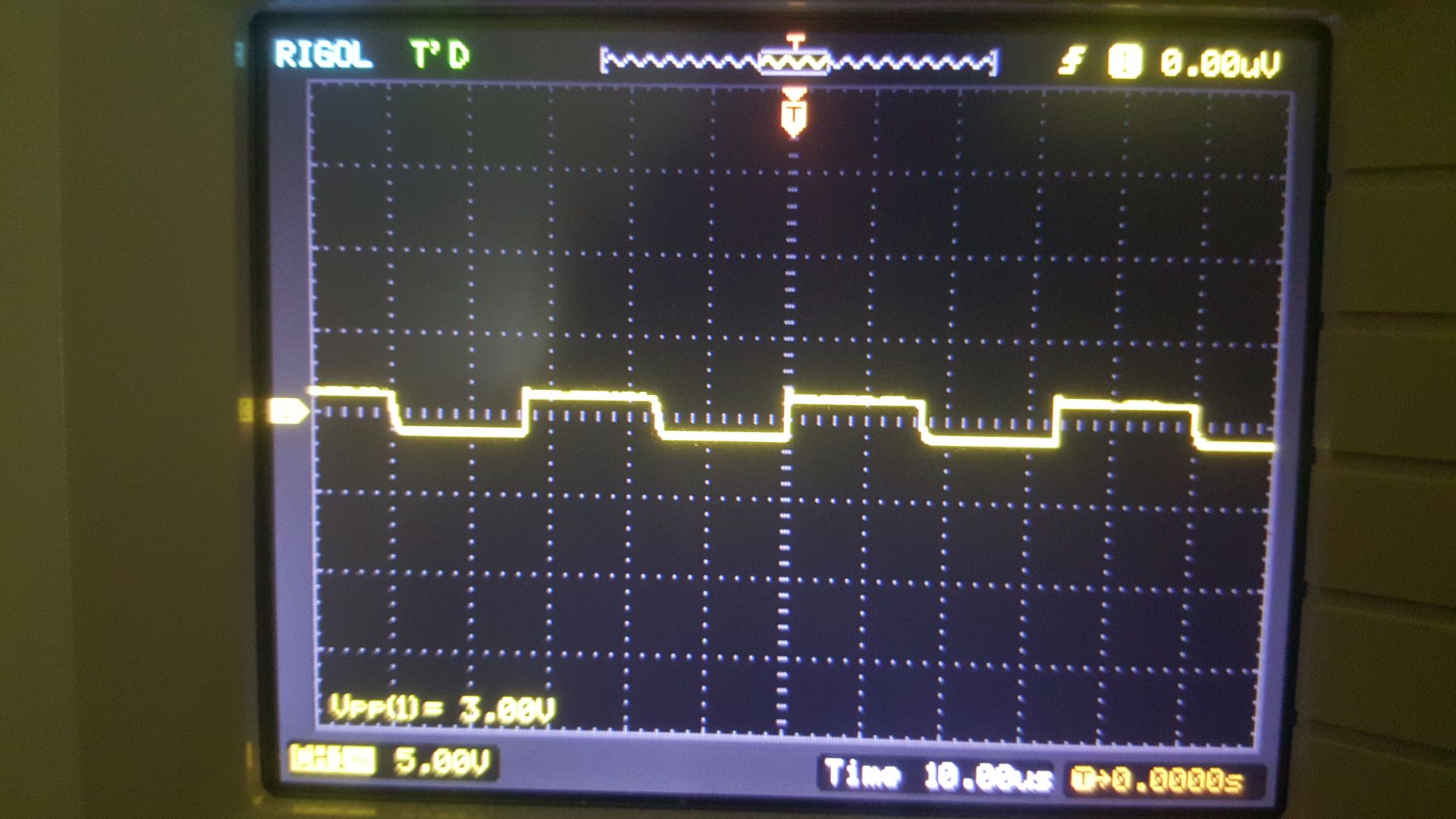

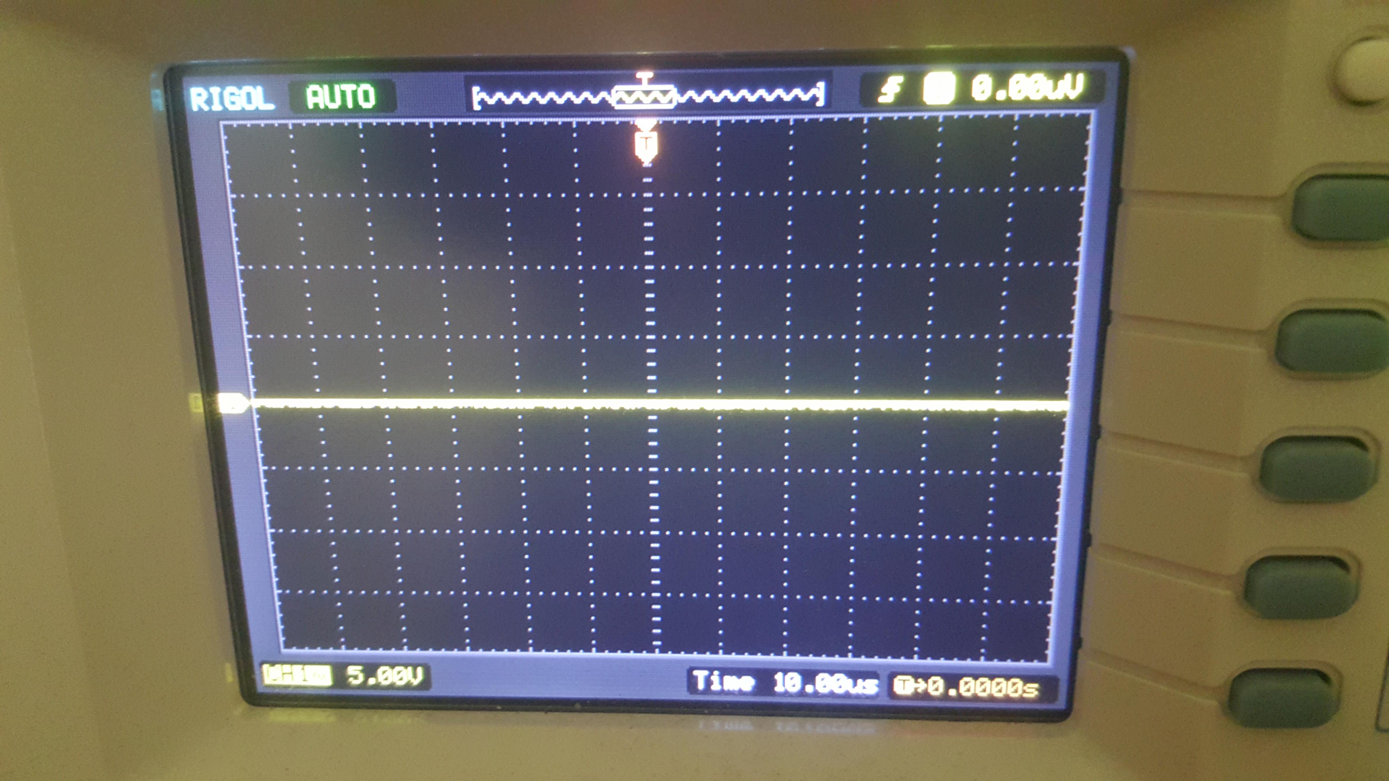

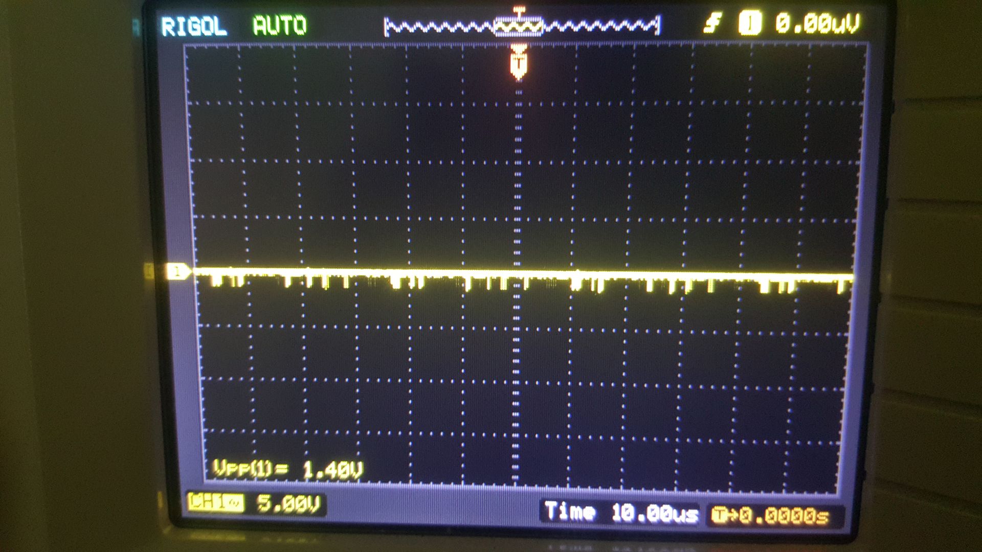

I get a square 3.0 vpp on the signal side resistor legs R5 thru R8 but not the case on R9 thru R12.
R5 thru R8
R9 thru R12
R5 thru R8
R9 thru R12
Looks like R9 thru R12 trace back to the emitter junction at q17 and q18. Thought maybe I damaged them through excessive heat while soldering so should I recheck them?

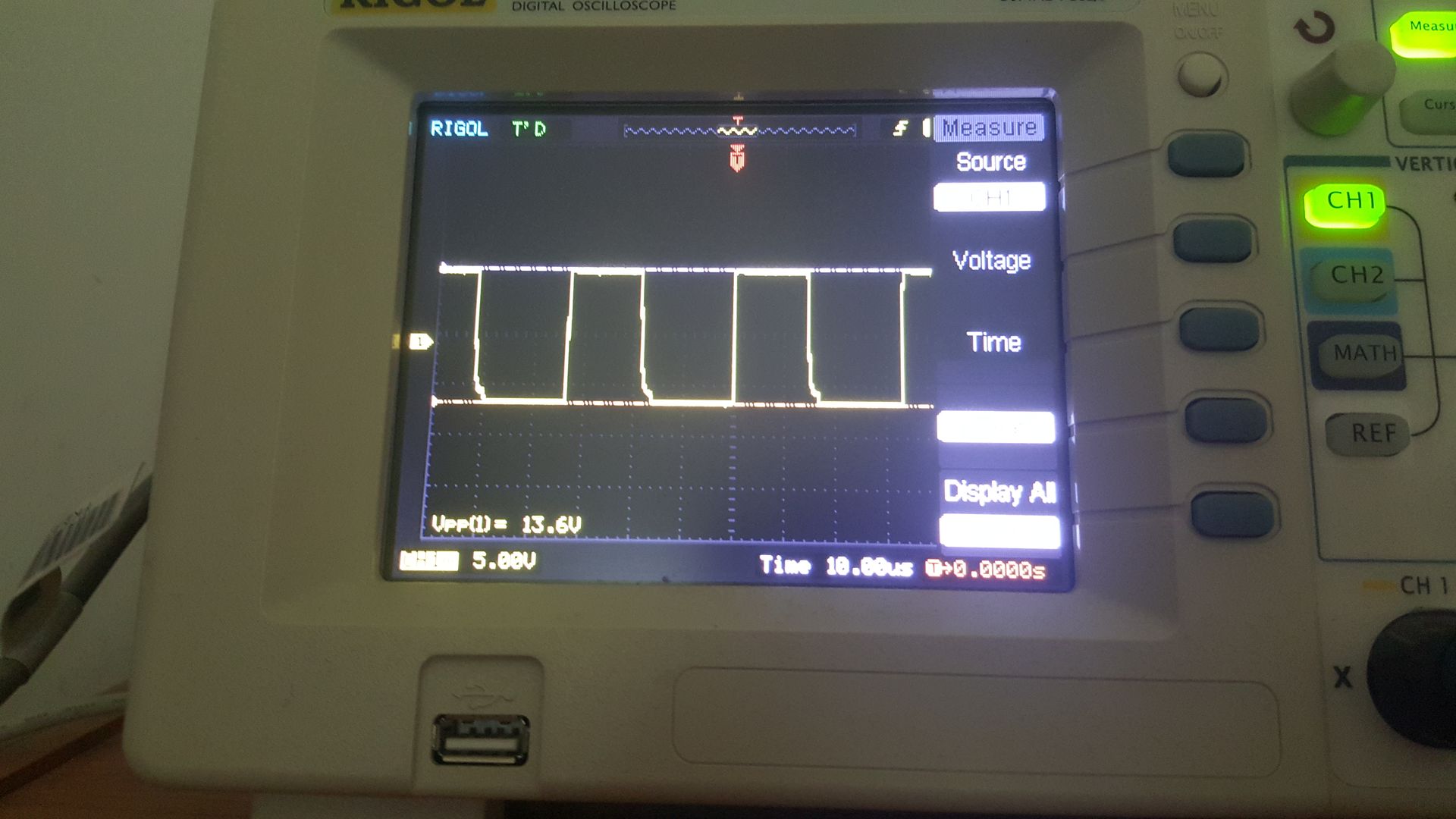

You need to set your scope to DC coupling.
Doesn't that scope have the ability to generate screen caps?
Dc couple is on. Yes it has screen capture but it is hooked up to another pc whose internet is very slow. A real hassle to upload from.
It makes the waveforms useless because there is no reference. Please read through page 73 of the BCAE1 site, paying particular attention to the 'best initial settings' section (which includes the reason for DC coupling).
It was engaged at the time the photos were taken. Its choices are DC, HF reject, LF reject, and AC. It was on DC.
Ok I did a self cal and it set the scope to dc couple correctly I believe its set right now because the dc symbol; the dots over the solid line is whats in its place now versus "~" in my first scope photo.

Sorry for the delay. Here is Pin 9 left and pin 10 right.
I also checked the 5 color bands of the resistors and got brown black black gold and brown. The calculator kicks out 10 ohms at 1% by the size Im just taking a stab that they are 1/4 watt.
