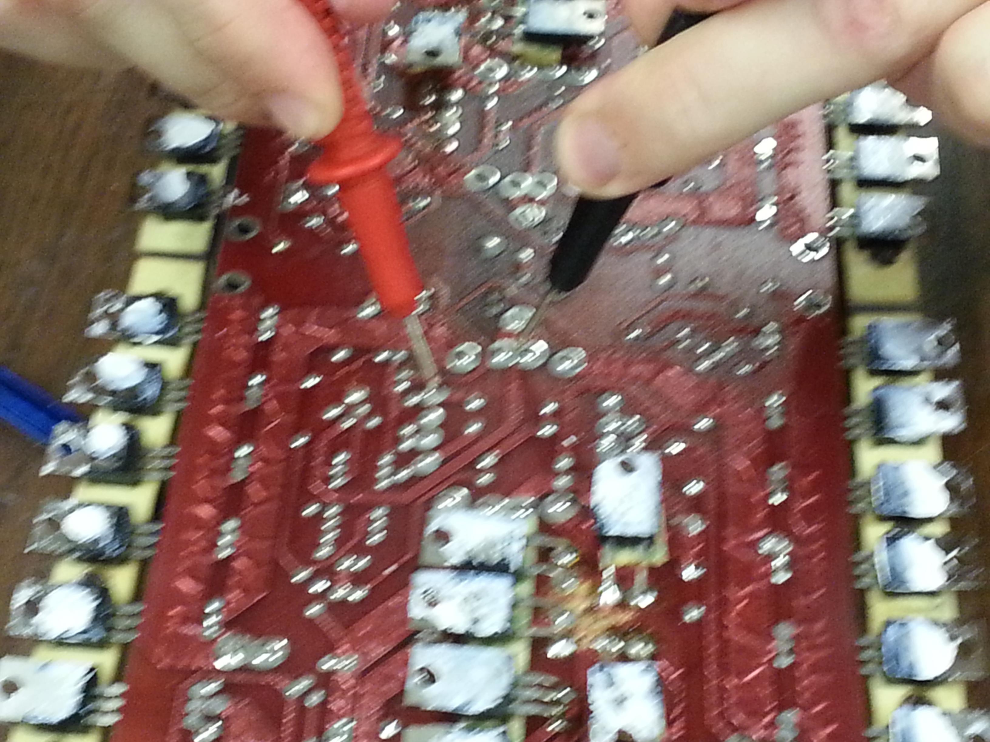

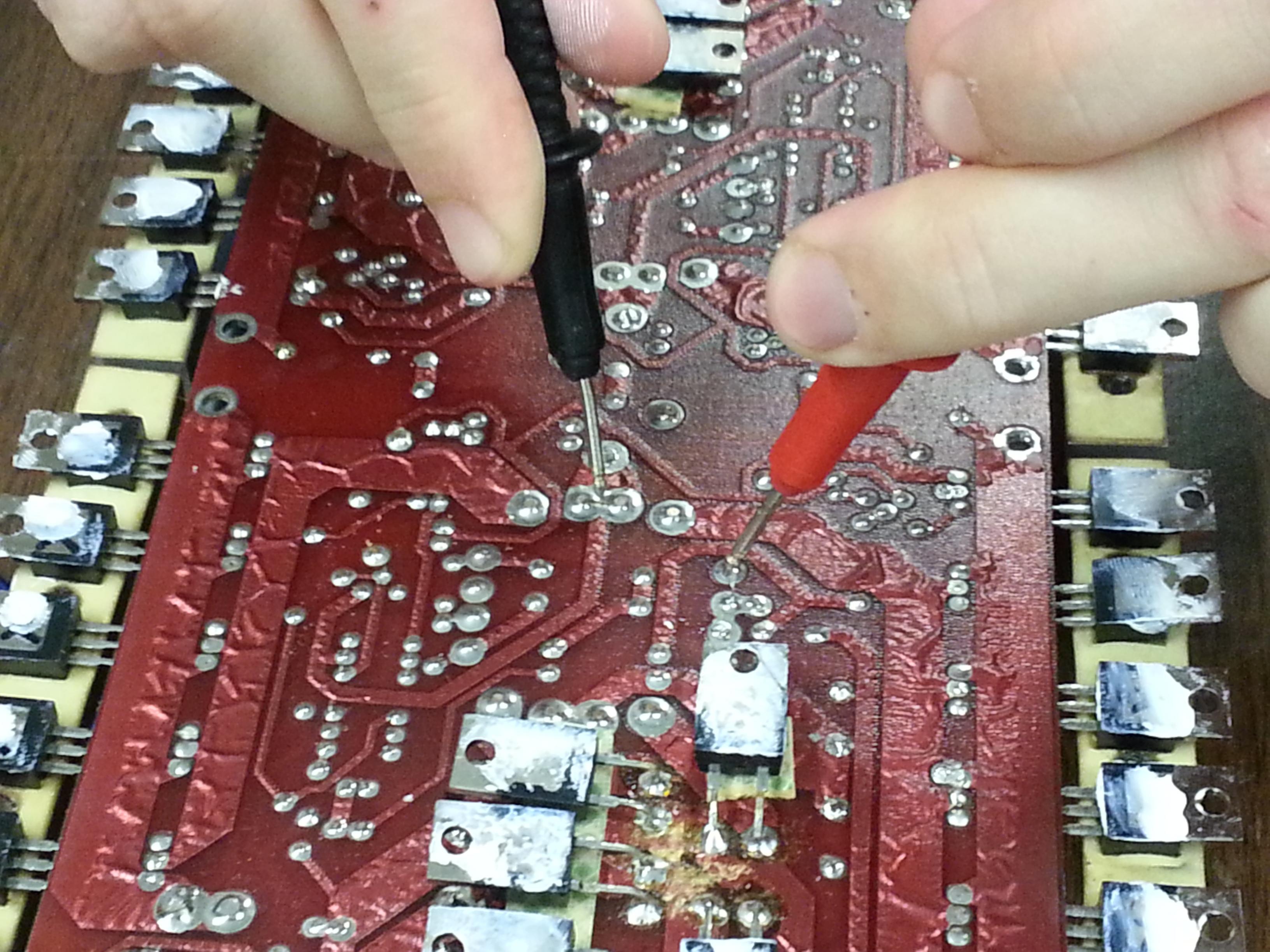

It was drawing excessive current when I measured voltage to the transformer. I would test one point at a time and leave the amp running for <5sec each point. When measuring from the input center tap of the transformer, I saw voltage on the top side, but not the bottom.
In picture 147 I measured ~5VAC. In picture 205 I measured ~0. I am not sure how the transformer is wired so I do not know if this information is valid.
Note that the power supply was current controlled so it was only operating from ~5VDC.

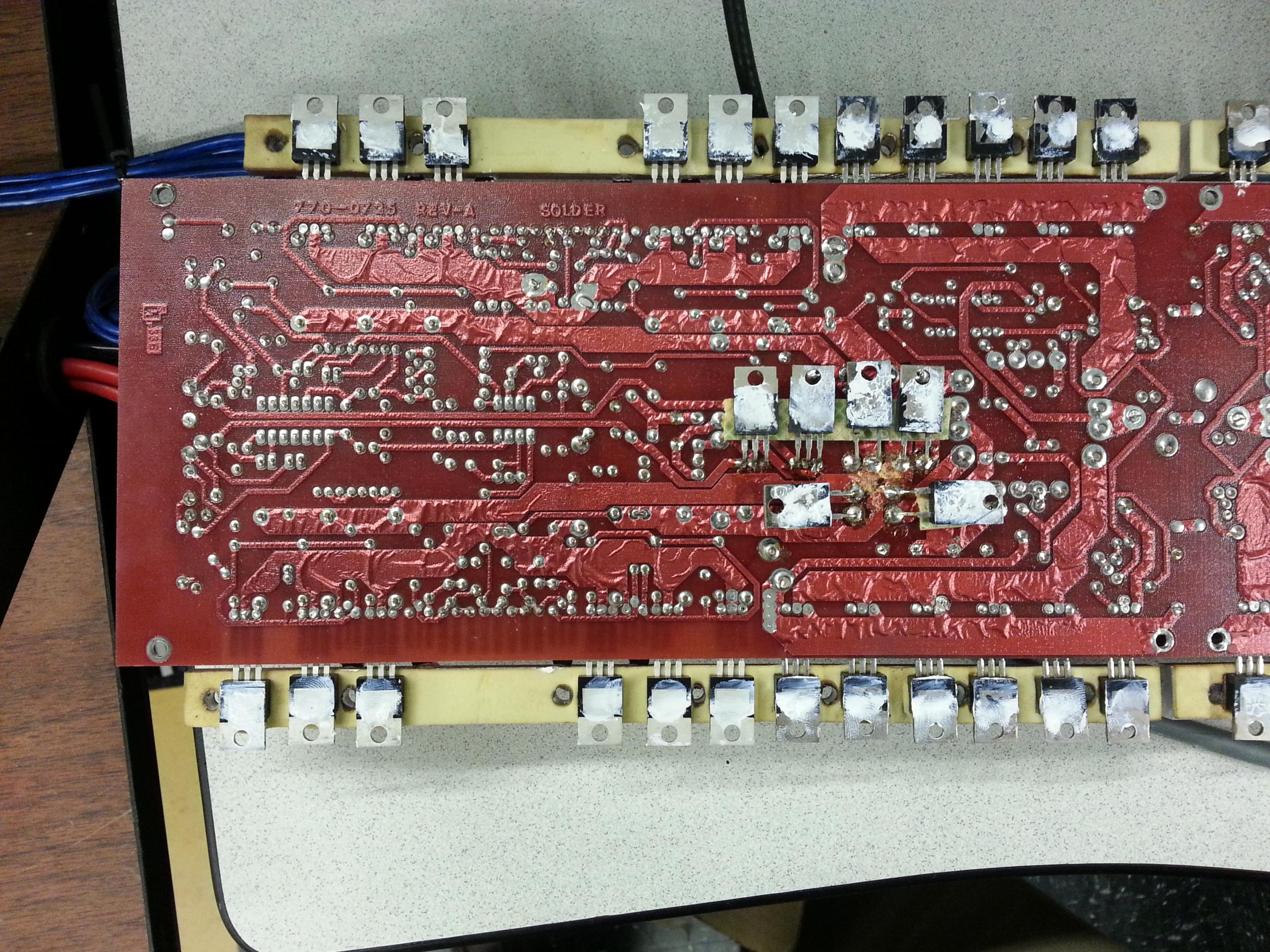

I found 1 of the three shorted. I went ahead and removed all three and am noticing a short between where the collector and emitter pins would go. I made sure my output wires are not touching and am not sure what else in this part of the circuit would be causing the short; I did make sure there aren't any solder bridges.
I don't think that there is any component connected across the collector-emitter.
Are you sure that you have the pin configuration right?
Did you use a lighted magnifying glass to look for bridges? For some reason, Orion amps have a tendency to form a hairline bridge along the edge of the board.
This was exactly the case, there was a bridge between pads on one of the parts. I replaced components and it tested well. I also changed out the gain pot as it seemed to be going out, now all is well and next step is to install in the car.
