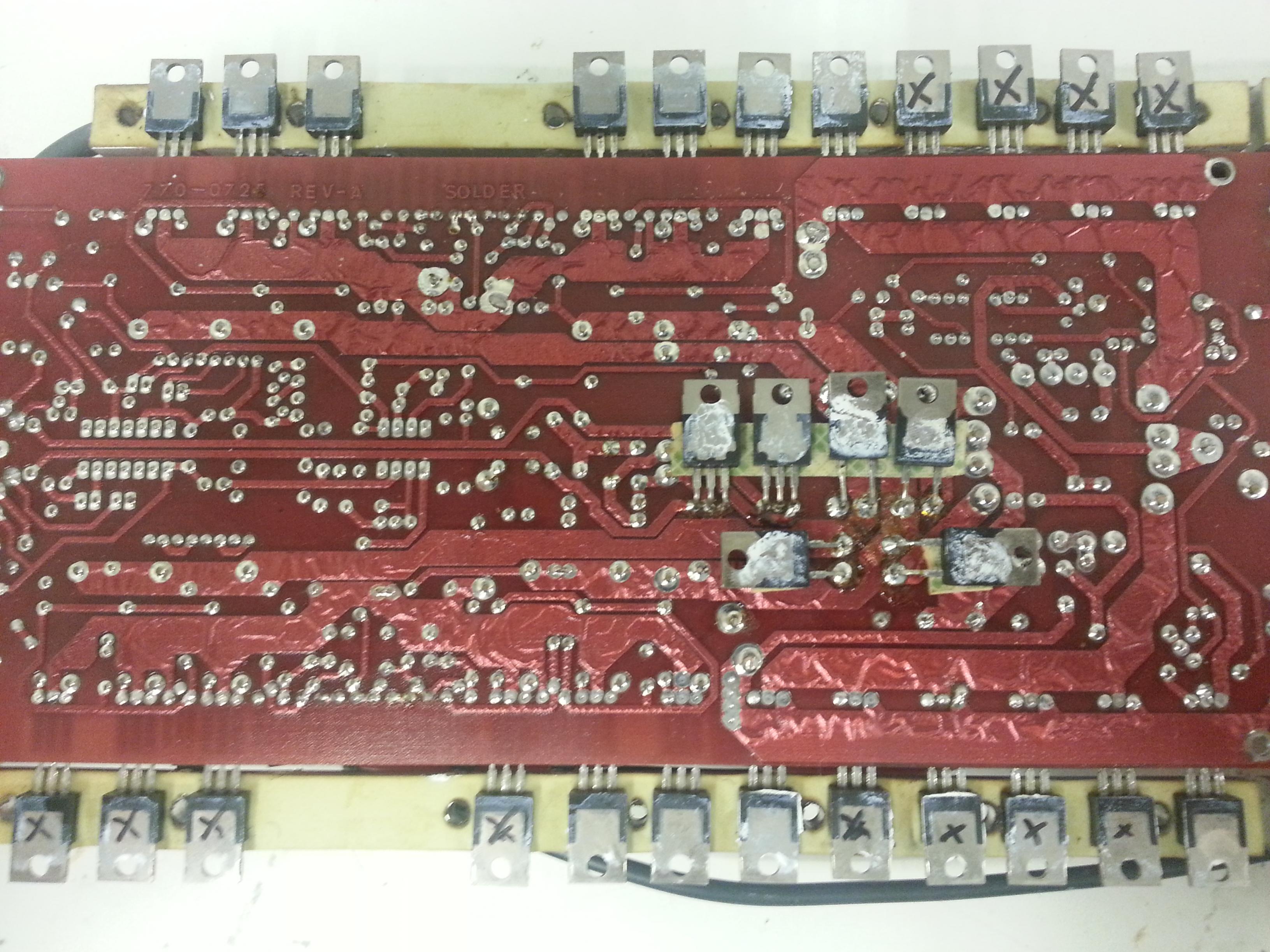

Perry, I’ve got a Orion 4100GX amp and I recently went to test to find the amp caused my power supply to go into current control(~21A). I found that one of the two amps inside(the right channel) was causing the problem. I did some initial measurements to try and see where the issue was and ended up removing the 4 rectifiers (MUR810). These tested fine(forward drop of .42V and no connection in reverse). Further probing of the device without the rectifiers, I saw that one of the power rails showed a 1.2kohm impedance where all others showed greater than 1Mohm.
I did try testing to ensure the issue was only after the rectifiers, however found the amp to draw ~1.5A and quickly turned off the power supply. I did note that the current remained flowing even after removing the turn-on wire.
Do you have any suggestions on what I should test and the best way to do so? From the measurements, it seems like the issue lies on the power supply with the low impedance, however I cannot explain why the amp draws current without rectifiers in place.

Connect only one red power wire at a time to see if the amp will power up both channels (one at a time).

What gets hot when the right channel is connected? Connect for a few seconds, remove power and check to see what's warm/hot.
Perry, I used a thermal camera to evaluate and have attached pictures. All pictures are alighed with left side of the amp corresponding to the good channel, right to the bad.

For the channel drawing excessive current, which of the TO-220 transistors are getting hot. For me, the resolution of the thermal images wasn't sufficient to be of any use. Just touch them and see which are hot. Post a photo indicating which ones heated up the most.
There are 3 outputs grouped together but only one has an x on it. Remove it and clean the pads to ensure that there are no solder bridges. Does that change anything?
I don't understand what you mean with the 3 outputs. It seems like the output(yellow wire) is connected to a group of 6 TO-220 packages(top left of picture). Can you further describe which package you are talking abot?
There is a group of 6 outputs for one channel. There are two groups of 3 for that channel. One group of 3 had 3 Xs. The other group of 3 has 1 X. Remove the transistor with the X in that group of 3.
That does seem to be the issue. Before removing the component I measured resistance to be ~200 ohms between pins 2 and 3. After removing it went up to Mohms.
I'm looking to find out what the part number is. The numbers are not legible, but it looks like 2N6438. I can only find that part as a TO-3, so it doesn't look like I'm able to read the part number well enough. How can I go about finding the part number, or selecting an appropriate alternate?

Thank you Perry. By the way I did go ahead an turn on the amp(no load) to ensure the short was fixed and both channels now draw standby current of ~.8A.
I'll go ahead and replace all 6. Should I also be replacing the complementary 2N6490s or is it only important to change the ones in parallel with each other?
