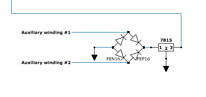

One of the small rectifiers at the end of the 9 mosfets is reading low (less than 10 Ohms, moving around) tab to sink. That's just holding the tab down on the tape with the probe. Center tab also, less than 1 ohm
Does it have any burrs on it that are cutting the tape?
No, but both its tab and center lead read short to the mounting ring where the board mounts to the sink. The other transistors, including the corresponding rectifier on the other side, do not.
That's one of the rectifiers that produces the power supply drive voltage. That should not have any contact to the secondary (causing the RCA shields to read 1.8 ohms to the sink).

Just laying the board into the sink causes the tab to sink reading to go short. Slowly lift it out and it goes open ... for the one rectifier.
For which transistors?
Just that one rectifier. Not the same one on the other side, or any others. Its tab and second terminal is shorted to the metal mount points on the board that touch the sink when you seat it. They are ground, there are four of them on the power supply side where the board screws to the sink. In other words, its tab a second terminals are shorted to ground.
If the tab is connected to the grounding pad, that's OK.

OK. Well that's the only one reading short from tab to ground and if I follow I guess that is OK.
You can't ignore the short that you had between the shields and ground.

It now reads the same seated or not. Before, it would read short. I ground back an overly large solder joint that was near or in contact with the sink when the board is seated.
WAS the din shorting?
No
This has been corrected. Still noise.
