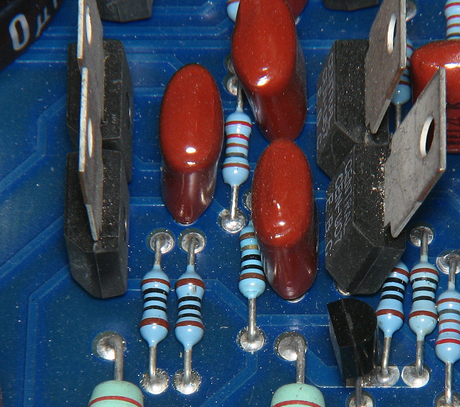

In the attached image you can see the 07 and 57 pre-drivers. The drivers to the left of those are reversed (07 at the top, 57 at the bottom).
For when you have to remove the clamps, I'd suggest that you do it like THIS.
I know that. I actually ended up using somewhat matching transistors that came out of the Orion 2150; same vintage. I'll have to ask the owner if he wants to pay the $$ to replace them with brand new pieces. I'll probably need new emitter resistors too. Really, this amp came from a collector and will likely never be run. He's got like 6 of these under his desk! LOL! Hes giving me a lot of work!
