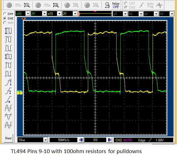

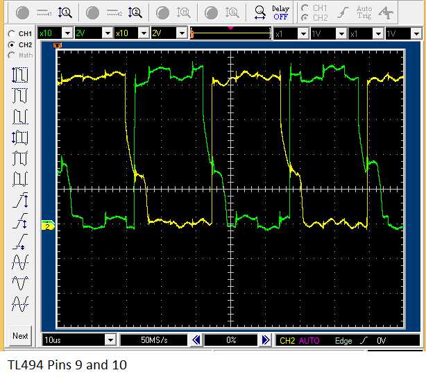

I think the problem is the drive circuit is marginal go/no-go for this many 3205s.
Assuming that the 1k pulldown resistors are back to 1k ohms (on the main board), I'd try replacing the two 220 ohm pulldown resistors with 100 ohm resistors. They need to be rated for 1w if you use them long term but a 1/4 or 1/2w will tell you if they're going to make a difference.
You can try the other drivers. If they're faster, they 'may' help. Any other solutions I have would require mods that would not leave the circuit looking like it came from the manufacturer.
I removed the 3205s and now the square wave is good. So you are right the drive isn't pulling down hard enough to discharge the gate capacitance fast enough. The C1815 don't look to be any faster per spec sheet.

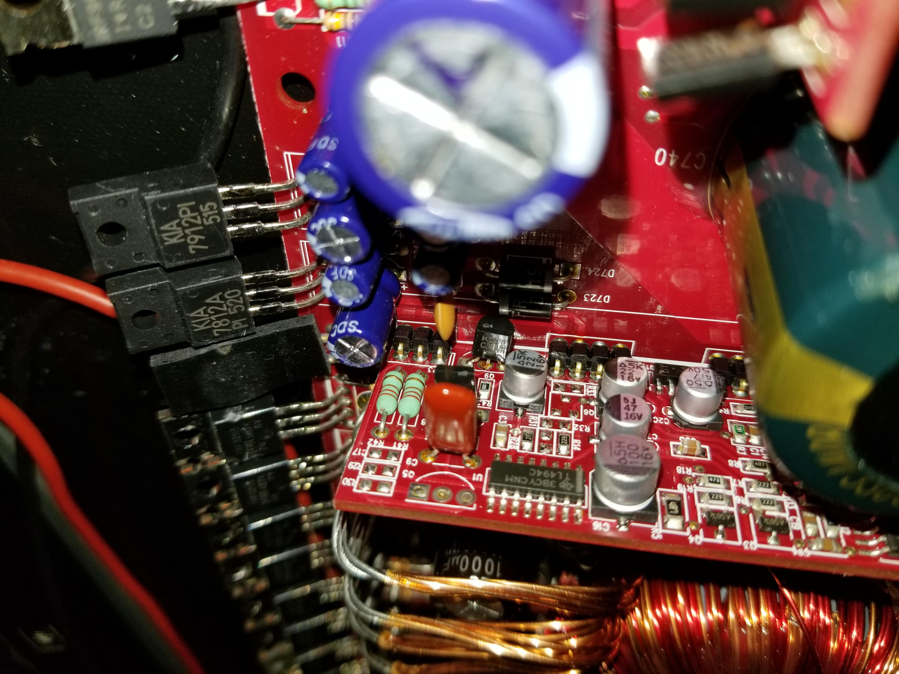

Back to those resistors that I said were getting hot earlier. They are not 22k. They are 2.2k (red red red) and I tried replacing them with 22k and the amp started pulling 10+ amps and smoked the 2 PSU supply FETs.
Anyway, those resistors have nearly 120V across them. 120/2200=0.05 So they should only draw only 0.05A each. That's over 6 watts so it makes sense they get hot, but wouldn't be the cause of the current draw.
