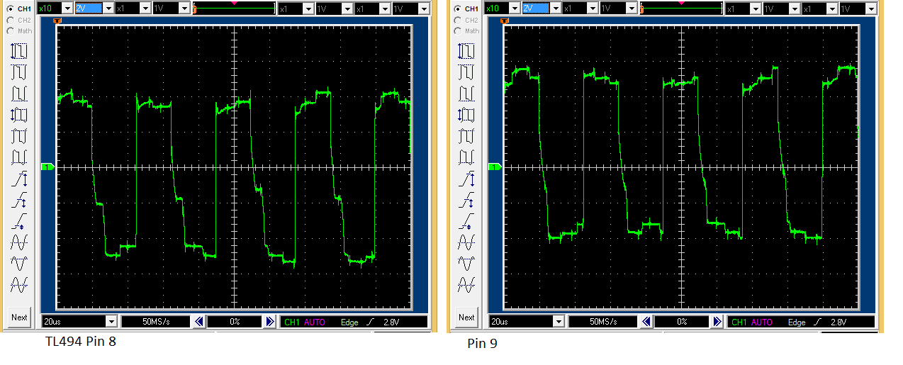

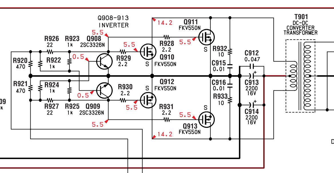

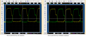

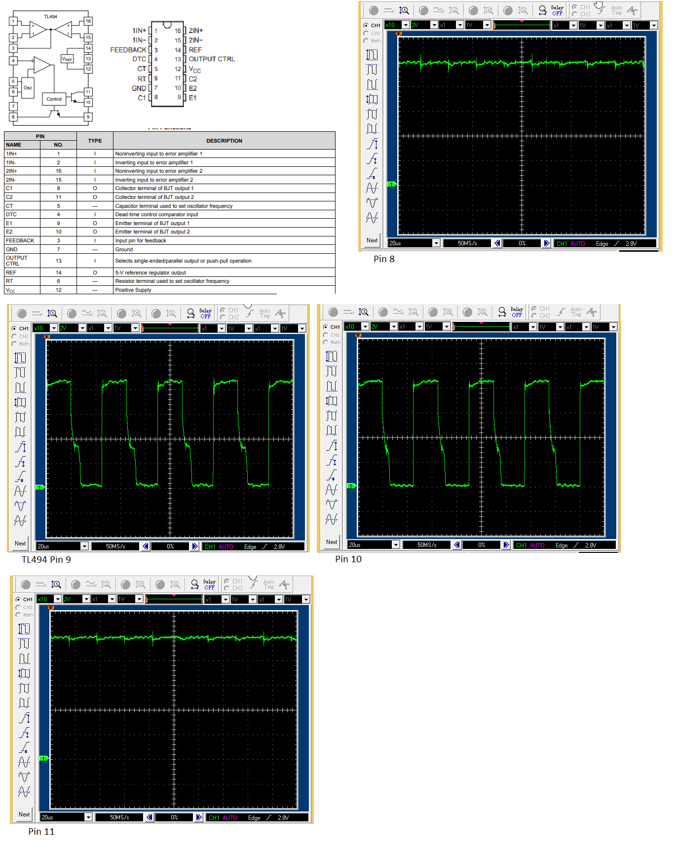

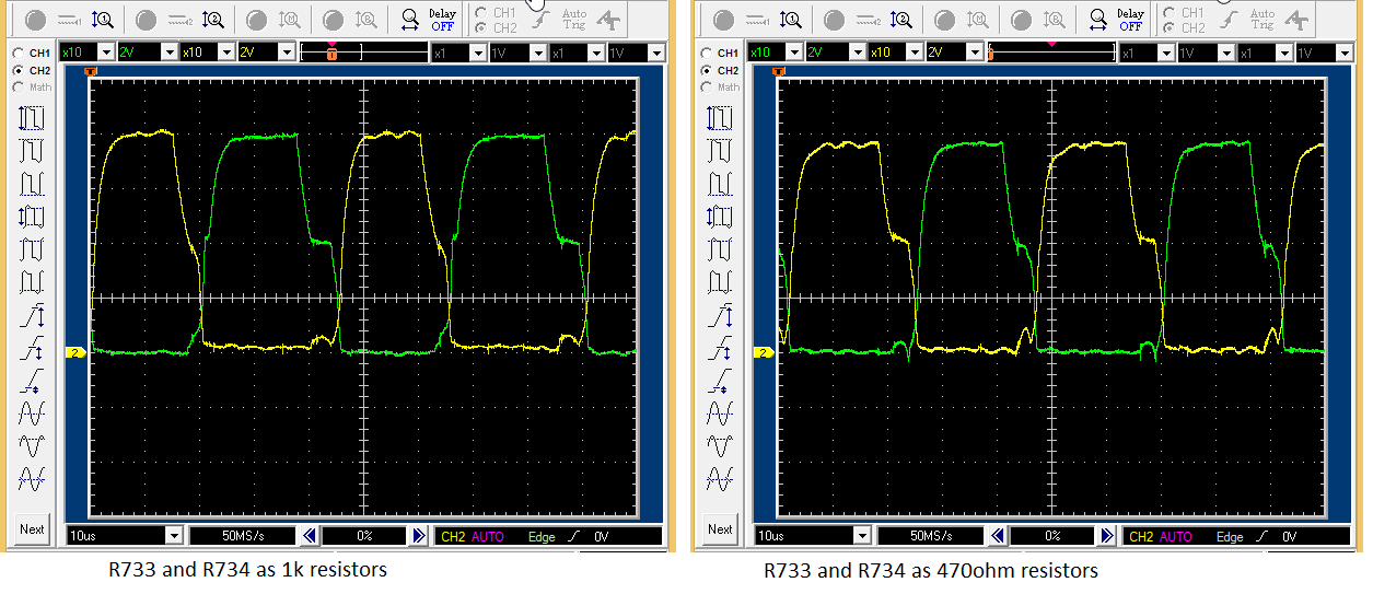

3 amps is idle with under 10V. I've just never seen an amp draw this much at idle; doesn't seem right for just the audio section of the board. I admin I could be wrong... The original issue was that the amp wouldn't output audio. The Relay circuit was burned up badly.
Output transistors not heating. Initially the high current draw is the same as it is now; also Sam (barevids who does live amp repair streams on Youtube) always suspects something isn't right when there is that much current draw at idle and he's usually working on much bigger amps...
