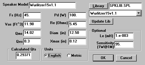

Well A stronger motor than I realized
Well I got some handitak and did a careful job of measureing the params using the tsparam spreadsheet and using the added mass method of Vas measurement.
Well my earlier measurements underestimated the strength of that big honkin magnet. It looks like it will not only make a good TL but an excellent horn driver as well. Hornresp simulated a very nice 10.5 foot long exponential bass horn with smooth response from about 30Hz to nearly 400Hz giving about 110dB/Watt. TL is rather less efficient but still models about 113dB@25watts which would be maximum excursion given my guess of 3mm Xmax. Still no slouch. The horn would reach maximum excursion with only 7 Watts but sould be putting out about 118dB.

Greets!
With a near 10% midband efficiency, it can theoretically be loaded to as wide a BW as ~6.75 - 630 Hz without too high a CR or ultra low flare rate. Not to mention a fine scoop horn driver. Apparently Jensen's version of the Altec 515 basshorn driver of the day. If so, then it probably has a somewhat higher Xmax, which seems reasonable considering what app it was designed for.

Great. Next step is to get together some scraps and build something. I will start with the TL as it is bound to be easier and will most likely be a huge improvement over what I am currently using (in SPL and quality if nothing else).
