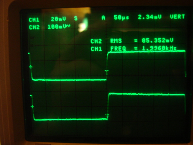

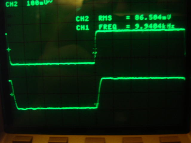

Personally I prefer it to previous. The ''oh so little more or less'' leave it for later when in stereo and familiar for listening for it too. I see a tilt to the right of the top? Can you close the time scale a bit and show? Also the cap types will do a bit of a difference for fine value choice.
Unfortunately, I already took it off the bench and inserted it into my system. I am allready there in regard to leaving any other fine tweeks for later when the other channel is together.
What do you mean by tilt? I do have a decay of the top and bottom of the square wave. You can see it in my earlier posts, particularly on the lower frequencies. That seems to be deeper in the amp as it is there with or without feedback.

I mean the flat top of the square wave leaning to the right. FFT it for 20Hz to 20kHz or more with pink noise and 1/48 octave or white noise and full Log on a dummy load at a point so we know if its extending OK. The caps are cool, I just wanted to know they aren't less than CG0 ceramics.
Ok, I will run the white noise tomorrow. I have cleaned up for the night.
I did run a quick sweep on it before I moved it, and saw the output drop off just north of 100kHz. That was just a qualitative test no numbers recorded.

P.S. Was it extending to 20Hz OK at some Watts? Because the tilt to the right makes me skeptical you see. Normally implies some LF roll off.
If the left hand pole is steep it can explain the tilt since you got -3dB at 20Hz. Only see it holds for some power, it ain't bad especially if more feedback will congest the tone. Are the speakers big? Forgot to congratulate you on your very cool new HP gen & scope set!🙂

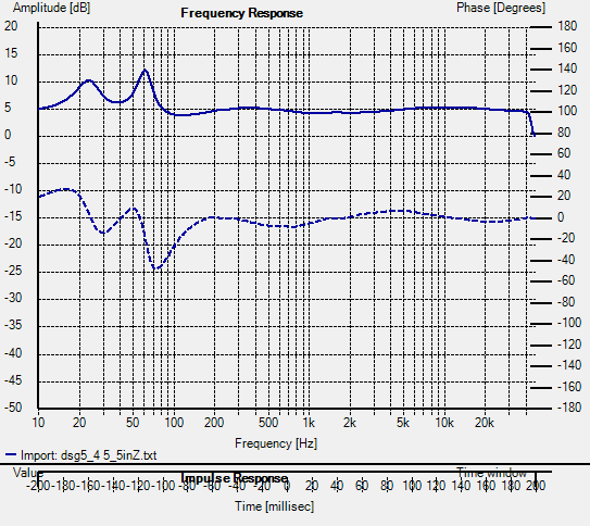

Speakers are scan speak 18M 12 and 2904 4Ohm Attached is the impedance curve of them. Pretty easy load.

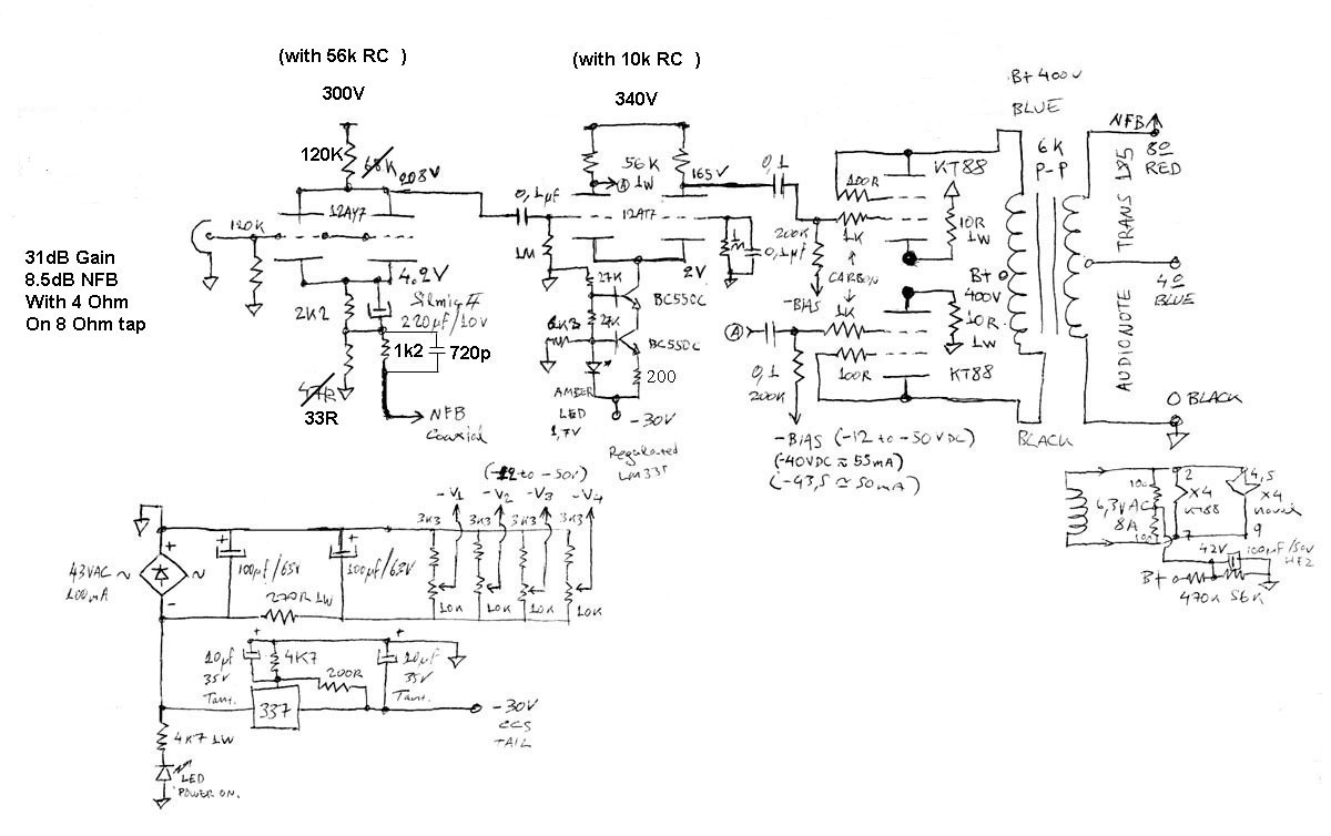

On just 6.5inch you will possibly be OK with such feedback. Interesting is that I use triode KT88 on English AN trafos, you use UL on American, plus Mosfet followers, me 12AY7 in, you 12BH7, and we prefer 8.5dB NFB and find 720p comp cap best. Weird. I use a different way to get the same 4.3K PP. I load a 4 Ohm speaker on the 6K OPT's 8 Ohm sec tap.
Another difference is that you decoupled the driver from the LTP. What is the gain of your input stage. I assume you are not seeing the 40 amplification factor of the 12ay7.
With feedback, I get voltage amplification of 6.9 or 16.8dB on that stage.
I looked in my files. X26 or 28.3dB. Yes I use a cap so I could use any front end tube and voltage level. 12AY7 I liked a lot in the end. Has nothing to do with 12AX7 absolutely, and it gave me the under 9dB NFB I was looking for. The splitter's CCS is cascode also.

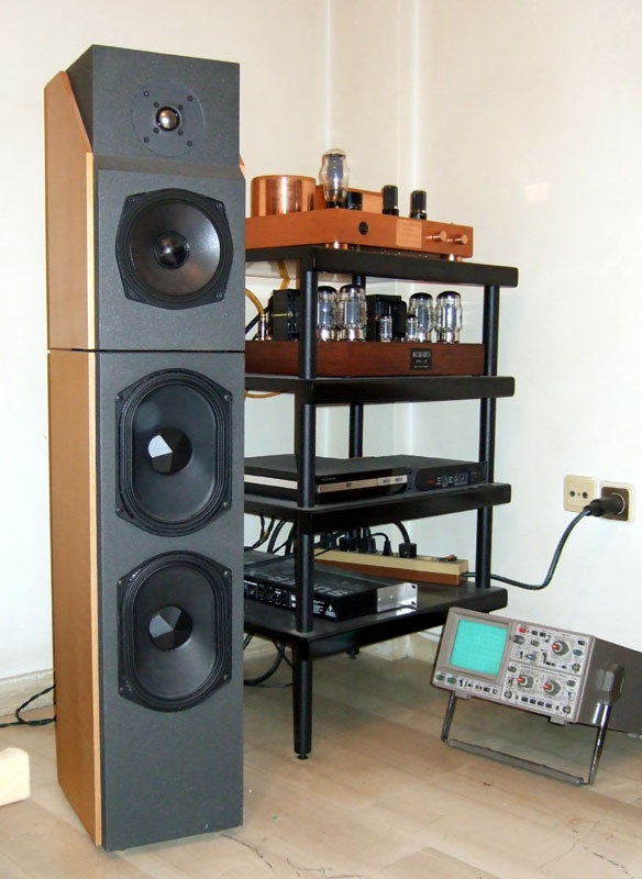

Comfortably I made 95dB speakers with PHL midranges so 20W are OK and I could triode it. The Scans will appreciate the source followers and UL.
I gutted a donor Korato case, had the Audionote OPTs on, made it there, but I have to match the wood color at a point (I am lazy, i.e. never).😀

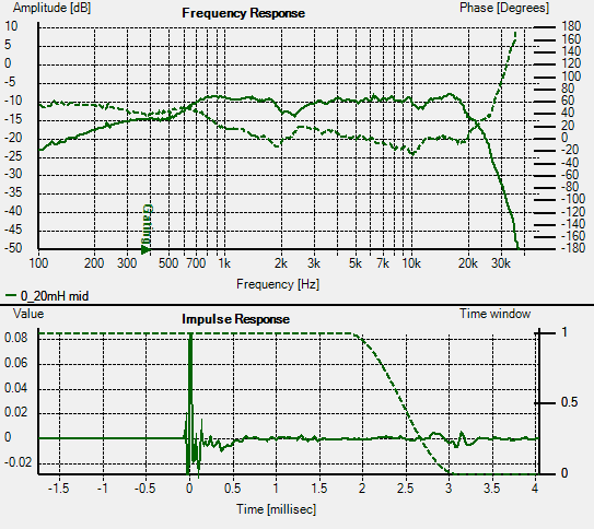

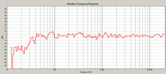

Attached are my speakers and the freq responce. I couldn't find the resp curve where the bass was stiched in but this will do.

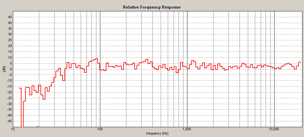

Nice woodwork. You must have gated in a big enough space for the marker being low. Do you have RTA room response? Does it hold like with gated? That 2-3k dip, does it fill out after power response in room mixes?
Actually that response curve is prior to the final itteration of the crossover. I cannot find my measurement data of the final version😕 That file has alot of measurements that I want to keep. Although I still have a dip, it is <<3dB today. This set-up is "temporary" as I desire to at least biamp the system. I am looking forward to SY and Pete's xover.🙂
I haven't checked room response yet as I had to compromise on the system's location to obtain family approval. I am sure the standing waves are dismal.

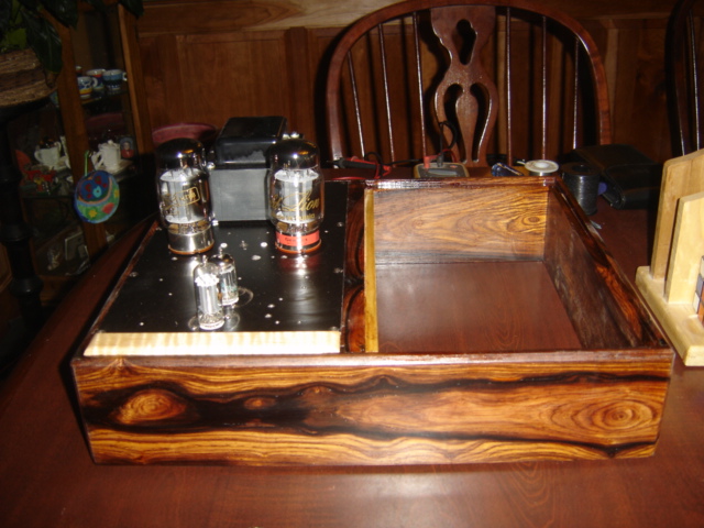

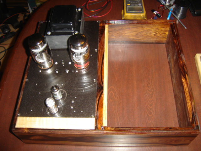

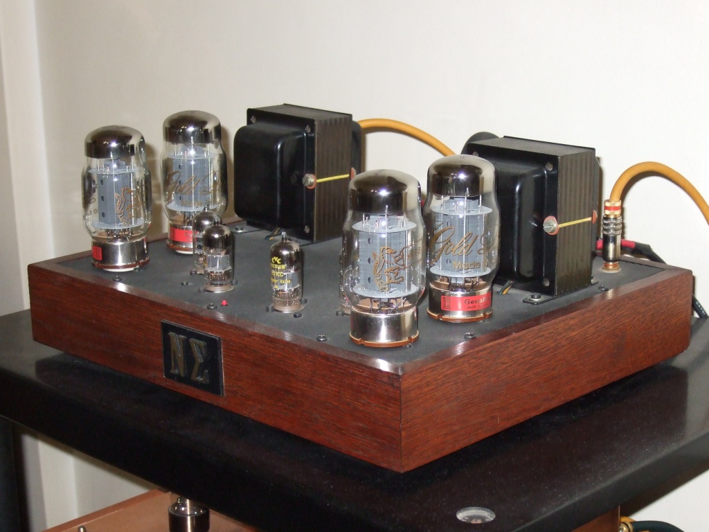

Okay, The weather was just TOO nice today. I couldn;t stay inside and measure, that will have to wait till it rains later. Finally de-winterized my woodshop and got to play with some tools. As a good warm-up I built the two chassis for the amps. The open bay is for the power supply plate. The finish is just seal coat shellac right now. Needs a few more coats, sanding, and then lacquer.
The joints are blind dove tails, with the white strip to be the home of the name plate. Enjoy

It will end up very classy. I would prefer same height novals, the 12BH7 sticks out when so near to the T7.
Your perception is similar to mine in regard to the 12bh7. The design was a function of maintaining symmetry and keeping signal path as short as possible. While trying not to violate MJ's construction suggestions too badly...
The 5867 tube is the same size, but that will go in later.
