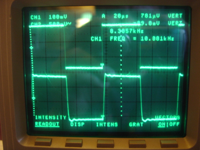

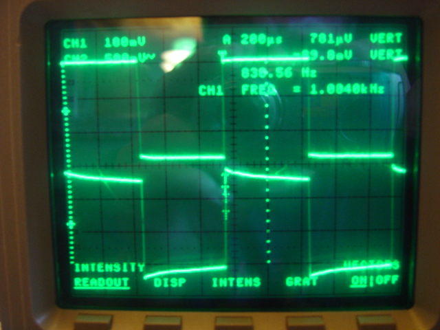

Okay time for an update. I am still running the 12bh7. My hiss is from my preamp and I will have to deal with that seperatly. I have the 6CG7 and 5687 in hand now but will hold off based on the measurements I have so far. My audio work has to slow down now that it is starting to warm up outside so I can finish my wife's kitchen cabinets. Oh Well.
I have finally recieved my scope and function generator which has made a world of difference.
The amp puts out 65.3Watts before clip. freq range is between 20Hz f3 and >100kHz. No phase issues.
For feedback, I have used 1.47k for the resistor and 680pF for the cap. I started at 10pF and kept going till the square wave stabilized. 1000pF was too much. Attached are the photo of the square waves at both 1kHz and 10kHz with 680pF. THD is <0.5% at 30W with a nice cascade of the harmonics. 2nd being the highest.
Now to fire up the second channel.!!! and build a chassis for them.

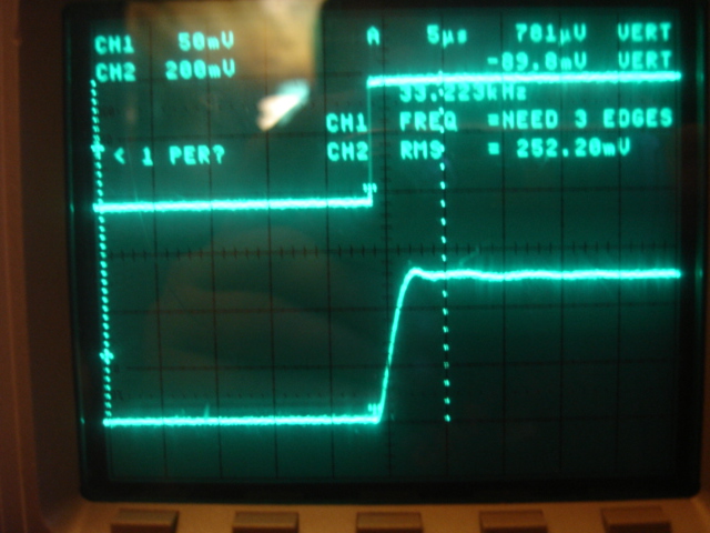

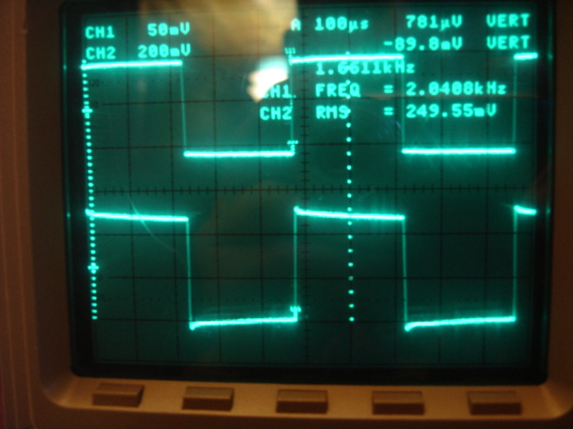

Okay here it is at 2kHz. I decreased the time scale to focus on the leading edge of the square wave and am wondering what I can do to make it better. What am I looking for? Any more capacitance and it rounds over, any less and it shows ringing.
Ignore the 33.2kHz on the display, that is related to the cursors window. (I havn't figured out yet how to turn it off!!!!)
I took the measurement at 1.25 Watts power using a 10x probe. edge doesn't change at higher or lower power.
Better a bit of a knee than a bit of an edge. You will be surprised of how audible compensation adjustment is. I use 2x360=720p Silver Mica on 1k2 on my KT88PP, many different things and parts but interestingly where about you move.🙂 Did you try 10kHz square waves? I mainly tune there and usually lower frequency does better too. What type are the Cdom Rf caps right now?
