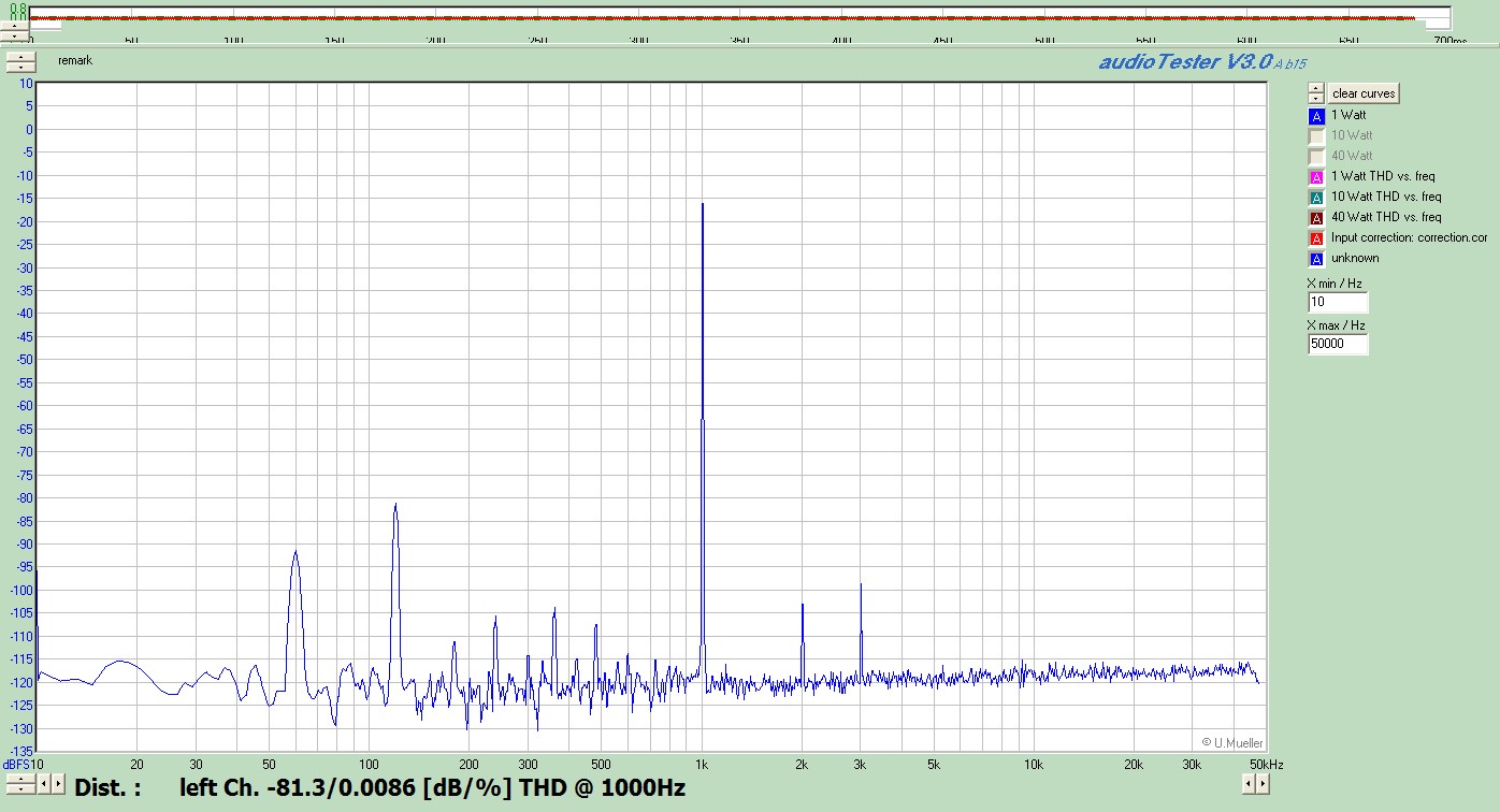

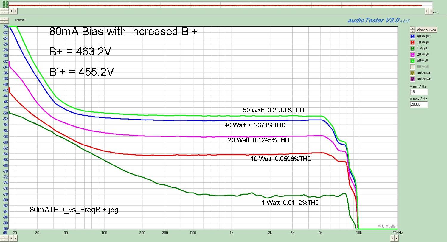

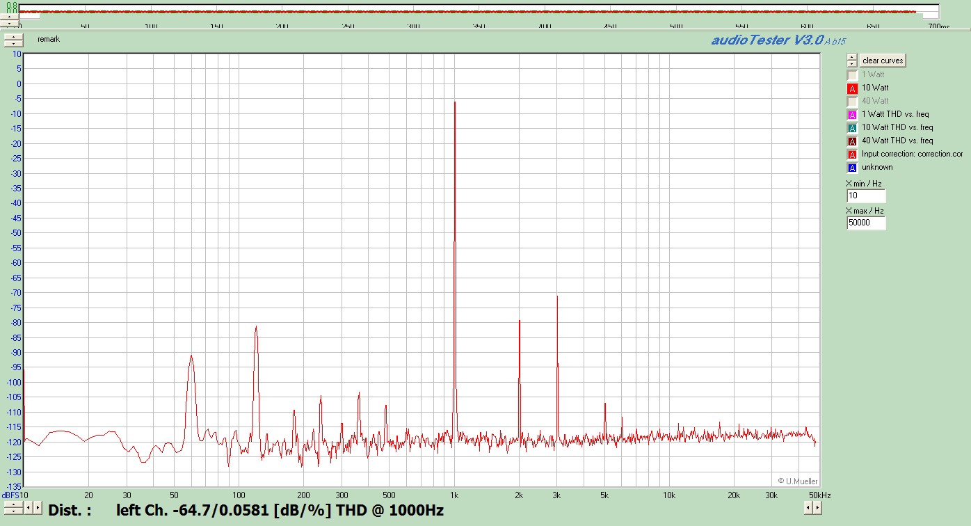

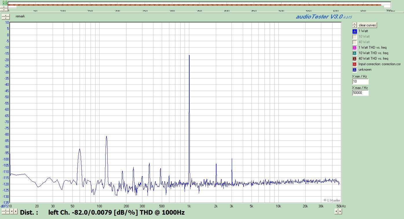

Here is the supporting spectrum of the above plots. This one at 80mA KT88 bias. Spectrum are at 1kHz, 50Watt = 0dB. FFT are respectfully 1 Watt, 10 Watt, and 40 Watt.

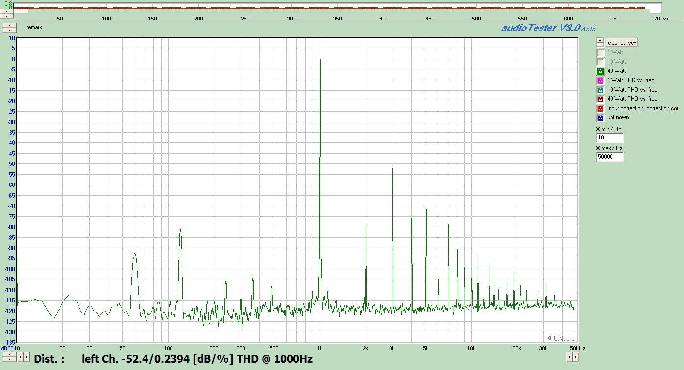

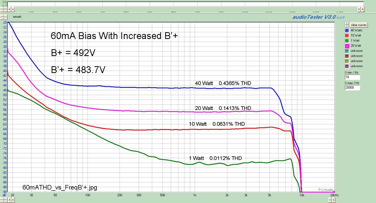

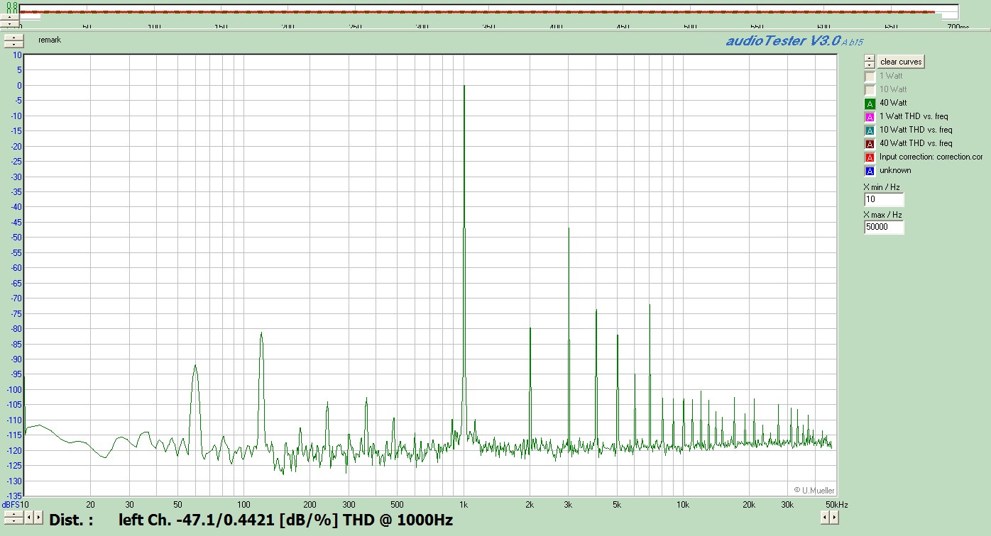

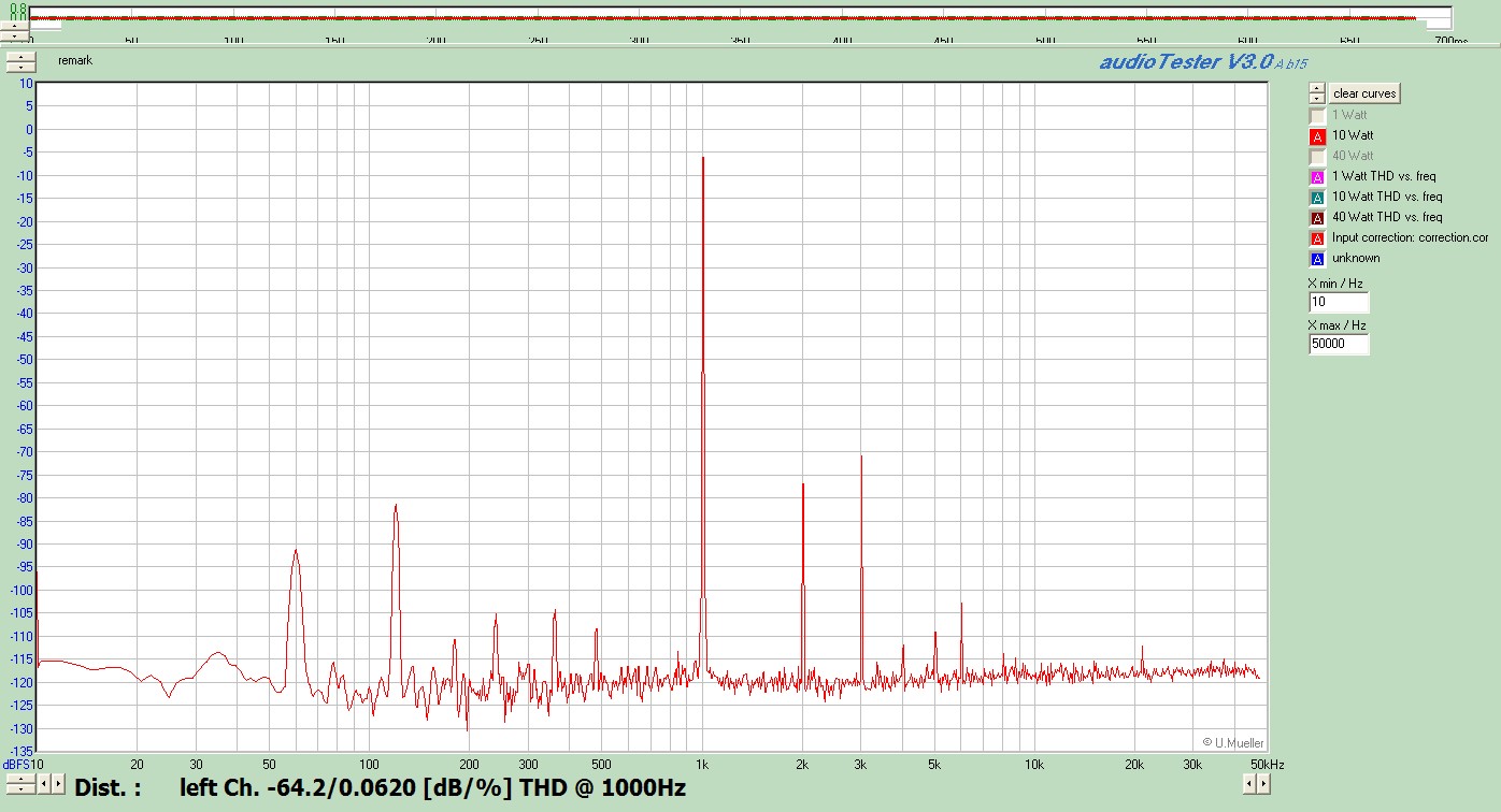

Here is the same measurements taken at 60mA bias. Same scale and power settings as above.
I keep the amp set at 70mA for general listening as it takes a load off of the PT and puts a little less stress on the tubes.
