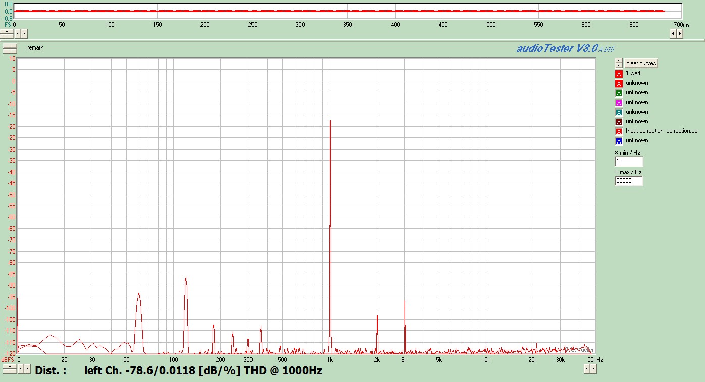

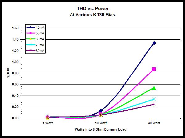

Need some help on high Power THD.

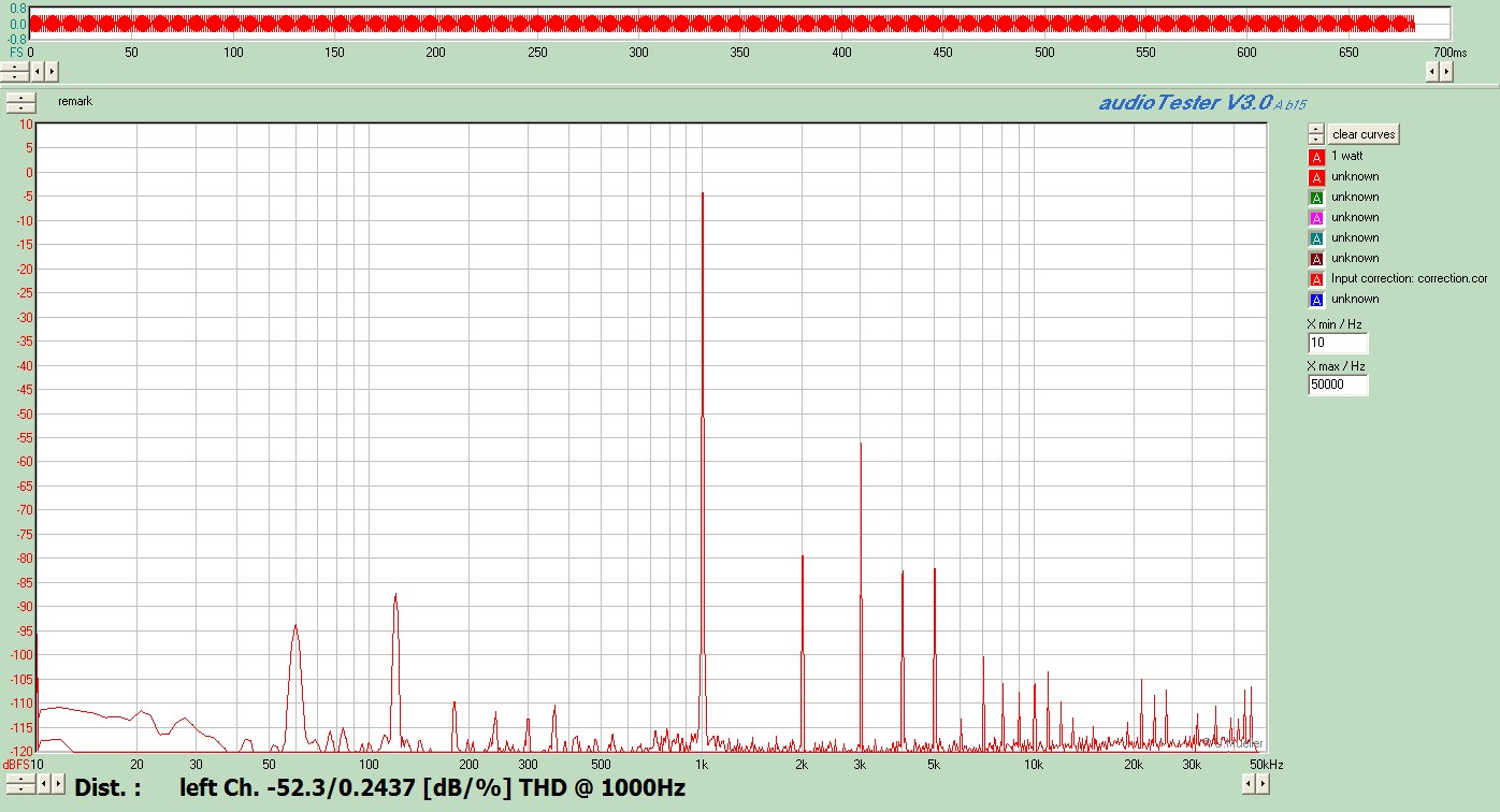

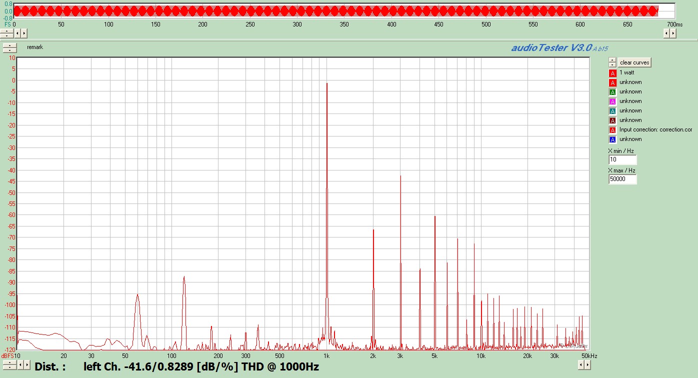

Okay did some measurements at high power levels. While I know that distortion typically increases with power for a given amp, I really don't have any idea how that spectrum "SHOULD" look like. Here is the spectrum of a 1 khz tone at 1Watt, 10 Watts, 20 Watts, and 40 Watts. Is this normal? It seems to me that there is WAY too much higher order harmonics. What can be done to reduce this?
Raising the FET bias to 15mA reduced the THD at 40W down to 0.7368% (not shown due to me not saving the file) The lowest 40Watt THD was 0.6512% at 70mA bias.
Also with the stronger negative rail, the amp will sustain 65W at around 1.1% thd. Dynamic headroom is quite a bit higher but don;t have a consistant way to measure it. I saw 76Watts but I think it is higher. I have to figure out how to get my scope to capture it.

I'm not the expert on all this, but I suspect that the stronger negative rail is allowing the CCS to work better.
As far as the distortion of your amp, is the sound disagreeable to you? If not, I would not be too concerned about the "numbers". However, I can say that as long as the total amount of distortion is kept reasonable, the profile becomes more important than the actual amount of distortion. The things that I have done in the past to reduce higher order, and odd order distortion is lower the load seen by the output tubes, and used a resistive load on the first gain stage to promote more even order distortion. I'm not saying "Let's add lots of even order distortion" here, I'm just saying I want the evens to dominate the distortion profile.

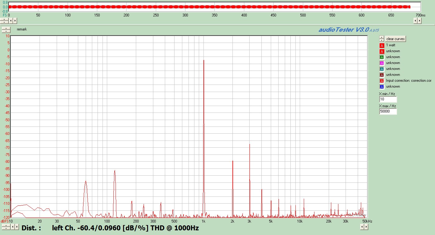

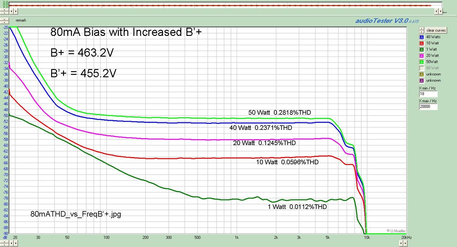

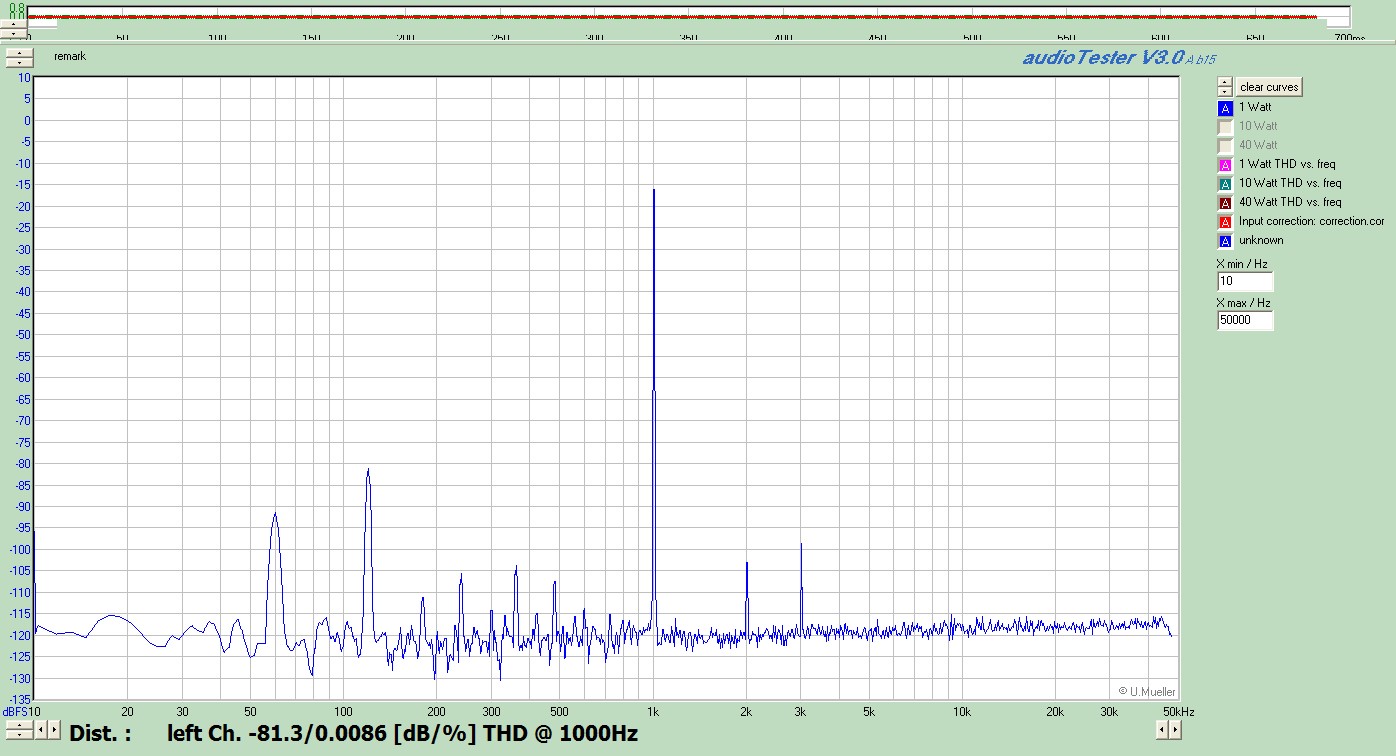

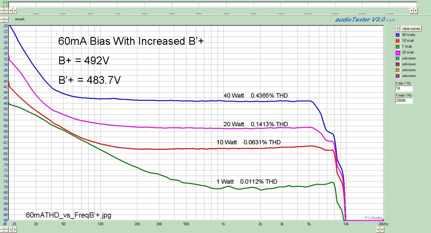

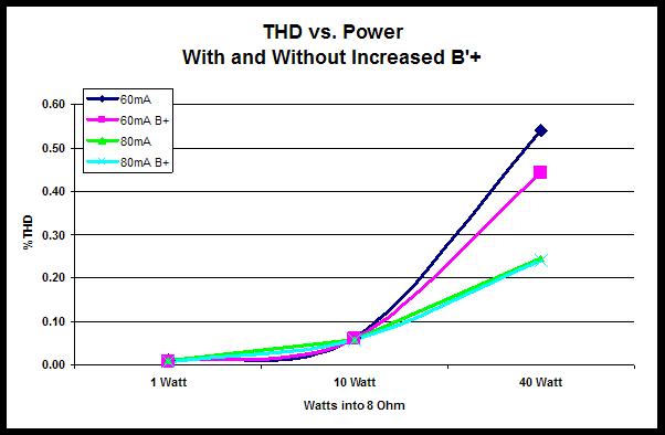

Bit of an update and some good information to share. I have taken quite a few measurements and tried different configurations. I have left the feedback at around 7-8dB. I'll try to summarrize them here.
Smaller Caps did not measure any different and with only a short listening session, found a little wanting in strong Bass area in comparison to the monster caps. I was expecting the smaller caps to be a little more nimble sounding compared to the monsters, but did not notice any difference. I think alot of the has to do with the heavy bypassing with 100uF and smaller film types across the monsters. The smaller caps are quite acceptable however and would have no issues putting them in another build.
The amp is currently running with a 5687 input tube at 10.8 mA bias. I have also regulated the input tube B''+ to 150V prior to the CCS using a OD3. Still looking at a compact way to regulate the B'+ the LTP. The verdict is still out on the 5687 vs. the 12bh7. They both sound good but at the same time different. The 12bh7 is seems quicker and significantly more precise. The sound stage is very specific and stable, while the 5687 is a little more laid back with a much stronger and LF. The sound stage is wider with the 5687 but just not as pinpoint. Both are listenable without fatigue.
I know my next opinion will offend some people, but I don't usually believe in burn in. I think in some cases it is rational and explainable but only for a short period. In this case the 5687 certainly has some extended burn-in and seems to be continuing to do so slightly. I could actually see it in the square wave behaviour over the first couple of days. The sound however is starting to develop more precision.
The best THD measure now is 0.0086% 1kHz @ 1Watt 50W = 0dB. Seen in the first graph. For this I maxed out the VA rating of the PT at 80mA bias while reducing the voltage drop between B+ and B'+. The LTP certainly liked the voltage by giving improved THD. The second graph shows THD vs. Frequency at various power levels. I did the same for 60mA bias.
The KT88's definatley like the higher bias currents as it seemed to minimize crossover distortion at high power levels. In the third plot, I summarized the THD performance at various power levels and KT88 bias.
The final graph shows the impact of increasing the voltage to the LTP. Most pronounced at 60mA but I feel that is the result the voltage over 480V. I will need a stronger PT to realize the same improvements at 80mA bias.
