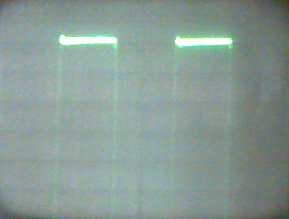

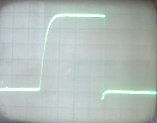

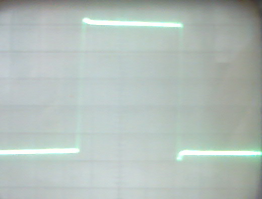

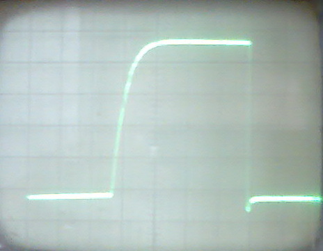

Measurements taken before without modulator sch. Only power stage, 250 kHz clock 50% and deadtime generator with logic gates HCT series with value shown in my sch (post 3)

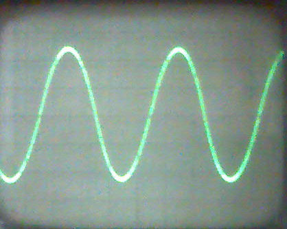

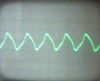

Here is my measurements on closed feedback loop (with LM319 comparator, feedback after the filter)

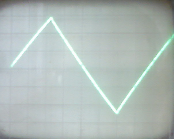

Triangle generator (1v/0.5us):
