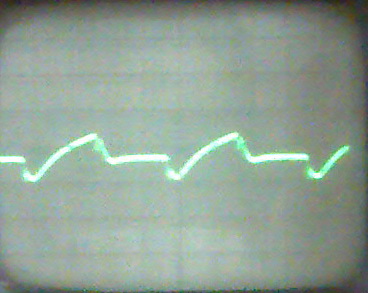

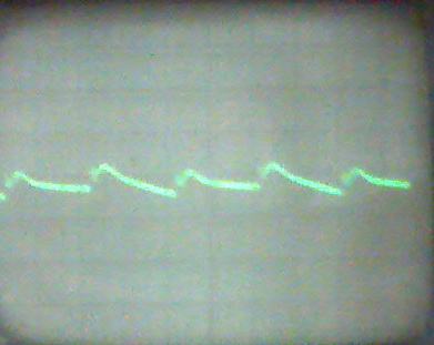

The triangle is huge with +/-2.5V.
So you modulator is probaly quite forgiving.
As reference: In my breadboard proto the comparator output has less than 5ns jitter with +/-340mV input triangle, nevertheless I can hear noise when I go about 15cm close to the tweeter.
I would not expect your comparator/modulator to be the noise source, but you never know...
To search the jitter you need to look the ns-range.
Witch 0.5us/grid even a heavily jittered edge will still look like a sharp edge.
But how about 50ns/grid?
Again my proposal:
Use chanel 1 to watch and trigger to the comparator output. Use chanel 2 to watch any other point in the circuit at the same time. With this you can easily watch down to several tens of ns. Furtheron this will give you
a detailed information about your propagation delays.

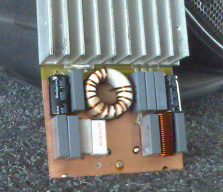

I use 6N137 with TC4429 for many years without probleme, even with 74A 200V APT devices...But large dead time before 6N137, done with GAL device ( some logic are done before too...).. Maybe look at your output coil, try some Sendust or -2 from micro metal...Or it's just supply contamination trought the ground. Change the orientation of output coil too...
