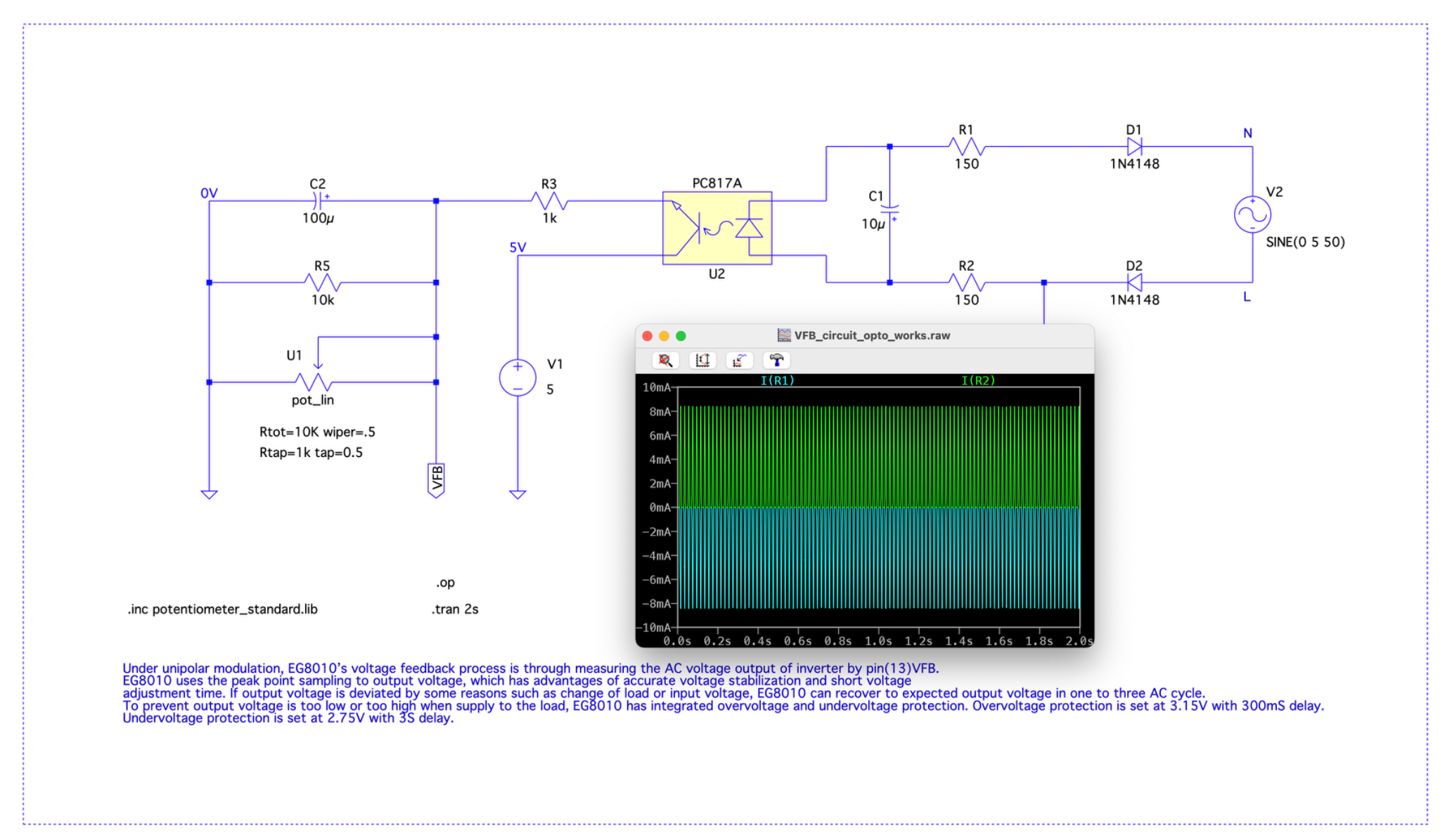

Hello,
I am working on a circuit that must measure a low AC voltage (between 5V rms and 10V rms) and generate a voltage for the AC feedback circuit (nominal value of 3V).
I am looking for help to choose the right optocoupler for this use.
I simulated with a PC817A and it seems to work but I find that the resistors R1 and R2 are too low.
Stef.
EDIT: The thread title is wrong. Read "measure" instead of detection.

I might have misunderstood your question. You want to detect a 5-10 mV AC voltage with an optocoupler? That is not possible, the diodes and optocoupler have a voltage drop of 0.6V and 1.2 each.
Also "low voltage AC current" is confusing.
On the input side you only need 1 diode. That is important for the voltage drop.
The minimum AC voltage is 5V RMS. That is 7V peak. Since you use a capacitor to filter the pulsating voltage you can use that.
Voltage drop of 1N4148 = 0.7V
Voltage drop of PC817 = 1.4V max
Remaining voltage = 4.9V
Nominal current thru opto coupler diode: 5 mA.
One series resistor of 1k is good. Or 910 ohm if you have if.
The maximum allowed current thru the opto diode is 50 mA. So 10V RMS is also allowed.

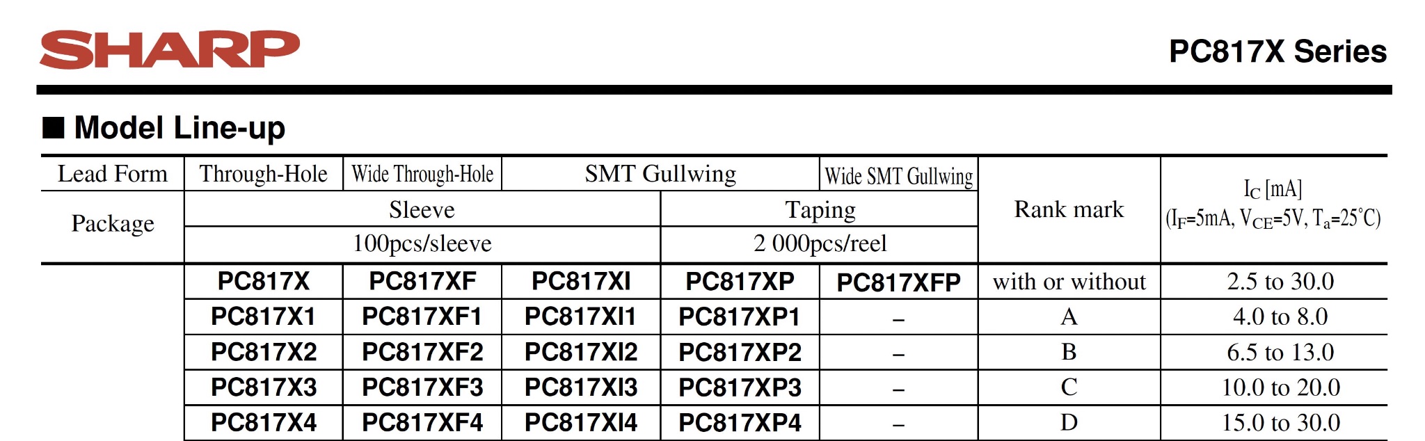

Current transfer is 50% minimum. So opto transistor current will be 2.4 mA minimum.
I don't know what your output requirements are.
But you have to design it with this 2.4 mA min in mind.
It is custom to connect the emitter to ground and have a collector resistor.
Which means a low output when input current is present. I don't know if that is applicable for you.
C1 filters the rectified voltage. For sine waves, the peak value is 1.4x the average value.
So instead of 5V minimum voltage at the input you can use 5 x 1.4V = 7V to calculate
the value of your series resistor.
Usually you want a smooth DC voltage. not a pulsating half-wave rectified sine.
The opto coupler would also have a interrupted signal out the output.
Usually D2 is put in series with R2. Like your previous schematic. But this will also work.
On the output it seems you have a 5V supply. But your digital input is 3.3V? is that the reason for VR1 and R5?
Either use the 3.3V supply for the transistor in the opto coupler, or use a clamping diode from the collector to the 3.3V supply. Or don't you have access to the 3.3V supply?

With the optocoupler you'll run into an issue where you might get the circuit to work well, once. Then build it again with an optocoupler from a different batch and you'll have to re-tweak the component values because of the difference in current transfer ratio.

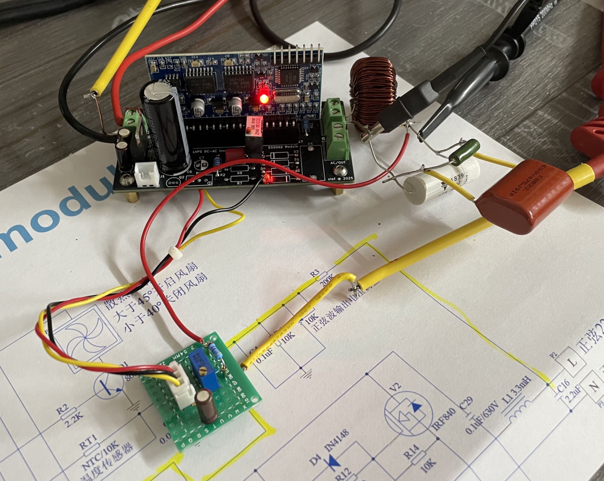

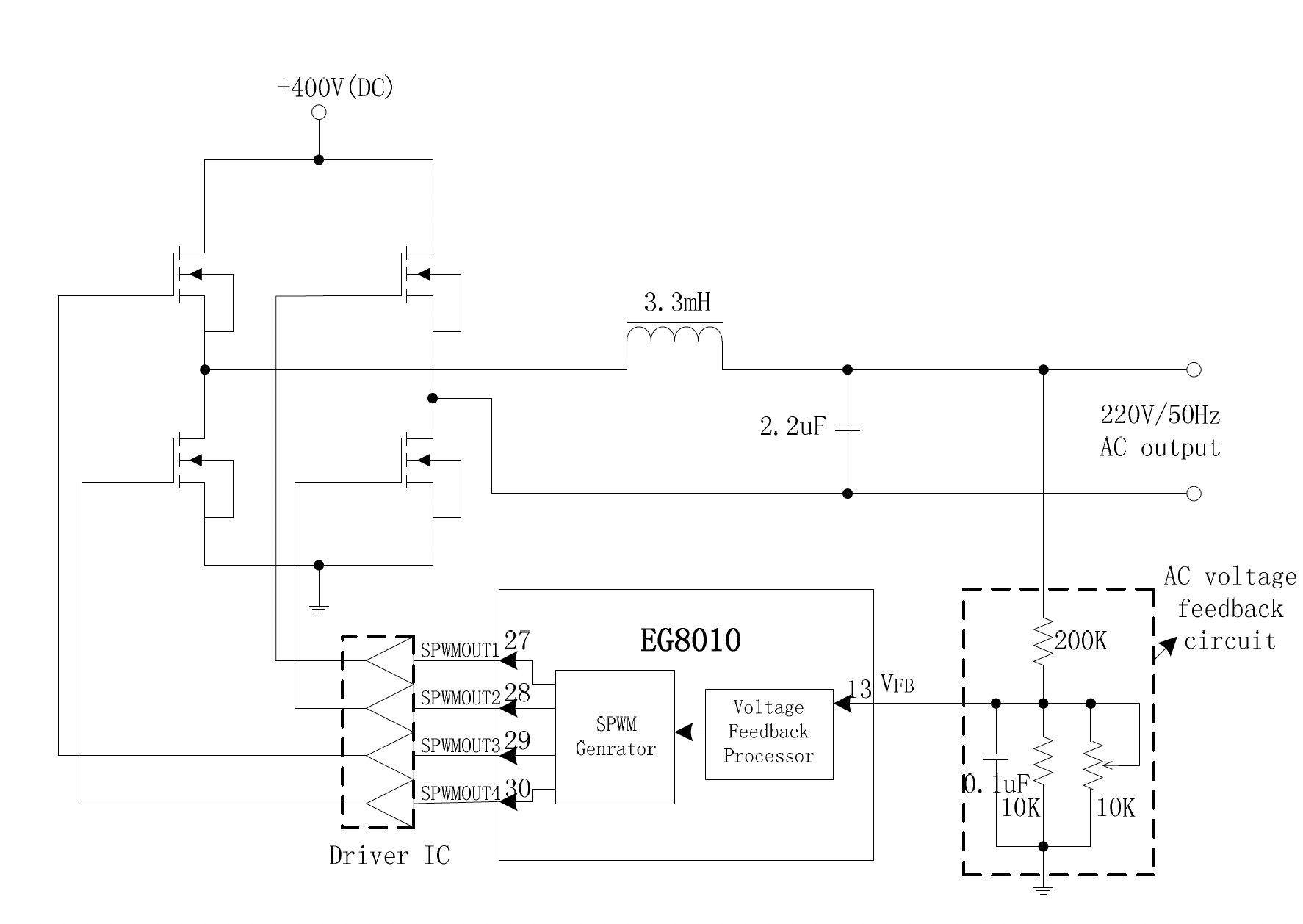

The goal is to isolate the AC voltage from the EG8010 ASIC. There's some 23KHz hanging around and I would prefer to physically isolate them.

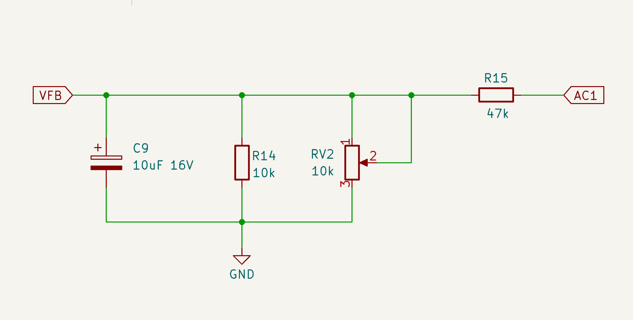

Otherwise, I'm currently using this simple circuit that works in the first diagram.
The second diagram comes from the datasheet. I modified the circuit to work between 5-10V and I would like to see if passing the AC feedback to the optocoupler would be useful.
In the AC feedback processor.
Overvoltage protection is set at 3.15V.
Undervoltage protection is set at 2.75V.

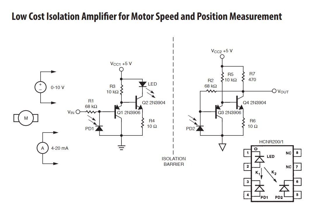

No, then the whole setup is wrong. You actually want to measure the voltage. Not detect whether it is present. It seems that you need to stabilize the output voltage and use a feedback.
The optocoupler will provide an on/off detection. That is what you wrote in your original post, that you needed a detection.
If you need a opto isolated feedback, you usually do that with a PWM modulated signal thru the opto coupler. At can be done analog as well, but then you need to linearize the opto isolation circuit. It can be done with an opamp and a second opto coupler. But it not trivial.
Besides, you have to be very careful with the time constants in the feedback circuit. Time constants in the same order of magnitude or greater as the time constant in the feed forward signal will cause instability.
Best is to look up an application to measure a voltage thru an opto isolator.
Besides, maybe you don't need galvanic isolation at all. This is for a 220V inverter. Since the secondary is not connected to earth, you won't get a shock when you touch one of the lines of the 220V circuit. That doesn't mean you don't have to be careful, touching both lines with both hands and this might have been your last post.
But the measurement circuit as drawn is fine for feedback. If you connect one of the output lines to ground, the 220V output is dangerous again.
avago / broadcom has an interesting design guide for all sorts of linear optocoupler applications. they have a linear coupler for normally used for motor current sensing . I have used it for voltage sensing. HCPL7800 series. also with an IL200 a low cost method of linear isolation can be achieved.
Hello,
I updated the first post in the topic to make this clearer. I couldn't update the topic title though (measure instead of detect). I also updated the LTSPice file.
The HCPL7800 is interesting but the chip is too expensive and the circuit around it takes too many components. I don't have the space on the PCB (no SMD use).

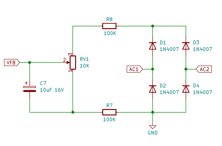

Not sure if this is relevant, but I have used something like this for years. You just have to scale resistances accordingly for the levels you need.
Thanks.
I have already tried a circuit of the same style. It works but does not provide any advantage over the basic circuit in direct connection with just a resistor. The circuit is useful if a transformer is used to convert the output voltage (up or down).
