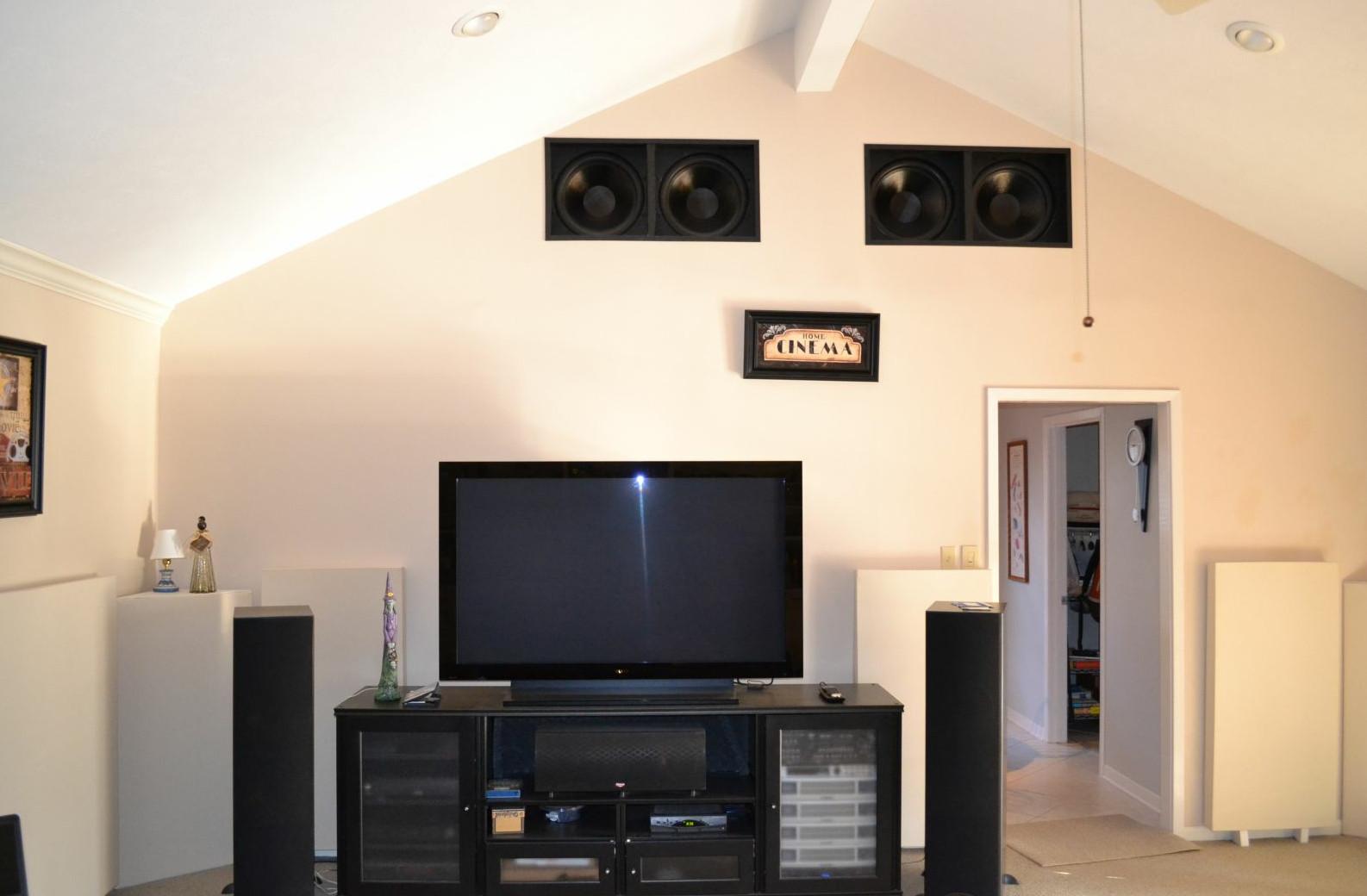

Yes, HR has an H frame wizard that I've yet to try.
Took a peek and as I suspicioned it's huge to go low with such a high Qt and instead of an 'H' it ideally needs a flat baffle on one side with the 1/2 H 2x larger and opened up till just slightly folded to get the desired 'flat' to 200 Hz+ at high eff., so best to put both drivers on this huge monopole positioned somewhere between the mains hidden behind some weighted drapes to further damp it to 'taste'. :scratch1:
That said, Davor's little two stage pipe tuned a little lower seems a much more viable option.
Not always an option, but...high WAF for high Q.
